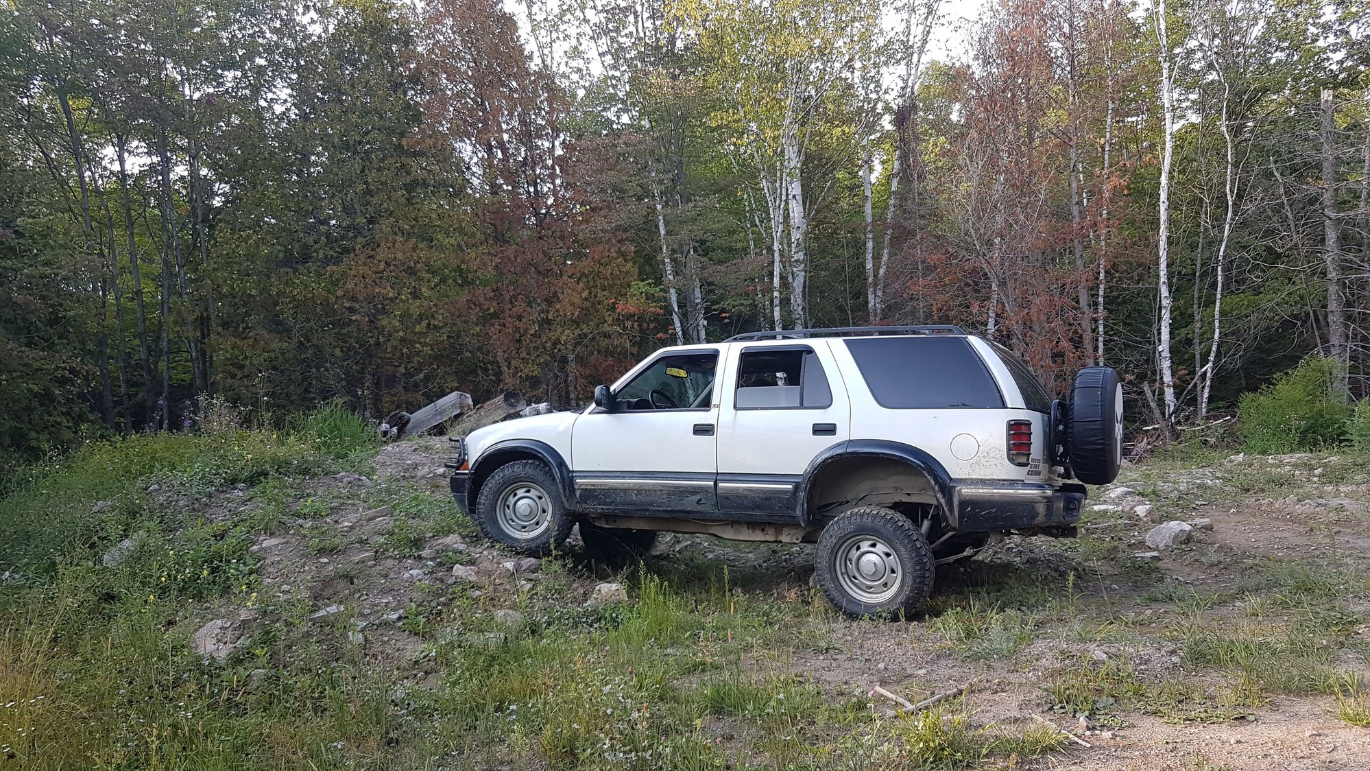

The Goodyear duratrec are a good tire for on and off roading. Wears good and lasts a while... they come in stock size, but measure out a little bigger. Doesnt effect the speedo, and look good. A cheap upgrade for the offset rims are the rims off the 2wd s10/blazer/so on...
I have the same mind set for my build as you(daily driver that can go offroad), and so far Im really eally happy with the outcome... got a build thread that shows the work done, as well as many others.
Any chance you have any photos? I'd love to see your setup.
