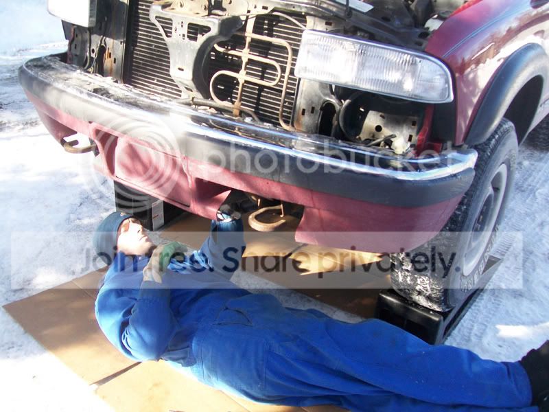

Looks good. Time for new tires, though...

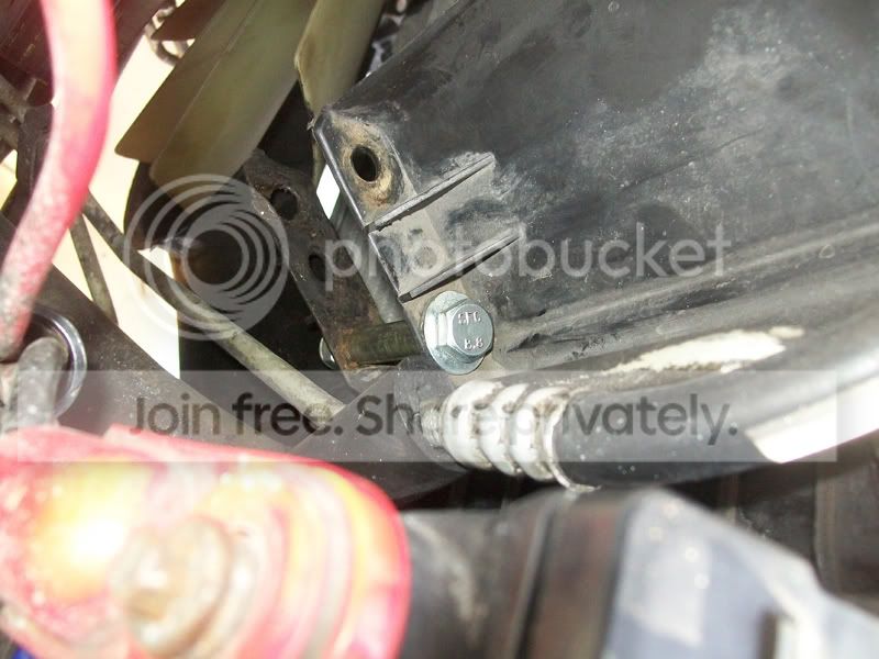

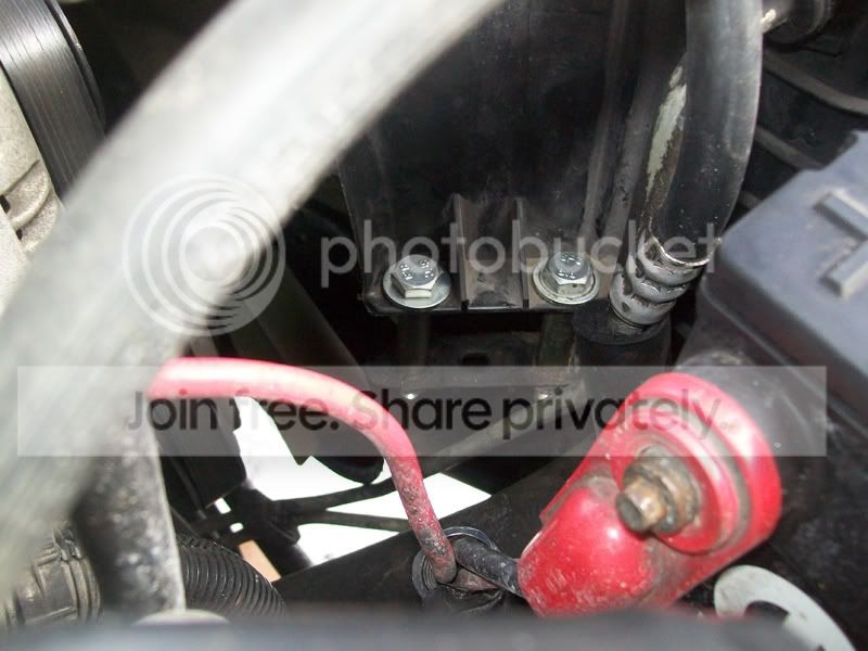

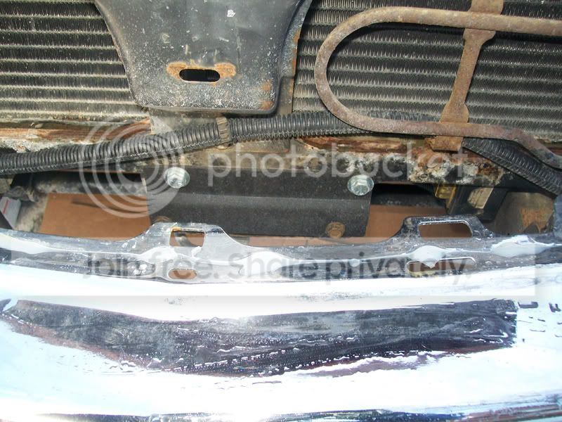

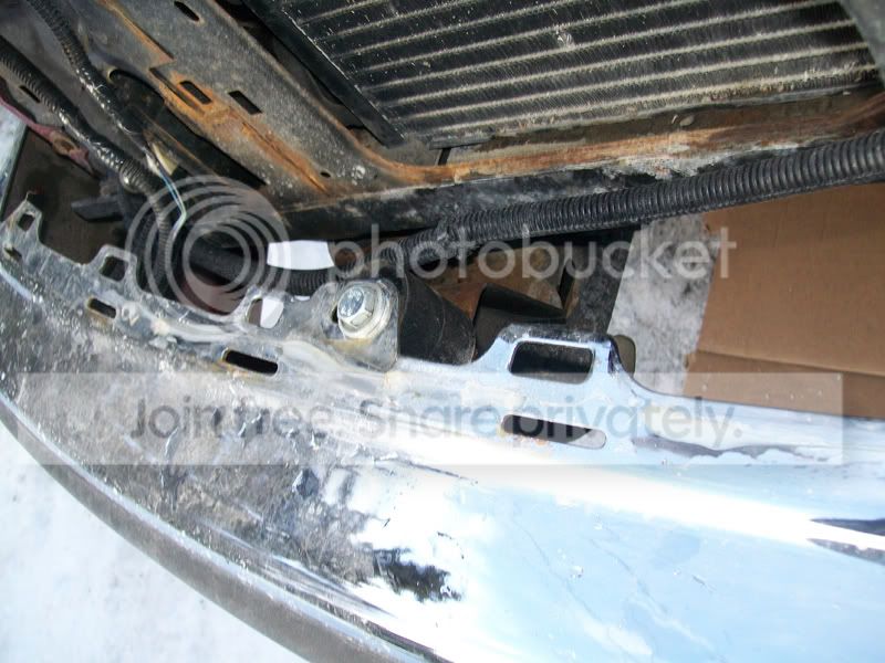

Could you please post a few pics of the front bumper brackets? And a few of the oil filter too?

I lifted my front bumper up with the remaining poly urethane blocks. 2" in diameter unlike the body ones which are 3". They fit perfect to raise the front bumper into the proper place. Used OEM stock brackets for the front bumper. Rear bumper I have no idea how I'm going to mount it, probably have to bring it to a shop and have them weld the brackets up higher or something. I'll post the pictures for you tomorrow. I'm at work and have no camera to do so.
I had to trim the bumper by the tow hooks for it to fit properly.

Theres not much to the oil filter brackets at all, just two plates with holes in them, just so that the lines don't have to swing all the way up to the frame instead they meet the brackets first.

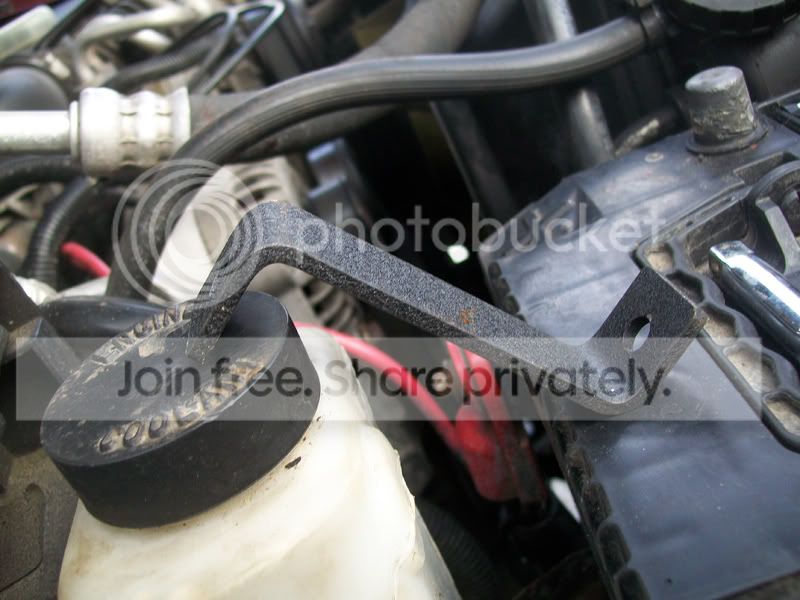

Last picture is the bracket for the bottom of the fan shroud, and I need oil filter lines..
