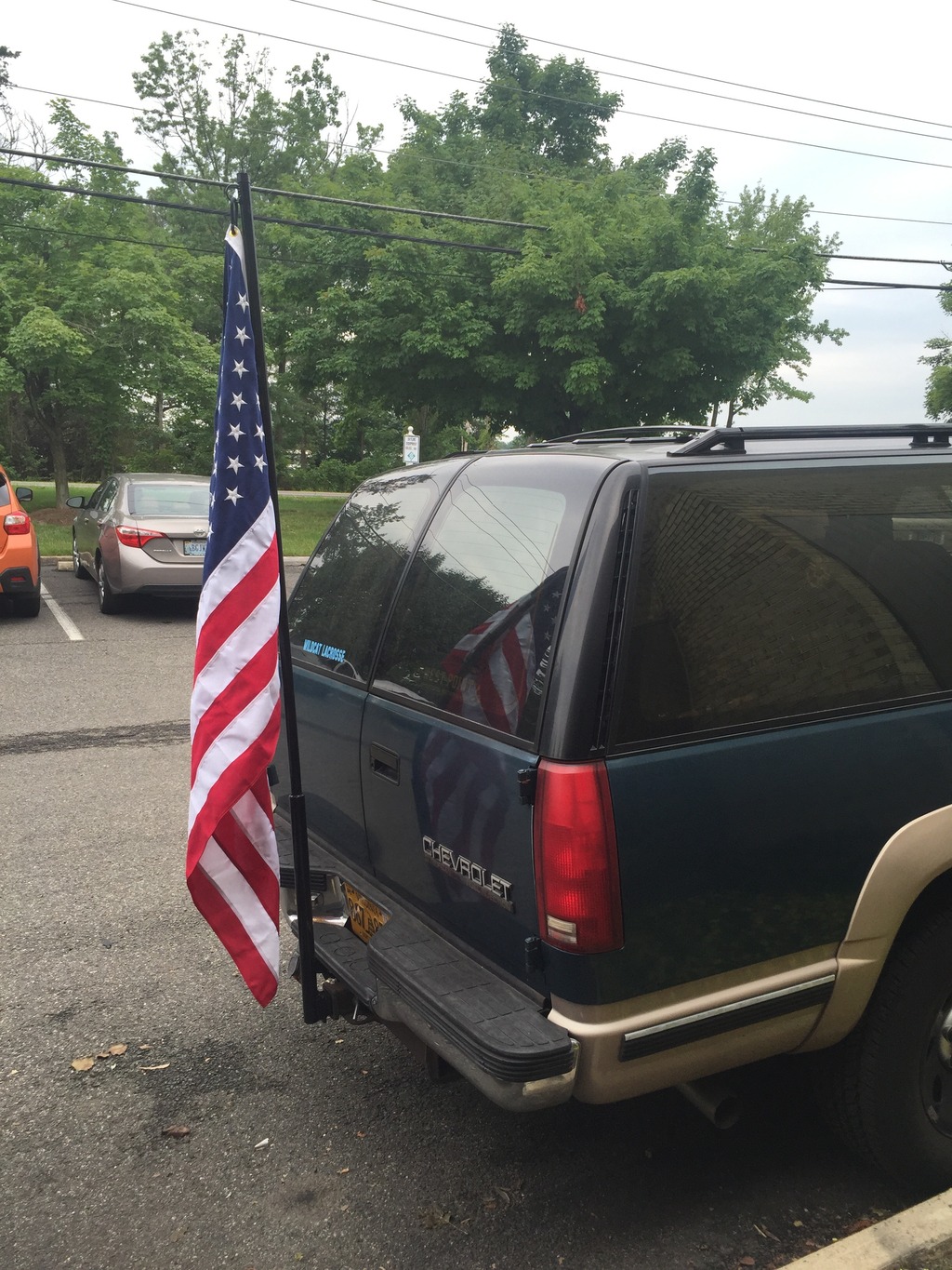

Oh and I built a flag pole to fly my flag for the 4th It looks bent in the pic but its an optical illusion lol its straight I promise!

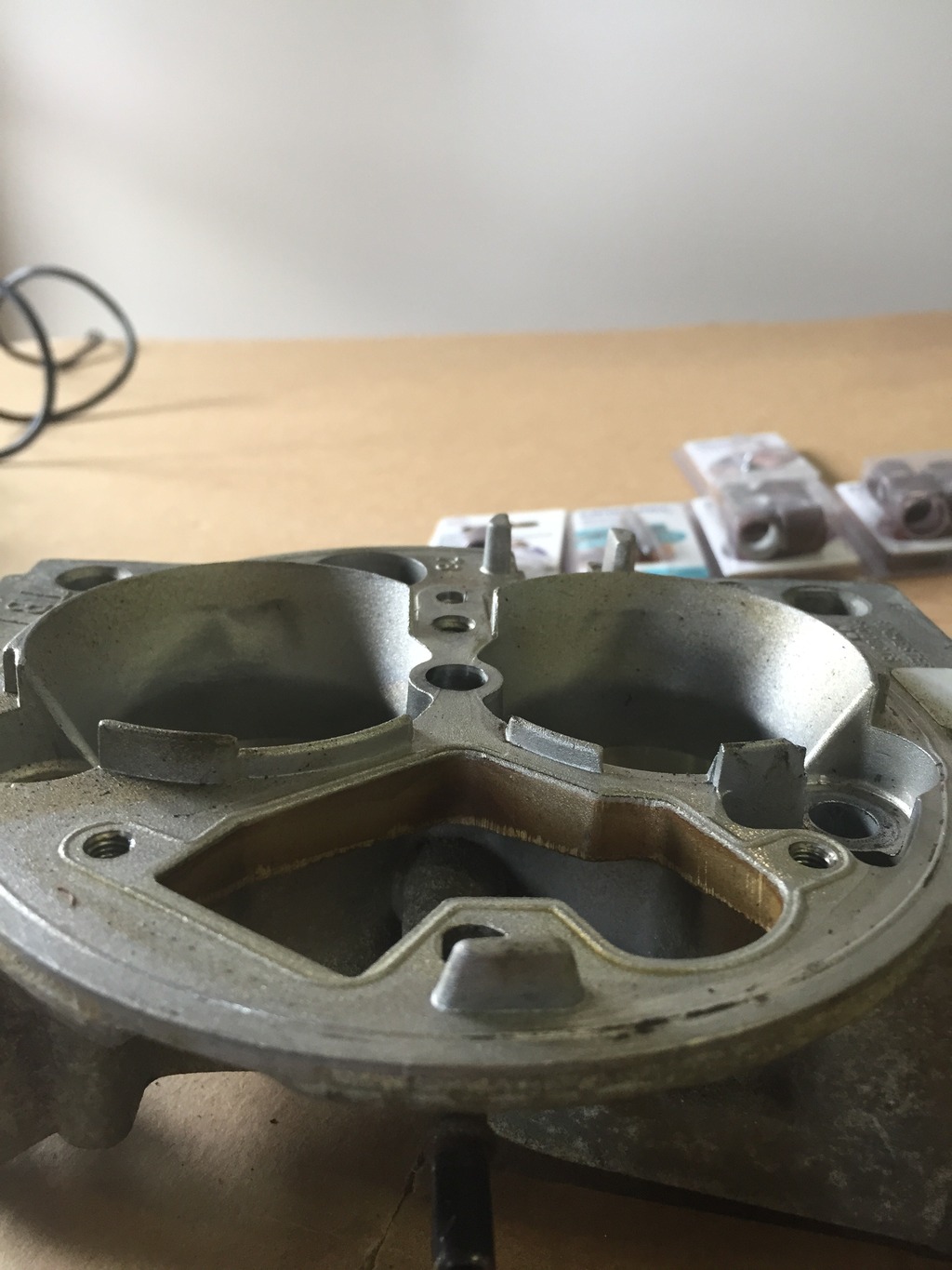

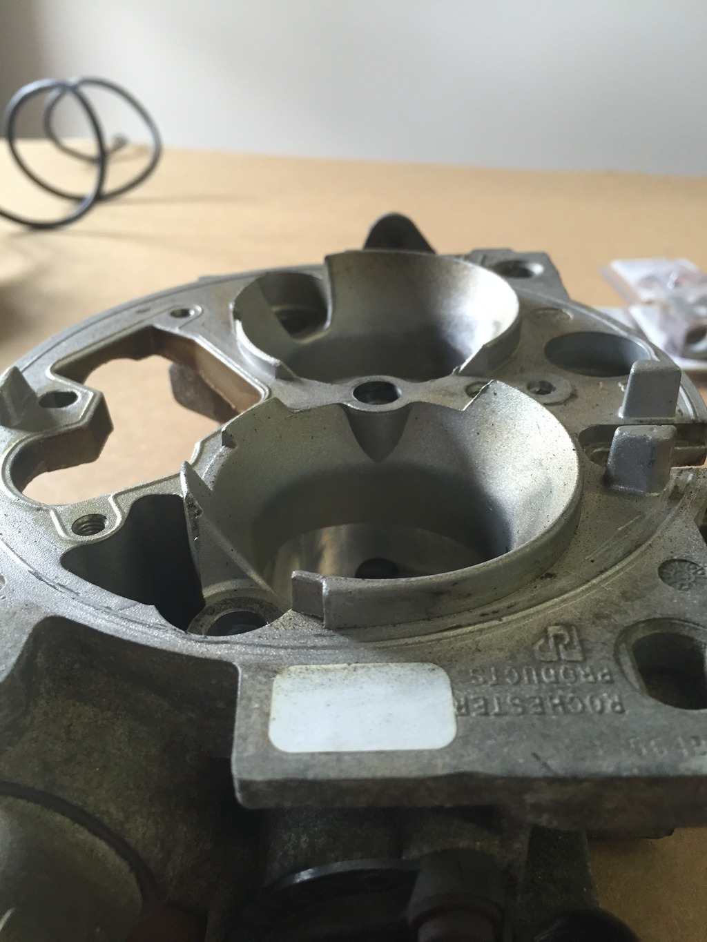

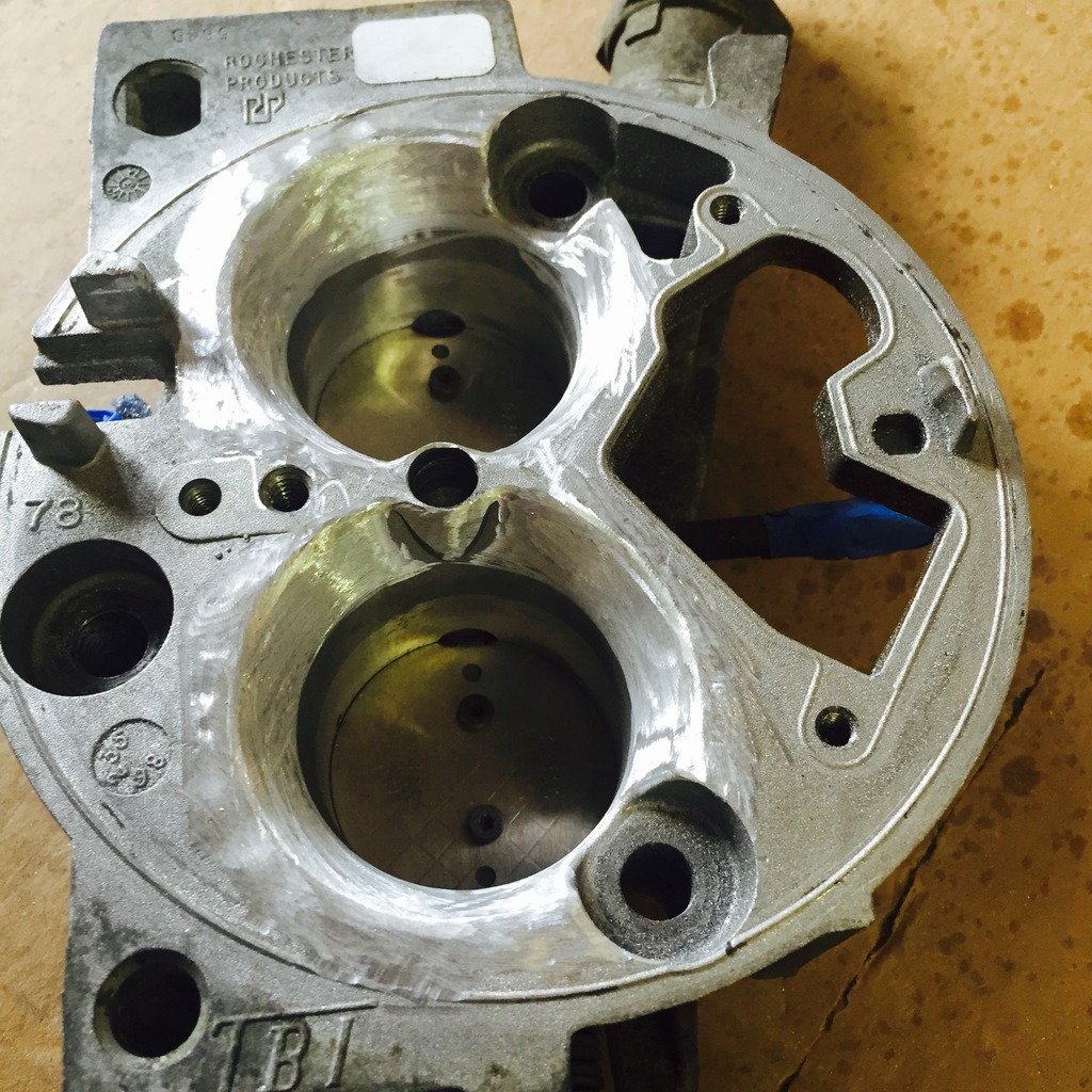

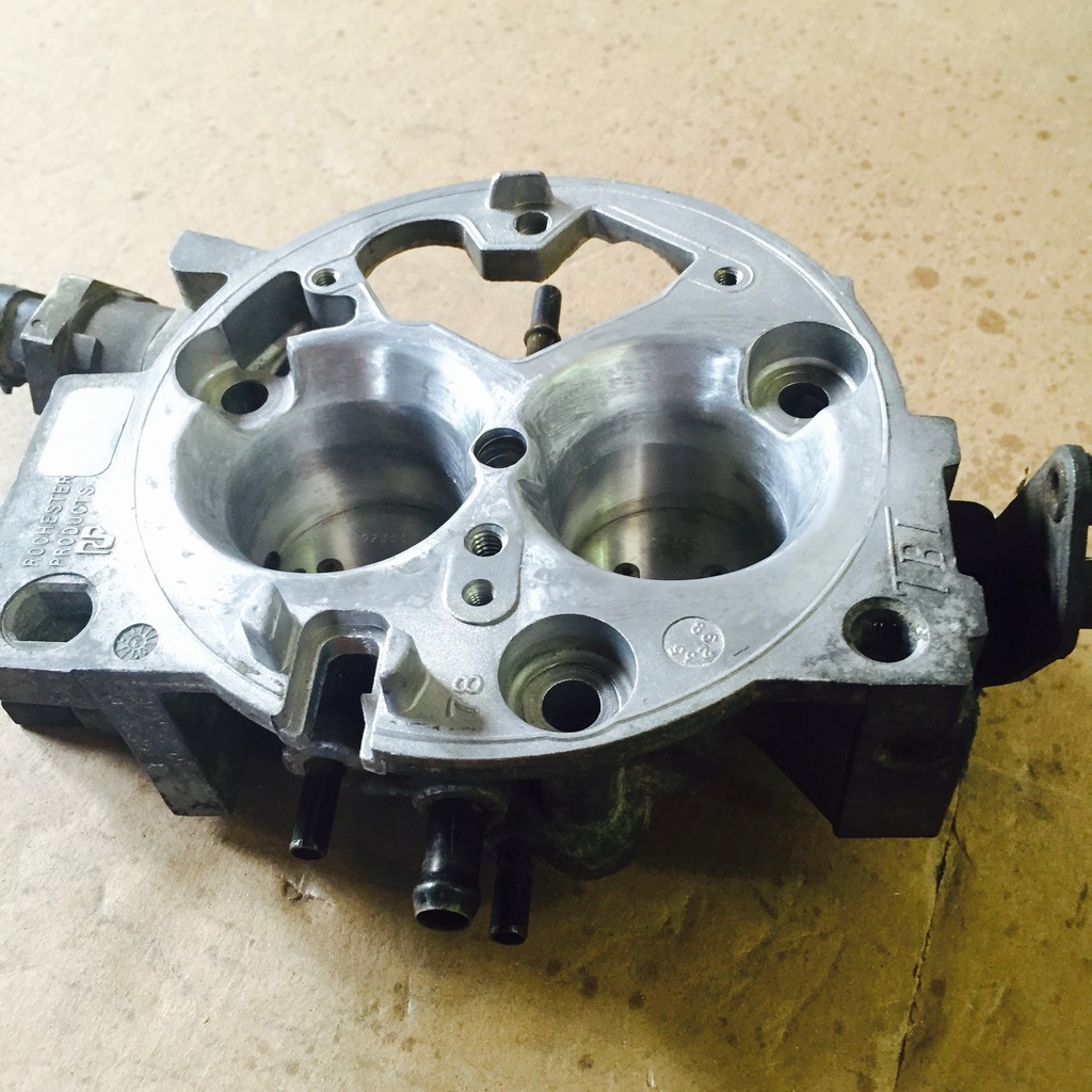

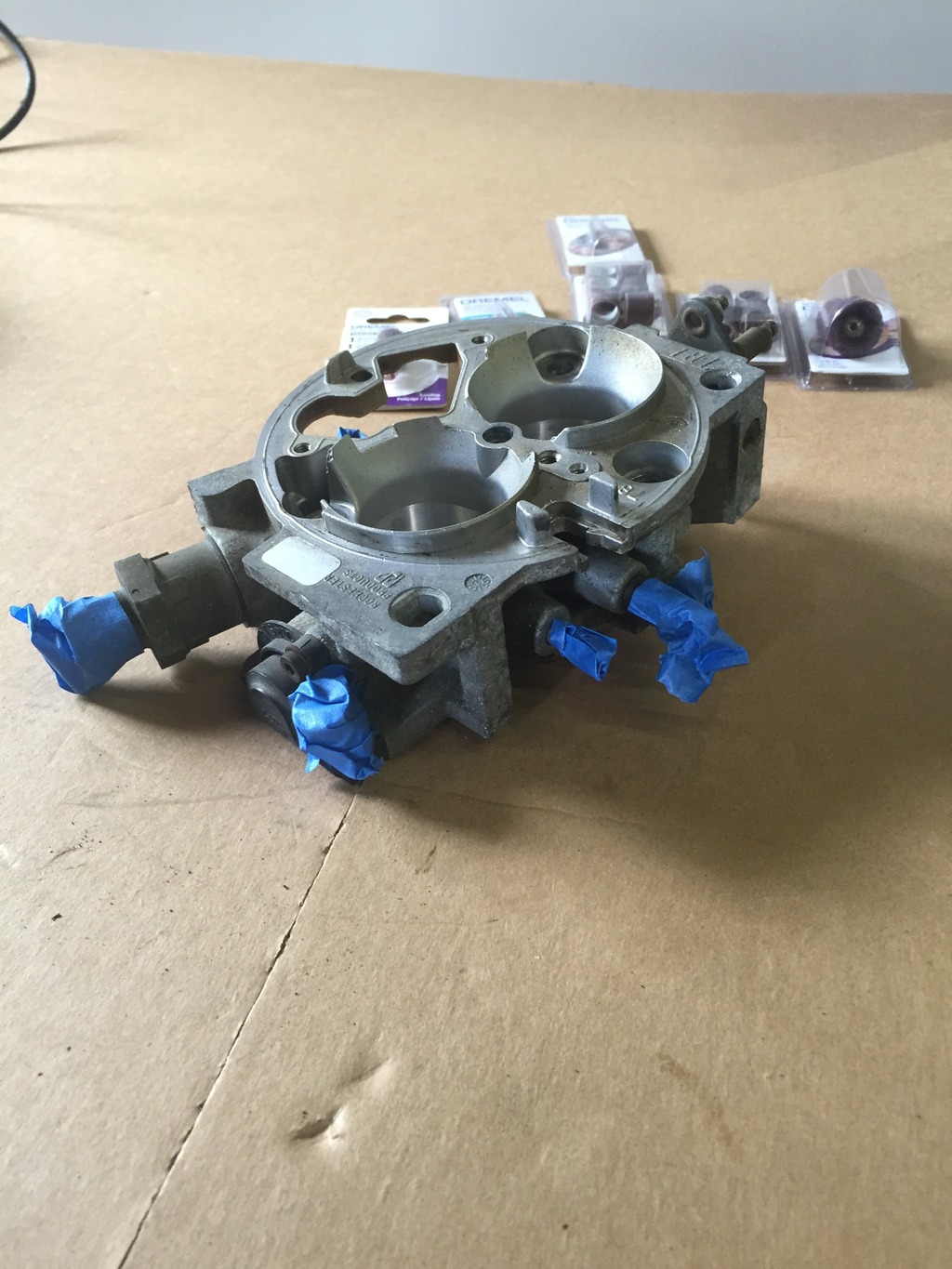

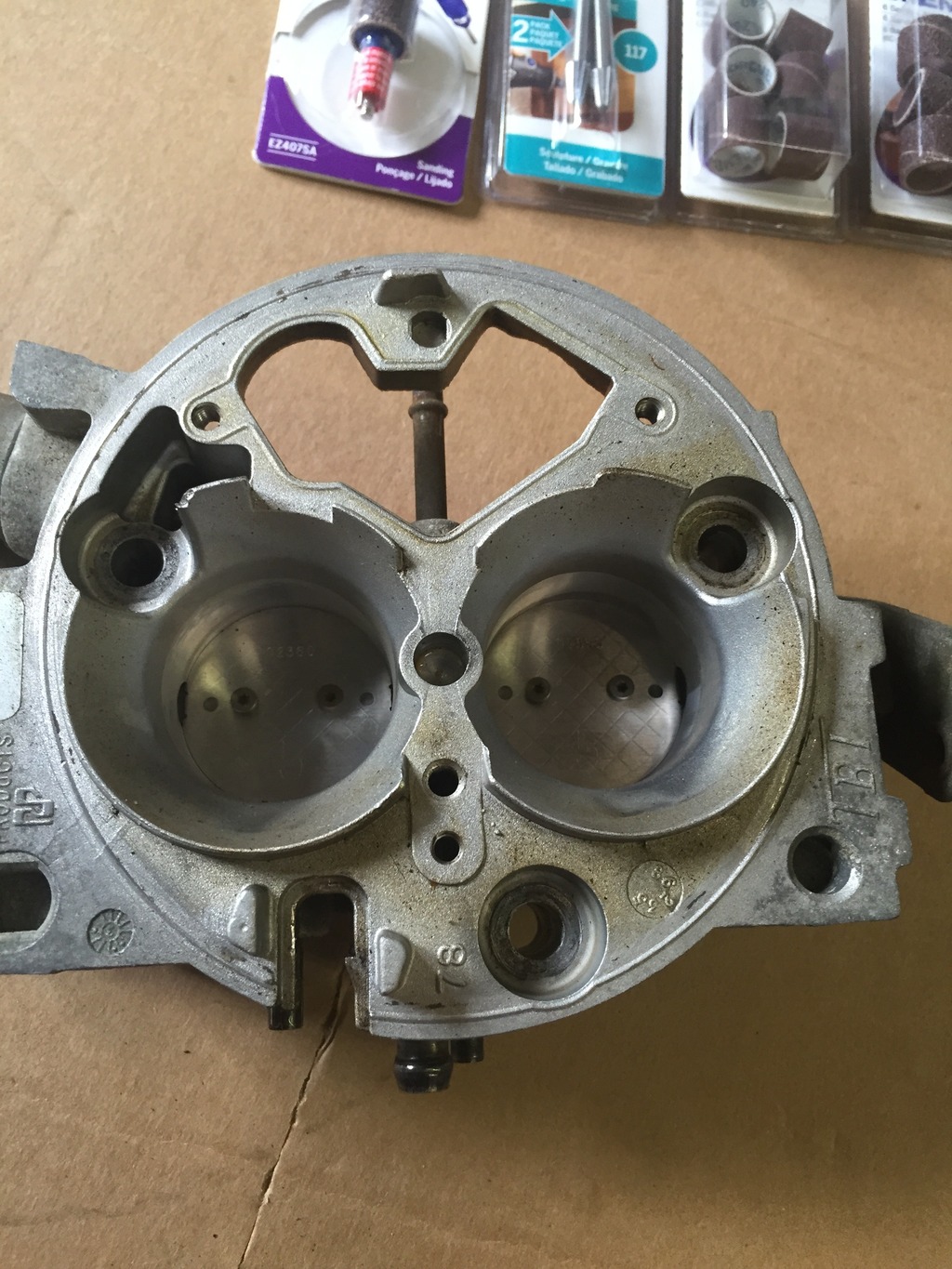

I've been doing a lot of reading regarding the TBI and upgrades for it so I figured it was time to start with a couple of them. I started with removing the ridges around the bores and opening them up a bit. I will also order a injector pod riser and TBI spacer in a day or two but for now heres some pics!

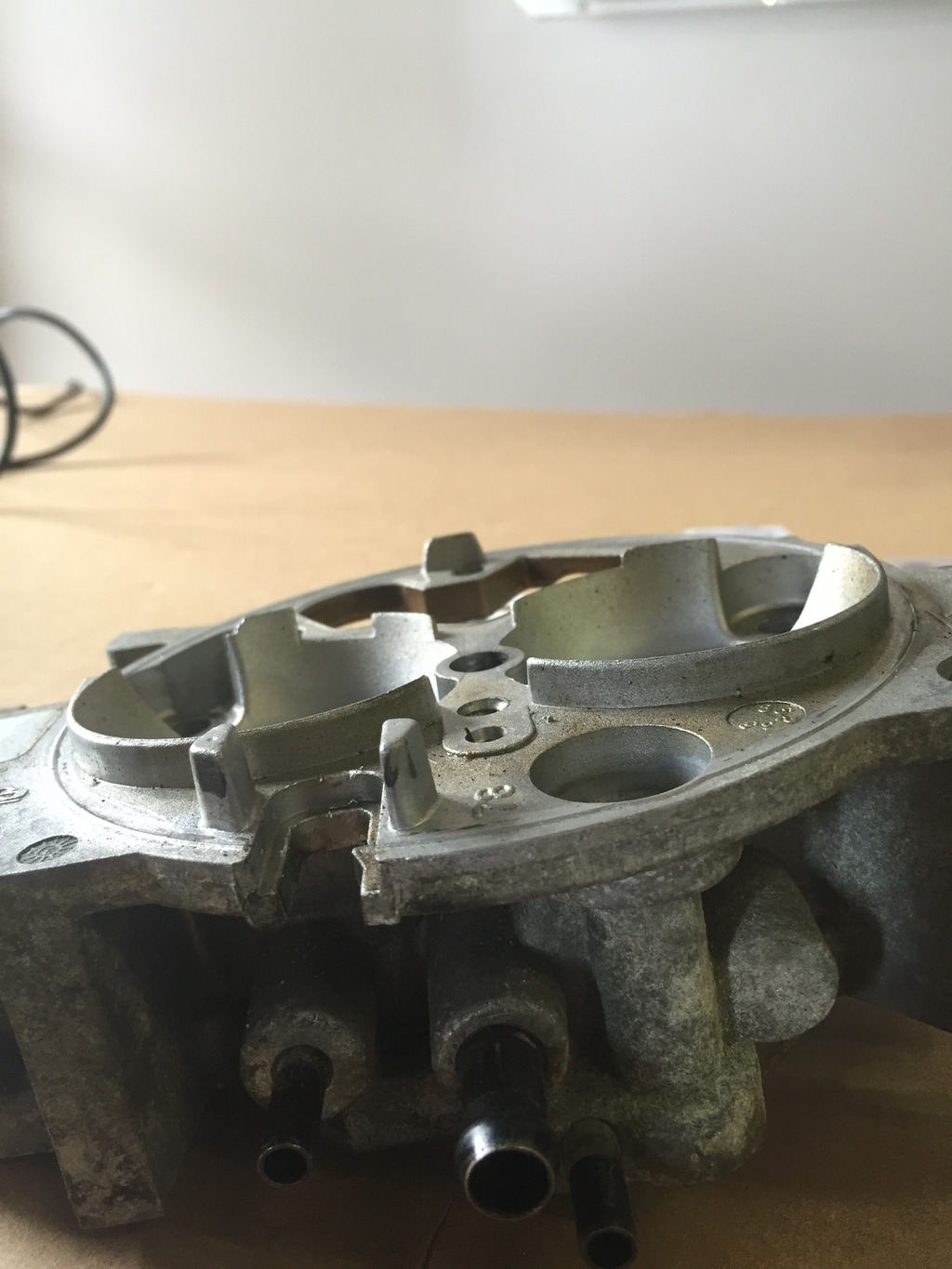

Before: For anyone not familiar with these you can pretty clearly see how restricting the ridges are to air getting into the intake.

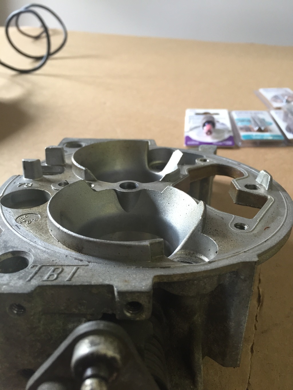

Prepping for grinding!

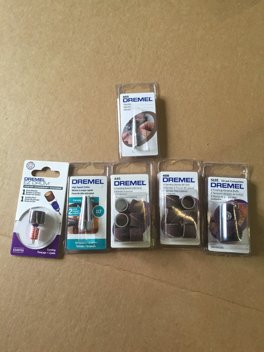

These are the tools I chose to use obviously attached to a Dremel

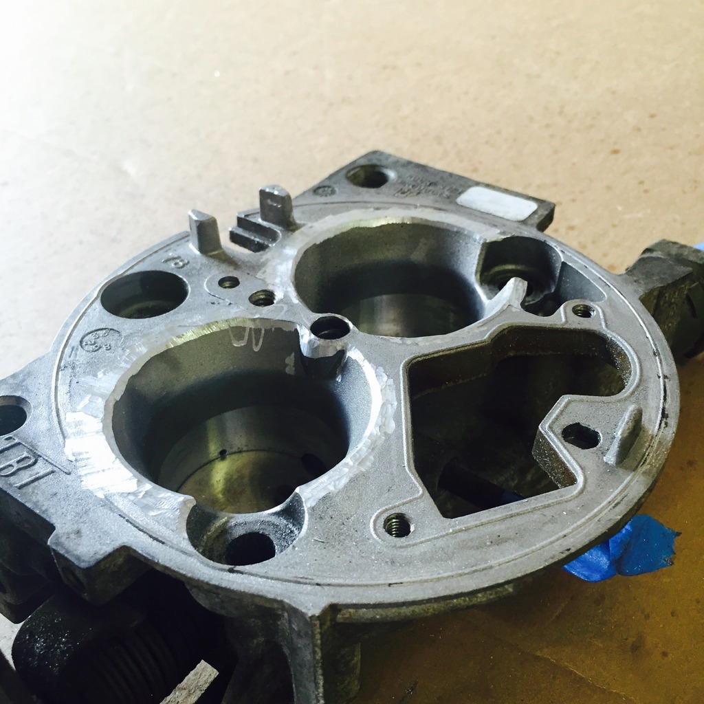

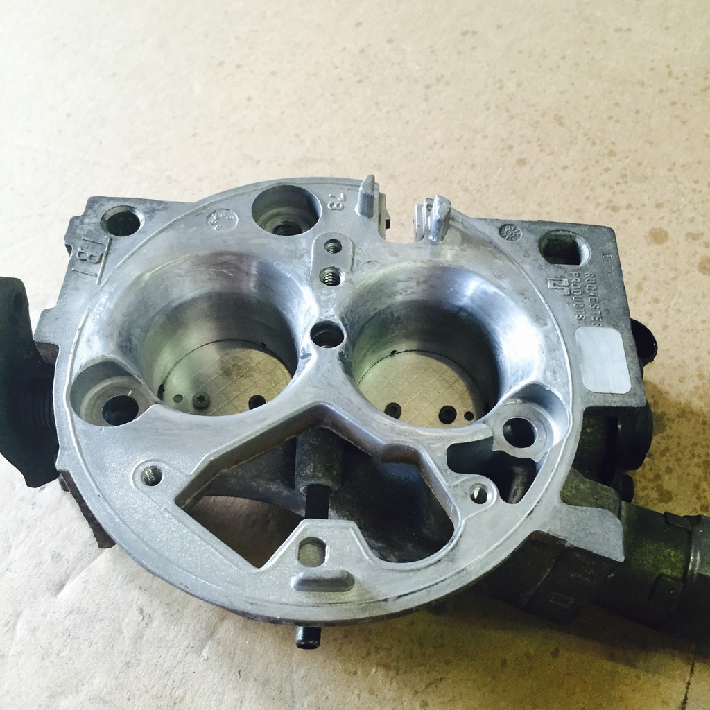

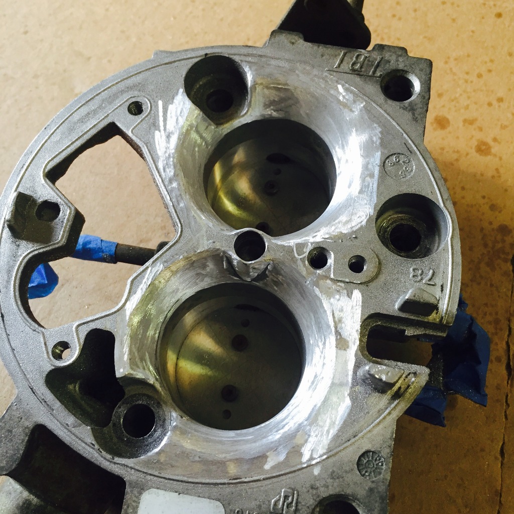

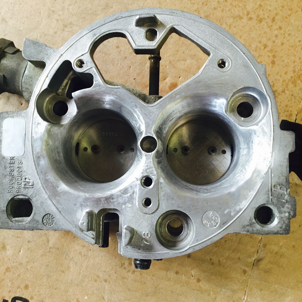

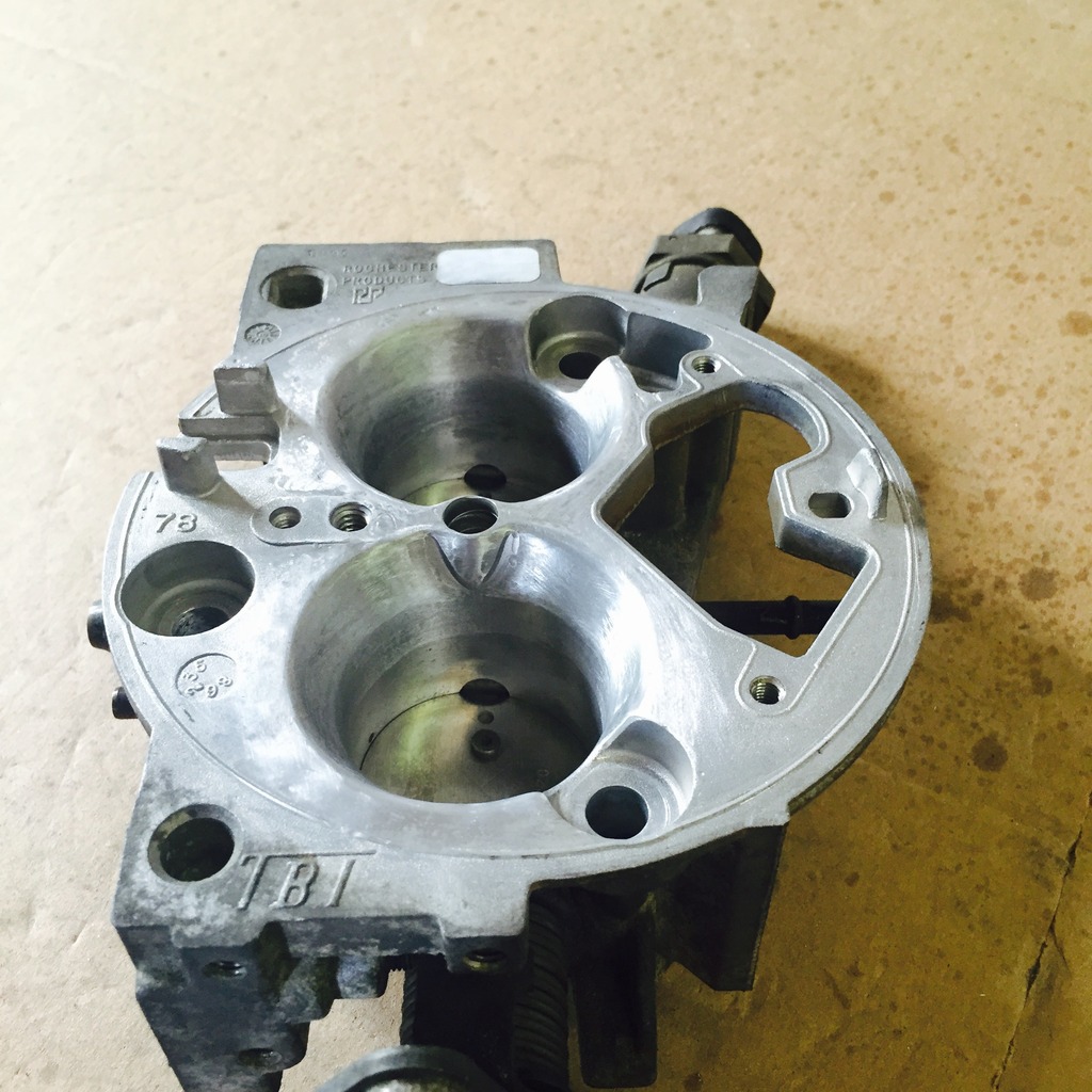

Ridges roughly removed. The cutting bit made quick easy work of these.
After a bit of work with a sanding roll.
And then finally the finished product. I messed up a bit on one of the raised spots that surround the entire TBI but I don't think that it will cause me any issues since there is a gasket there anyway

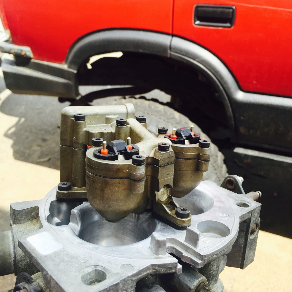

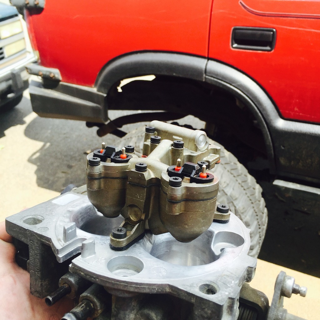

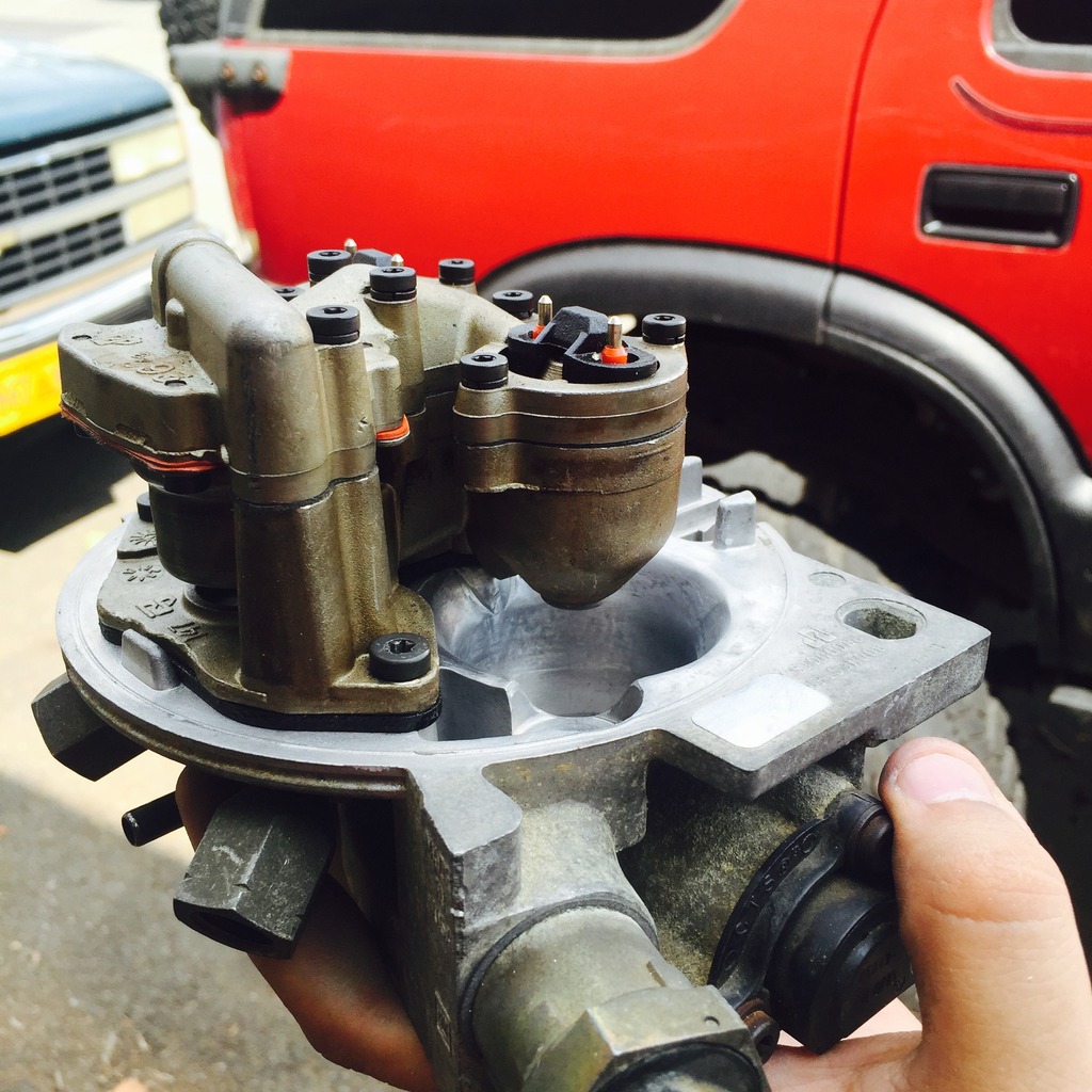

I wish I had remembered to get a pic with the injector pods on before but here is after.

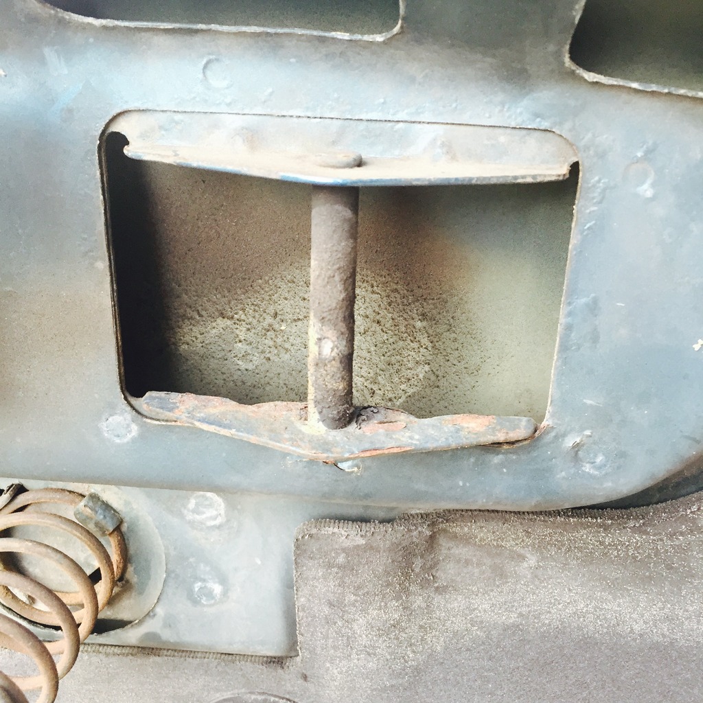

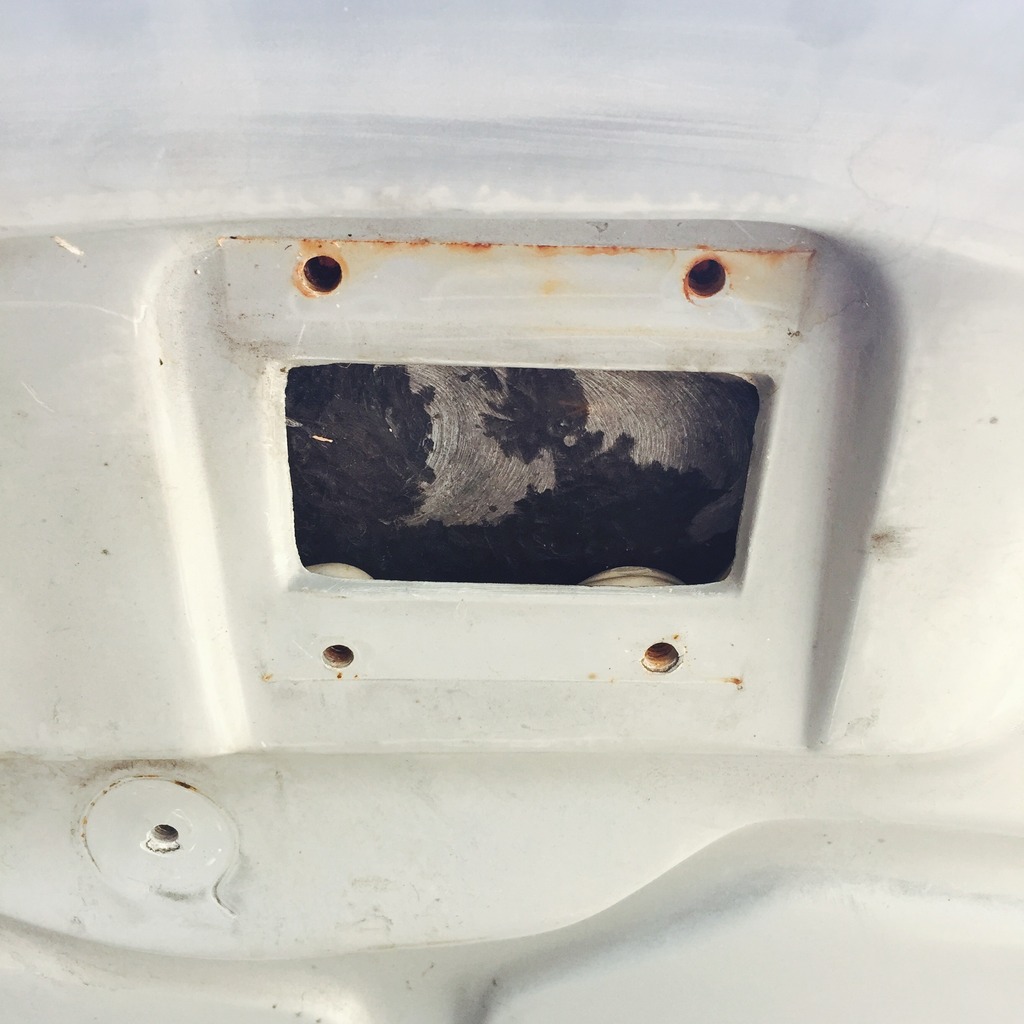

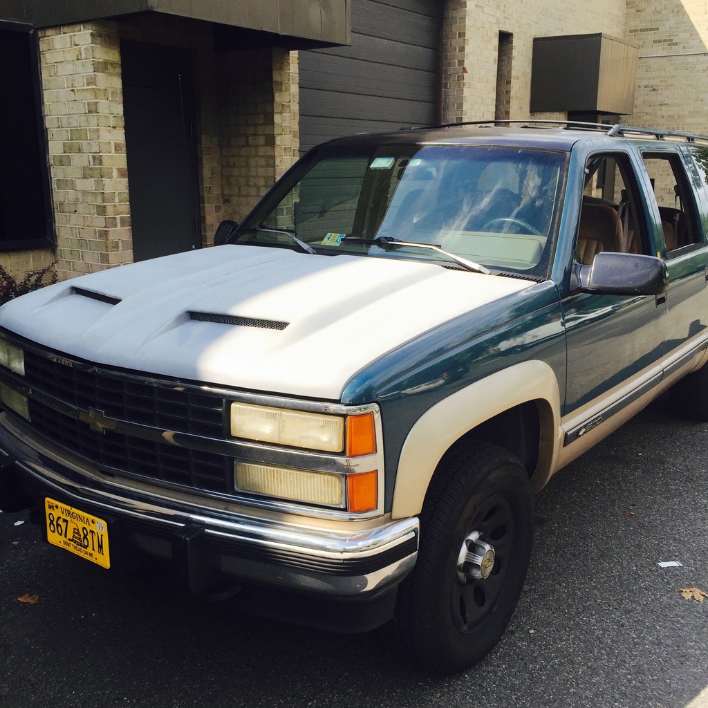

I test fit the hood today to see where things landed and was going to leave it on but found that I need to buy a bolt on latch for the hood side as the factory hood is welded on and the fiberglass is not
And the part I need

Has there been any proof that removing those ridges does anything? I have my doubts about it.
Old Jul 15, 2015 | 05:14 PM
  #37
rexmburns's Avatar
Super Moderator
Posts: 4,459
From: Northern VA
Haha my bad
I was skeptical myself to be honest! After doing all the reading I could find about it I decided what the hell why not it didn't cost anything beside the few dollars I spent I the dremel bits so I'm not out anything really either.
So for my personal review after about 20 miles I can honestly say it takes a bit less throttle to get up to speed but it's not like I bolted on a turbo by any means! The biggest thing I noticed immediately was about 50-100 rpm drop at idle and its even smoother than it was before. Other than that I don't really notice any change. For the cost and tone I think it was probably worth it just don't expect tire blazing changes in power lol!

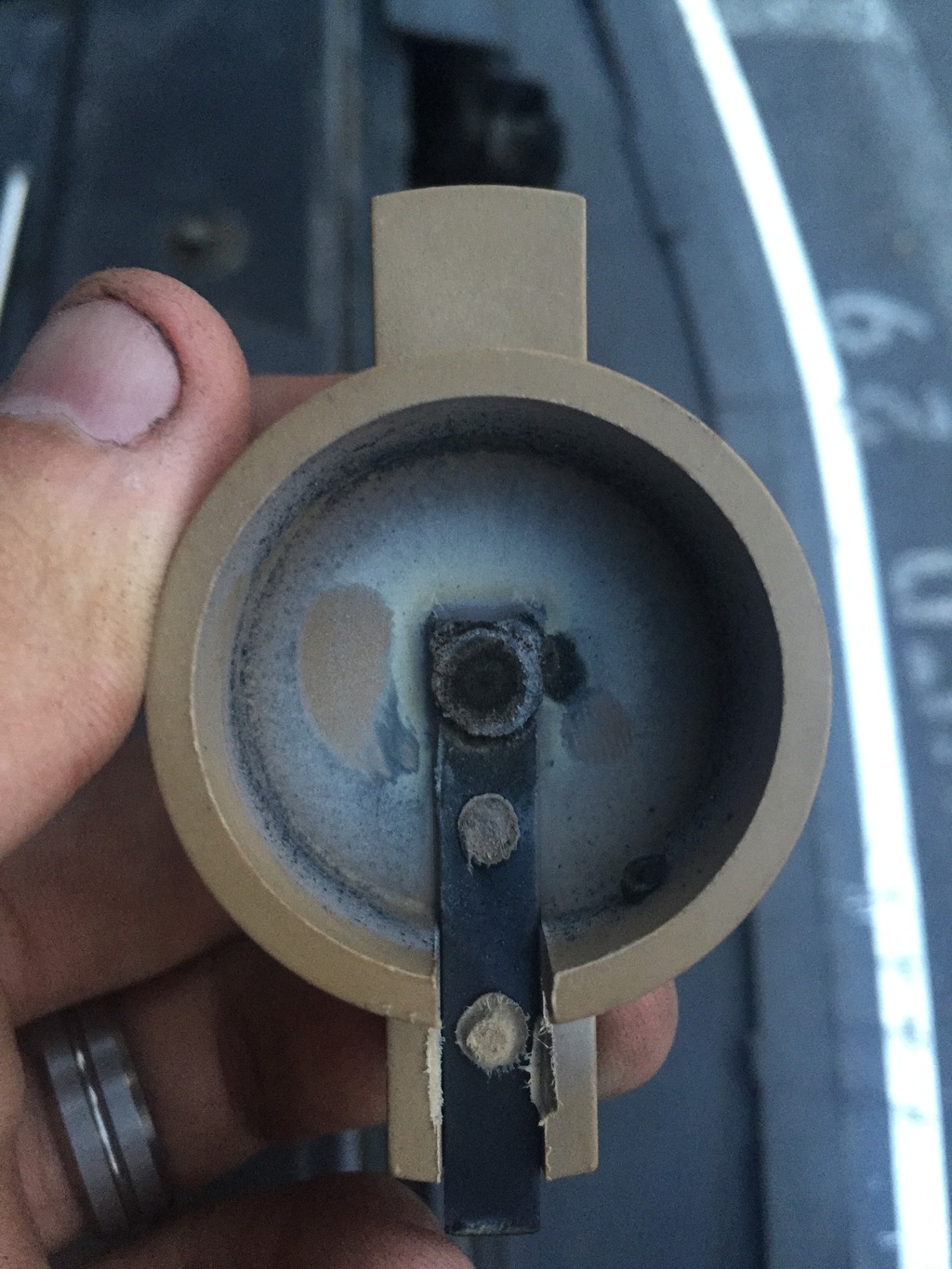

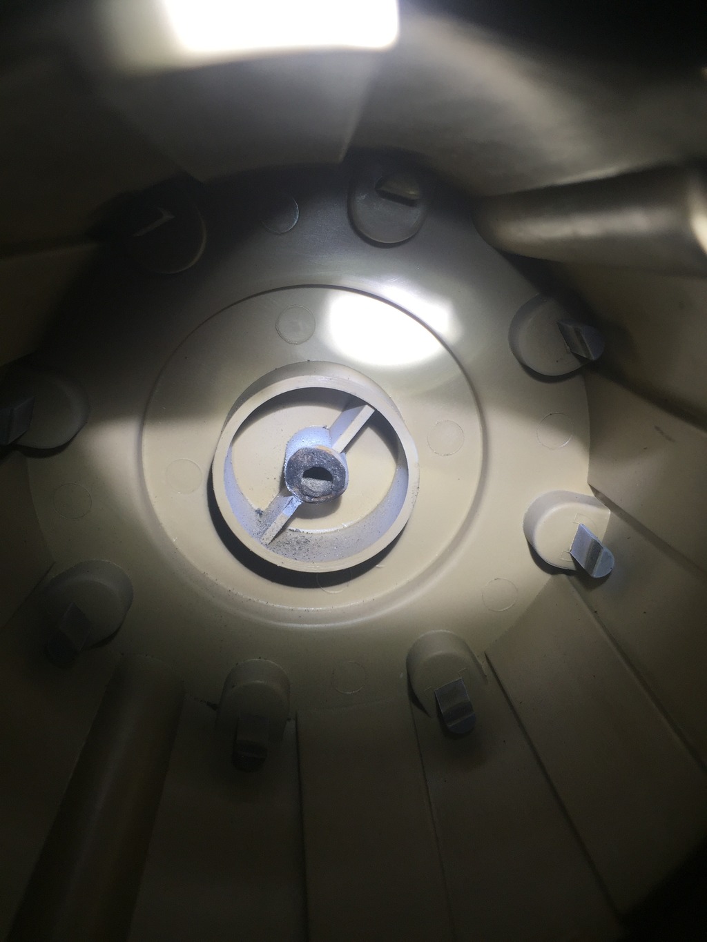

First thing I did was try fuel in the tb and no change so it's a spark issue. Checked all connections everything is good so I pulled the cap and the button on the cap is gone fried right off and the rotor looks like crap!! It's an Accell cap and rotor that I put on when I bought the truck so a little of 5k miles ago wtf! After some reading I guess I have to check some grounds and spark plug gaps tomorrow and try and figure out what caused this to happen. Could be the coil as well from what I gather so I've got some trouble shooting to do. I just ordered a water pump for the blazer and new cap and rotor for the burban so I'll be staying home tomorrow to fix these things hopefully and with any luck things will go smooth and I can get the work truck fixed as week and than maybe I'll have time left over to go fishing after today!!
The spot on the left is just from my finger
And the inside of the cap
Wish me luck!
