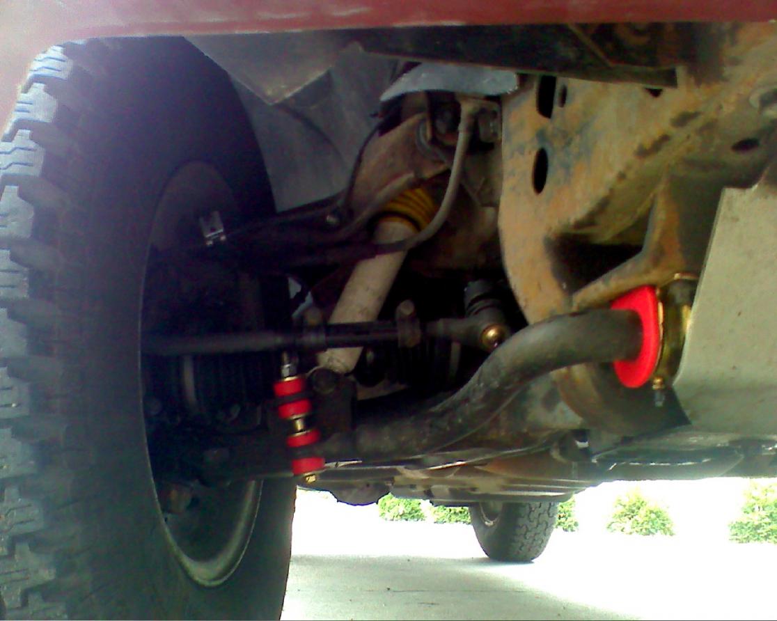

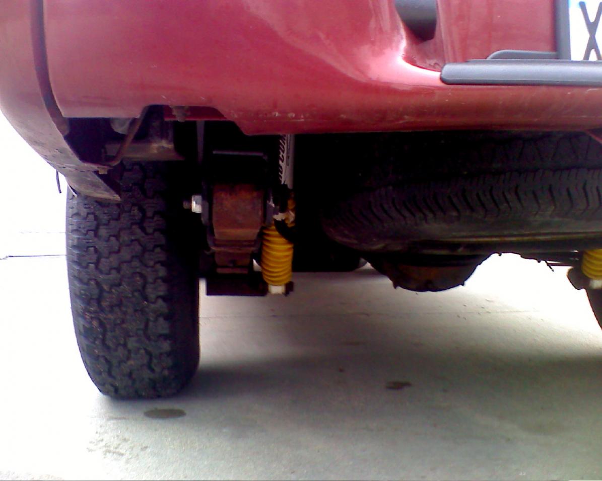

Well, it took alot more time and money than I had originally planned on. I ended up replacing the two front wheel bearing hub assemblies first. Then we went to the shop. First day got the A-arms knocked out, and took apart the entire front end. The boys got the Procomp9000 2" lift shocks in the back. Those shocks are monsters! Saturday, they came in and worked on the front end. Had a hell of a time with the upper A-arm bushings, and we ended up just putting oem in the upper as the metal burned up every time they tried to burn the rubber off. The rest of the front end, and sway bar are all Energy Suspension. Next came the PowerPerformance front end kit. They got the kit on Saturday and Sunday, along with the SynergyOffroad 1.5" lift shackles on the back. New Procomp9000 and yellow boots on the front. I'm telling you, the front end looks bad-a$$. Went ahead and got two new CV shafts for the front...these are guarenteed for life, and a good investment with the T-bar crank. Monday saw the T-Bar crank, and alignment. Took the shop about 3hours to align and level the front. The drivers side was a bear for some reason. The passenger side was only about 1.5 degree's out, so it wasn't bad at all. Next the four wheel drive. Was the activator switch...the one with the little ball bearing looking plug. The plug was bad. $20 part. So as of right now, that's the end of this stage. The blazer rides TIGHT!!! Almost rough, but not quite. Cornering is about a million times better as you can merge right in anywhere with NO body roll. Hopefully it will rain this weekend and we can take 'er for a spin in the mud.

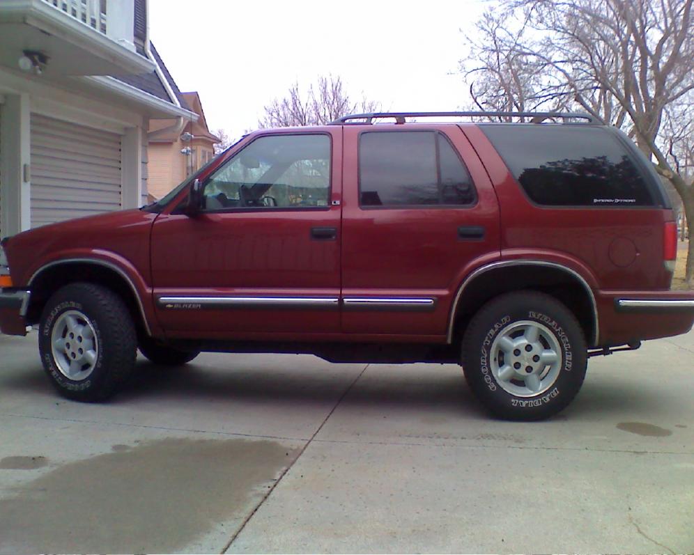

Here's how she sits this morning. Yeah...I hadn't planned on replacing the cv shafts, but thought, "what the hell"...were doing everything else, right?
