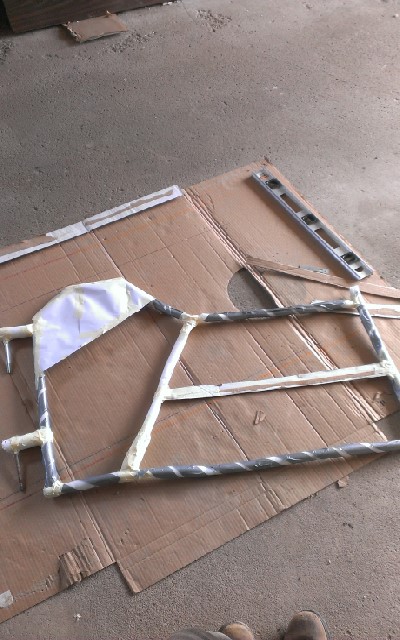

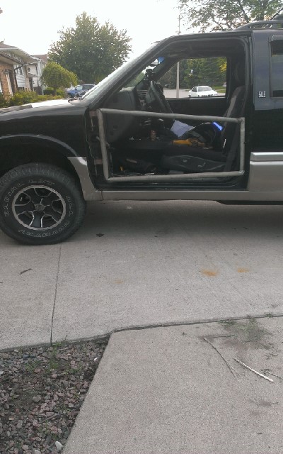

Most recently, I've began a bit of a project. tubular half doors! I almost have enough steel to make the two front doors, more than enough for one door. It's going to be 1 1/4" diameter steel that I'm using. I have a welder so I can actually do it all myself.
I've got the hinges figured out and have a pretty good idea for the latch. All that's left planning wise is to get a bunch of connectors so I can just disconnect the regular doors when I want to remove them.
When I got my roof rack, the bars were all wrapped in styrofoam, which I used to make a rough copy of the front doors. Everything is measured out and all I really have to do is cut the steel up and weld it together. As soon as it's consistently warm out I'll take the regular doors off and make sure everything is perfect!

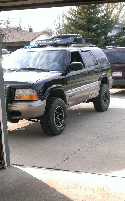

So here is how my truck sits now. Suspension wise it's got a 2.5" lift with an add-a-leaf. 30x9.50 tires.
And here is the rough copy of my doors. I like the way it's looking so far and can't wait to have the actual ones! I plan on making back ones too, but those will be much simpler.

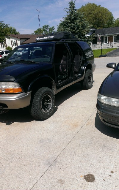

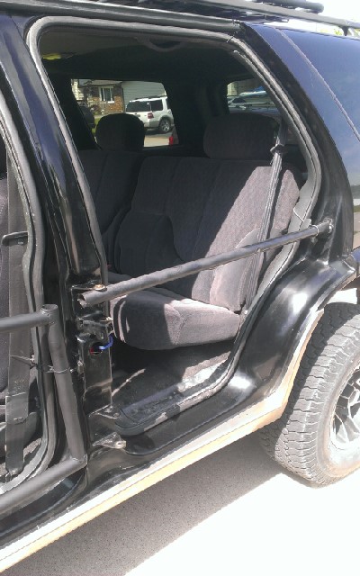

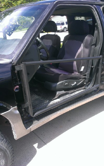

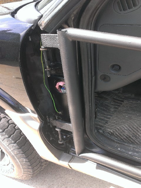

So, what do y'all think? They're nice and simple in my opinion. The wiring for the rear doors already has disconnects right at the jamb, which I only found out as I took the doors off. The hardest part was definitely popping the springs out of the doors, everything else went pretty smoothly. The doors are also lighter than I expected. I used the door pins from the front for the tube doors, and just bought new ones for the regular doors.
The rear "doors" are just a bar across for now, I was planning on making actual doors, but a few people said the bars looked good enough, so maybe I'll just leave them like that. I cut slots so they slide onto the existing latch. For the front, I tied paracord around the one bar on the door and made a loop, then hooked it on the inside of the truck on a screw I put inside, so it holds the door shut. For the rear, I used the little clip for the seatbelt that's there and just wrapped it around the bar and hooked it on itselt.. Not sure if that makes sense so I'll post a few pics when I think of it.
Any suggestions or tips to make them better? Tell me what you do and don't like!

I like em but I think you should add something to the front similar to what you had in your mockup or an X or something just to take up space and help add a little strength am seeing to it. Other than that they look great. Do you plan to find an alternative closing solution?
