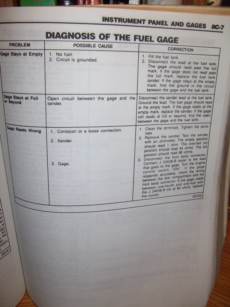

okay now that we got her lit up...need to tackle the dreaded fuel issues....
like most of yall know, the fuel gauge is stuck at over-full...thinking i might have to drop the tank...((again)) and replace the sending unit
ive had the tank off before and the float moved just fine so the float itself isnt stuck or anything
any suggestions before i drop the accursed tank and aimlessly throw money at it? haha

Heres some homework for you Gm service manual to the rescue !
Lol the 1st cause is funny .......
fuel gage says empty because i have no fuel, who now gio i think you are defying the laws of common sense with that one
Old Mar 20, 2012 | 12:20 AM
  #26
Thogert's Avatar
Posts: 4,313
From: Who even knows anymore
Hahaha, oh man. The fact that it says it in the manual means they had to explain it to somebody....

diagnosis complete...sadly it is the sending unit...thus another tank drop is near....this would make the 2nd on this blazer....5th or so all together....
so excited...
