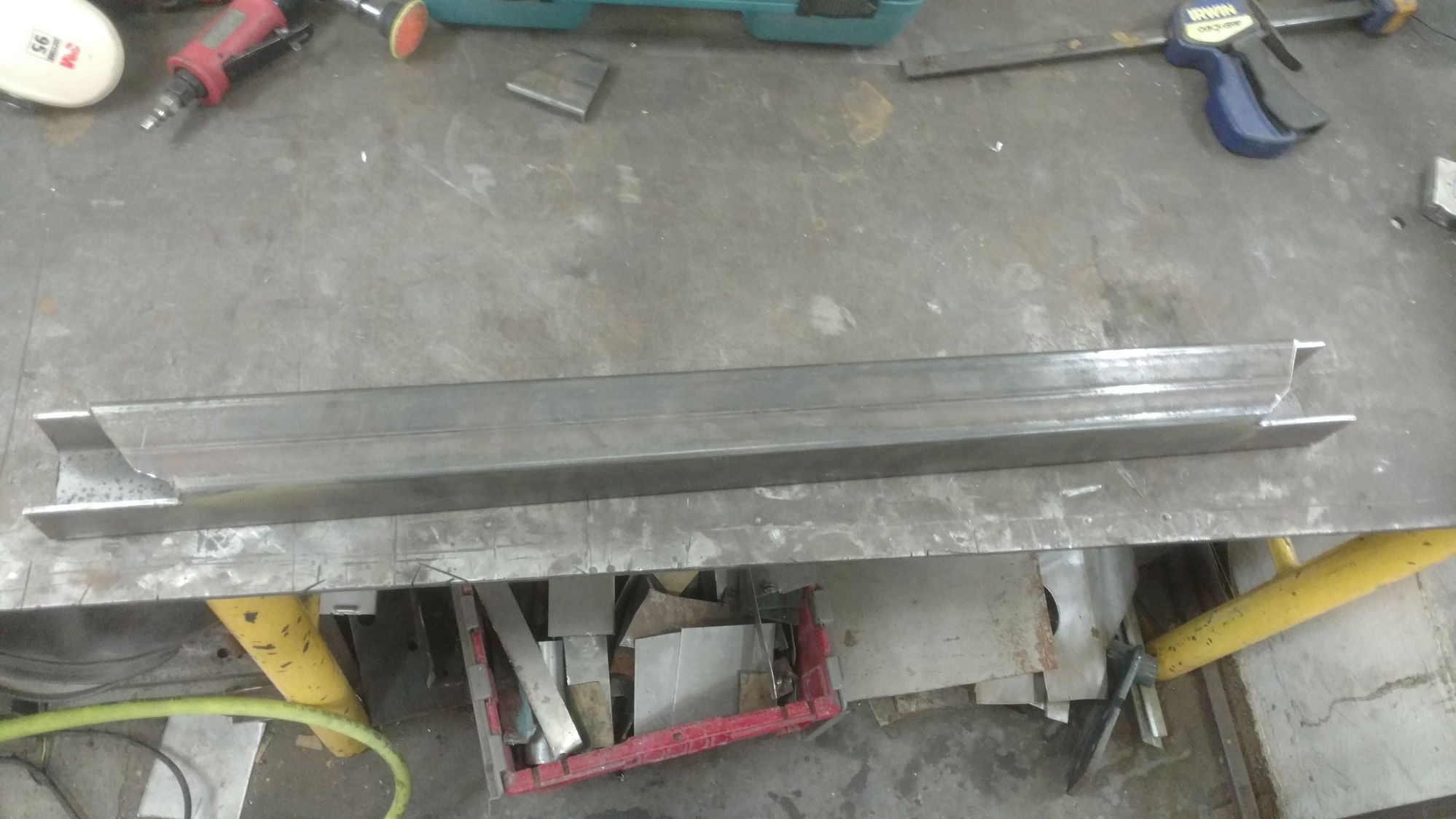

Dropped my fuel tank and built my rear shock hanger today
Set up directly above the axle, had to notch it around the body mount slightly, but still have room to replace them if needed down the road https://cimg3.ibsrv.net/gimg/blazerf...a427c55c8b.jpg https://cimg0.ibsrv.net/gimg/blazerf...59ca5157fc.jpg Welded in https://cimg8.ibsrv.net/gimg/blazerf...b7688efa8e.jpg Also cut the old shock cross member out. Going to pick up a pair of adjustable rancho rs9000xl'sfrom Napa tomorrow, and I'll get the tabs fabed up and them installed. I'm going to be triangulating the shocks at around 20 degrees / \ |
