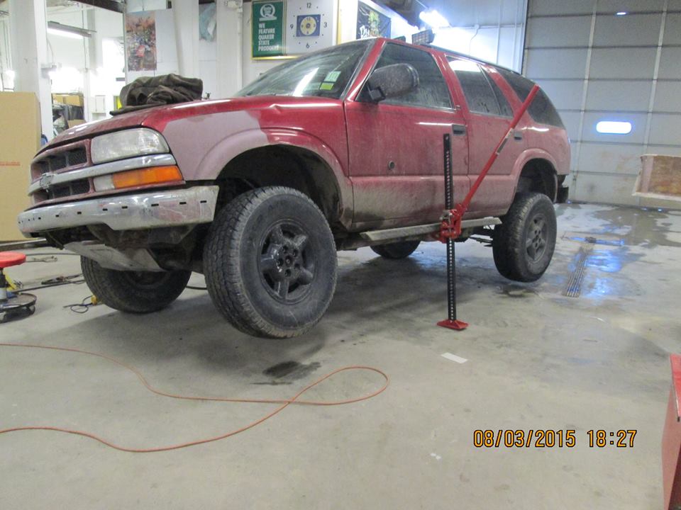

In short, plans are:
-mod engine for a lil more horsepower/torque
-Solid axle swap Dana 44 front and rear, mechanical locker in rear, aiming for around 6" higher than stock (im at about 2" higher than stock now)
-35" m/t's
-custom front&rear bumper(winchbox with8500 lb superwinch up front)
you get the idea

Mods i have already done:
-throttle body mod
-MPFI injector conversion
-some evap deletes
-Glasspack
-added aluminum skids
-2"shackles
-Torsion bar cranked
-Fender trimming
-Custom Rock Sliders
-custom toolbox in cargo area
-31" tires
-added leather heated seats
-pulled abs fuse(may bypass completely with proportioning valve)
-a/c delete
-AIR system delete
more im forgetting...

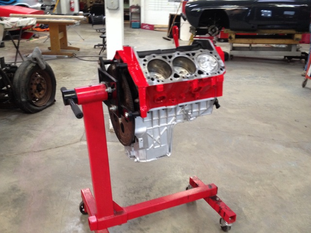

finally got the block painted! used ppg epoxy sealer(dp90lv) and PPG single stage(DCC) paint. the color is GM's Race Red accent color.
Also, after a ton of research, I'm dropping my heads off at the machine shop on Monday to have them milled .030 which should bring my compression up to right around 10:1 give or take a little. also, im having them mill my intake side of the head back to the factory angle(10 degrees im told) so my intake will still fit properly.
