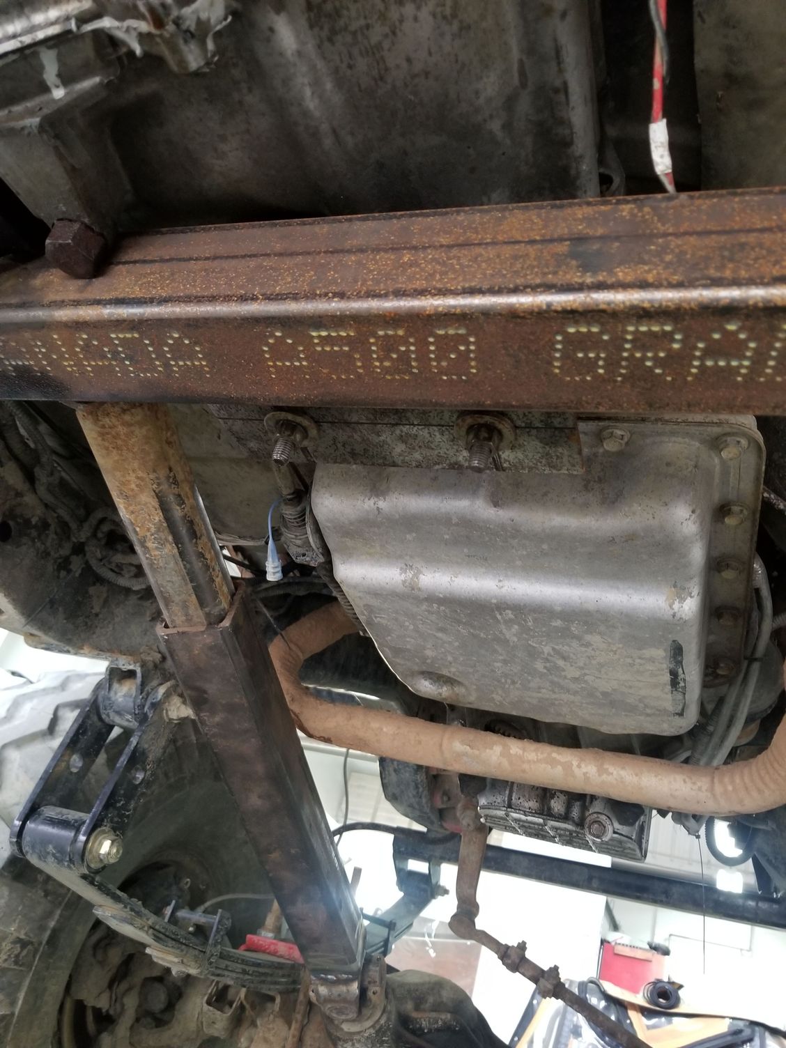

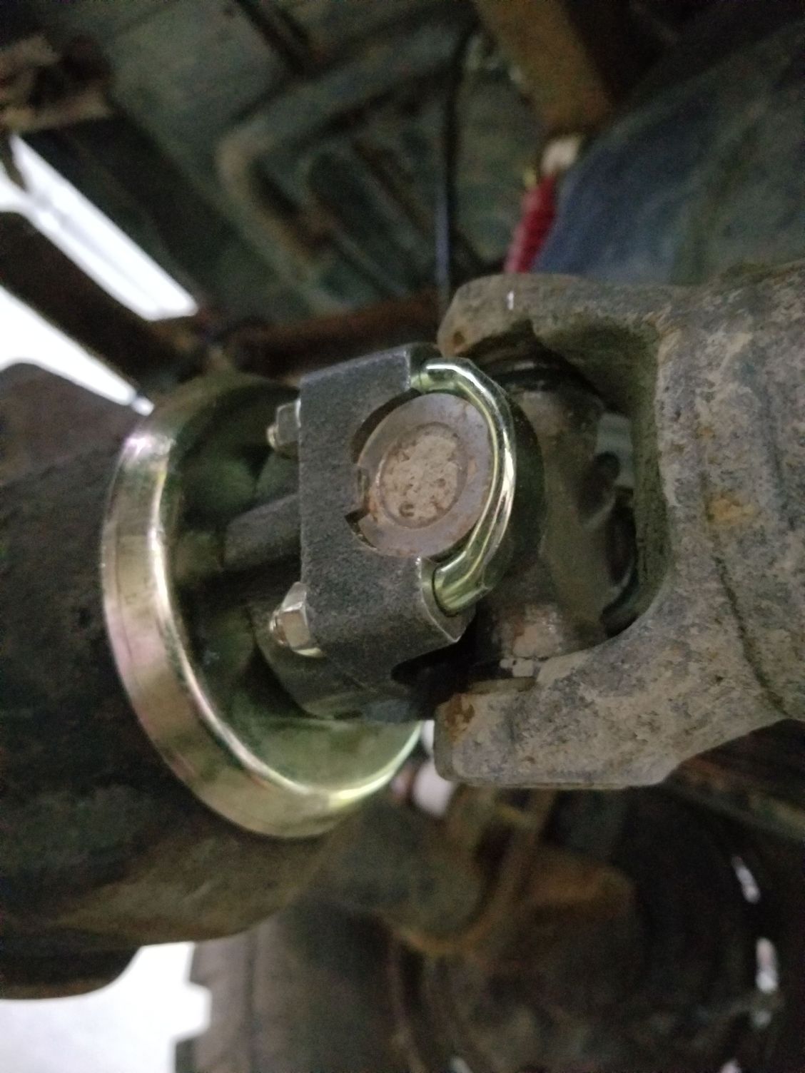

Got my ubolt style rear pinion yoke on today. Changing it was a breeze, I was surprised it went so smooth. The thing seems way beefier than stock, and the u bolts are much easier to install than the strap style clamps.

DonL May 22, 2018 08:17 PM
Won' take long for it to get all muddy lol... I like the looks of the u bolts
