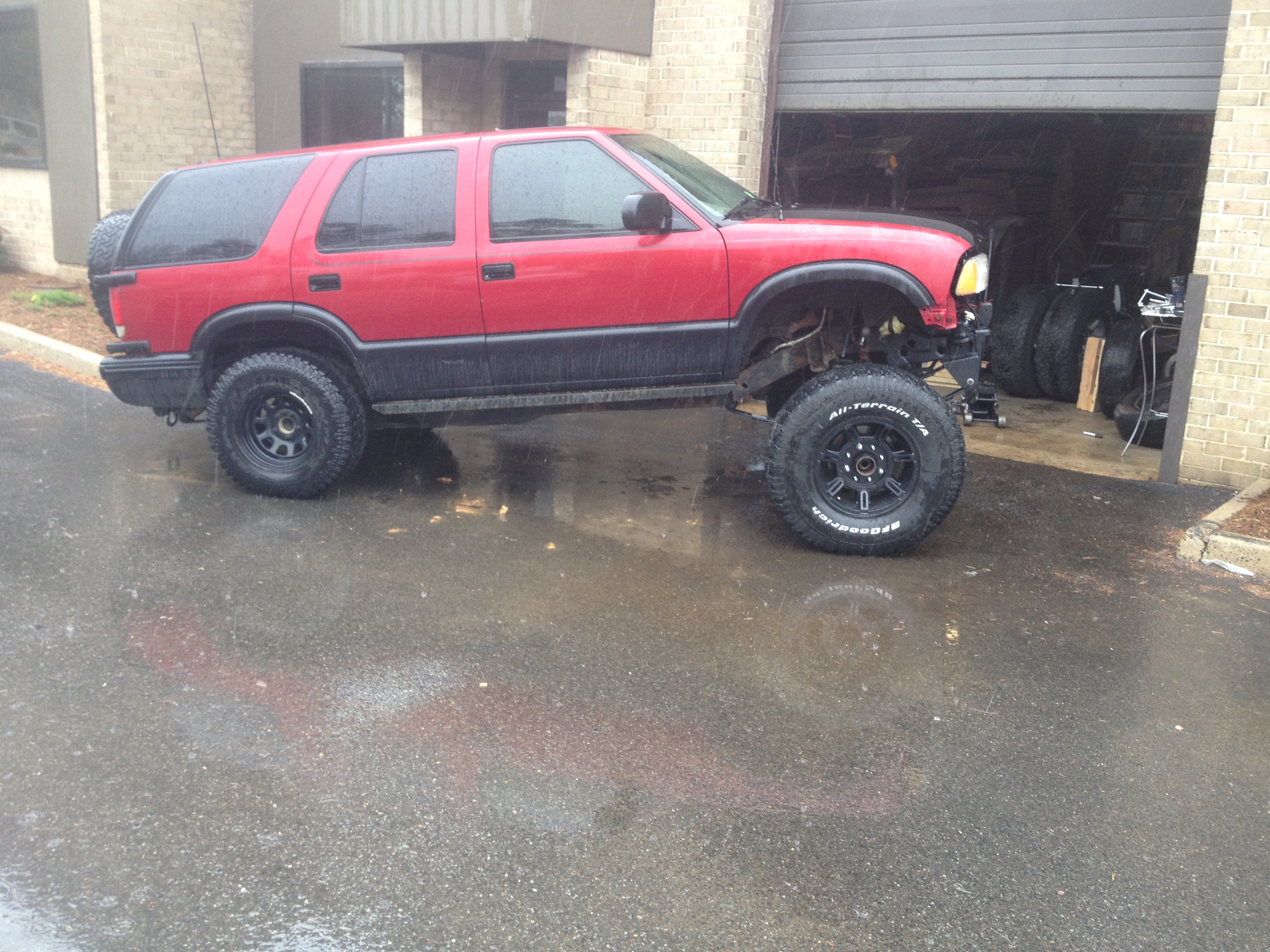

That last picture makes it look like you are building a gasser style blazer. Really like the build so far.

Thanks! I was thinking the same thing about it looking like a gasser lol. I can't wait to get the rear end up too ... Probably going to be a few weeks though

I'm personally not a fan of that look because I see it down here almost every day haha We call it the carolina squat/poor boy's lift :icon_teeth:
I absolutely hate that look.

I think those trucks look like scared dogs peeing on themselves lol!
I've been there tho!

Haha I've heard it called the Carolina squat up here too. It does look stupid... Usually brand new mall crawler full size trucks with 8 light bars that I see like that..
Got the truck sitting up on a small floor lift in the rear so it sits level now. Pictured next to a Toyota Tacoma for reference of height...She's a tall one.
