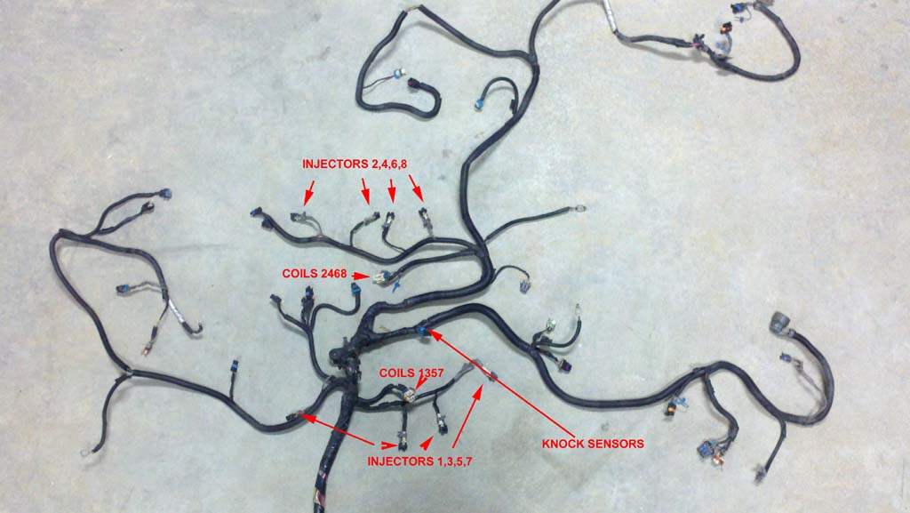

I am looking for a wiring diagram for the LS series engine however. I have this massive pile of "spaghetti" attached to the ECM and some of the connectors are obvious, but the vast majority I'm clueless and would hate to hook up something wrong. I do know that it will lay out pretty much as it's suppose to, but would still like to have the diagram just to make things a bit easier.
your gonna wanna run the cable drivin throttle body (99-03?), it will cost alot more to run the electric throttle. i got my engine (6.0LS) going in a 00 GMC jimmy with bad head gaskits. i ended up selling my body that i had (02 chevy blazer) but i'm subed to this thread. im gonna see if i got the wiring harness diagram for you. i think i only have a few but im not sure on what there for.

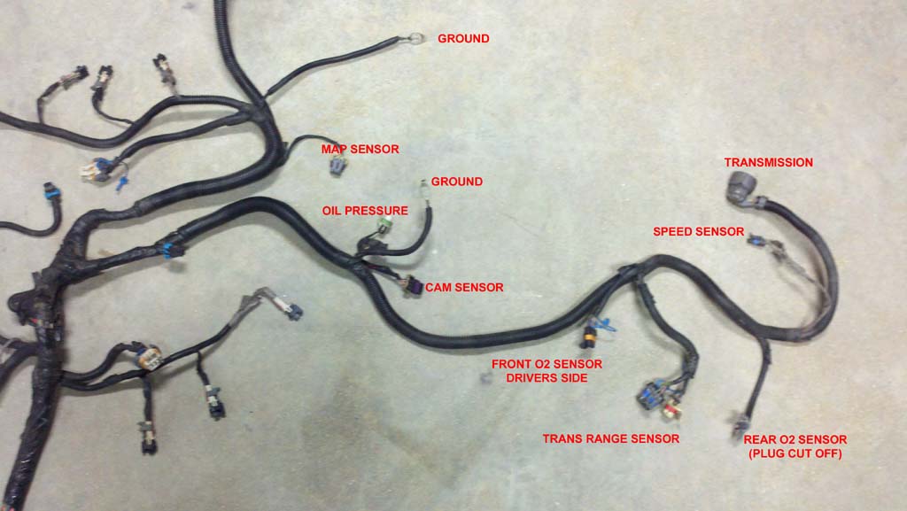

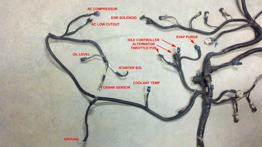

the only pictures i have are these, (im not sure if they will show up im not sure how to upload them)
Attached Thumbnails Project Lil' Stinker-harnes_labels_03_zpse84a0396.jpg   Project Lil' Stinker-harnes_labels_02_zps966de893.jpg   Project Lil' Stinker-harnes_labels_01_zpsf4d4329d.jpg   Project Lil' Stinker-harnes_labels_00_zpsb608d2fe.jpg

WOW! Pictures came out GREAT and are nice and large to view here and when I printed them off, they're nice and clear! The detail is plenty for what I'm needing to know.
