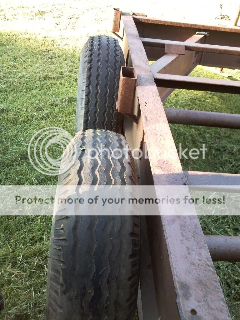

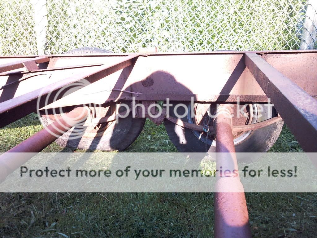

the suspension:

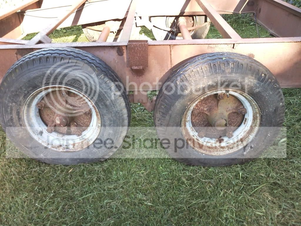

the weird brake drums wheels:

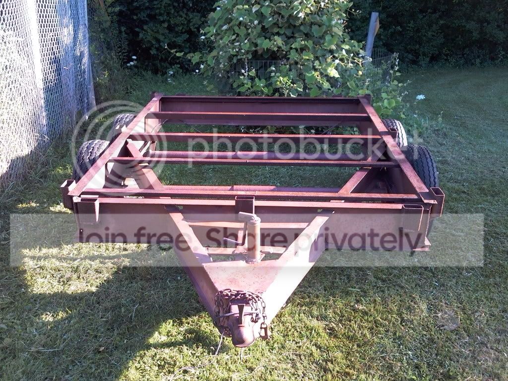

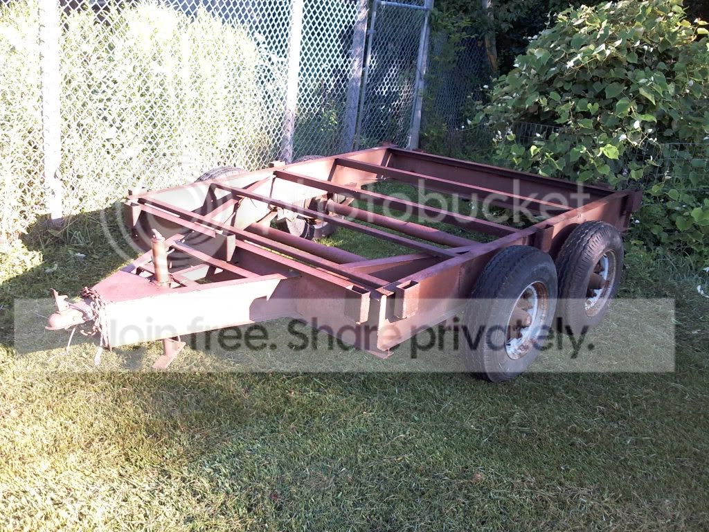

Wow that looks pretty darn stout.
