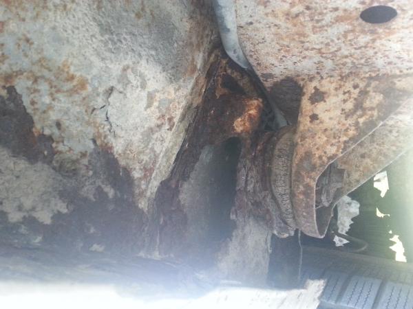

HOWEVER. The body mounts just under the passenger and driver side doors (just before the wheels) are rusted to the 7th ring of hell. There's maybe 30% left of them. (Photos at the end of this paragraph). What should I do? I have no idea. My ideas range from just cutting the bitches off altogether to cutting good ones off an old junkyard Blazer and somehow splicing it into my frame. Either way it's going to be a very aggrivating bit of work. Any suggestions would be GREATLY appreciated.
Driver's side (don't know why the images changed orientation...)
Passenger side.

Tires beeing off is alinment body mounts can be fixed. you can buy replacement body and frame mounts, just to find someone to weld them on for you. Common issue with these Blazers. Can also cause door sag problems

Been there, done that, Still need to do the passengers side on the 93 Jimmy. Drivers is already done. What I did was get the floor pan, and the body mount from LMC truck. Weld the body mount in place to the floor pan replacement.. Then measure, measure measure, cut and then weld a new piece in.. Took about 4 hours at the most.

Where'd you get the replacement from? Junkyard? You just cut the old one off and welded a new one on? I get the idea I think but the technical side (how to actually physically do it) is the hard part for me.
Alignment can fix the elevation of the tires...?
I found a body-mount kit with new rubber donuts, gonna buy and install once I replace these rotten ones.

OK missread body mounts are most likely the culprit. Do them first then check

i had a old s10 that started about that bad, the body mounts literally fell out so i just shoved some wood in there which eventually just smashed into the floor when the body split in half and fell down on the frame. so needless to say you probably want to fix that before the floor starts splitting
Thank you so much for your feedback!
Got it all on Truck Parts & Truck Accessories for Chevy, GMC, Ford & Dodge Trucks | LMCTruck.com
you could cut the old one out and weld the new one in.. but there is not much room to work with under there.
I had to remove a section of my floor because the floor was gone.
When you get the new ones, take the body mount bolt to a hard ware store, get a nut that is the right size and thread, and weld it to the new cab mount to make bolting it back to the body easier, otherwise you will need to cut a hole in the rocker to get a wrench in there to hold the nut in place.

No luck finding the part... they have everything except for the bracket itself. Gonna have to cut a few off a poor Blazer at the junkyard. HOWEVER this is an excellent resource for finding other odds and ends I am in need of... thank you for sharing!
I guess step 1 is go salvage the parts I need from the junkyard. Either this weekend or next; depending on the weather.
