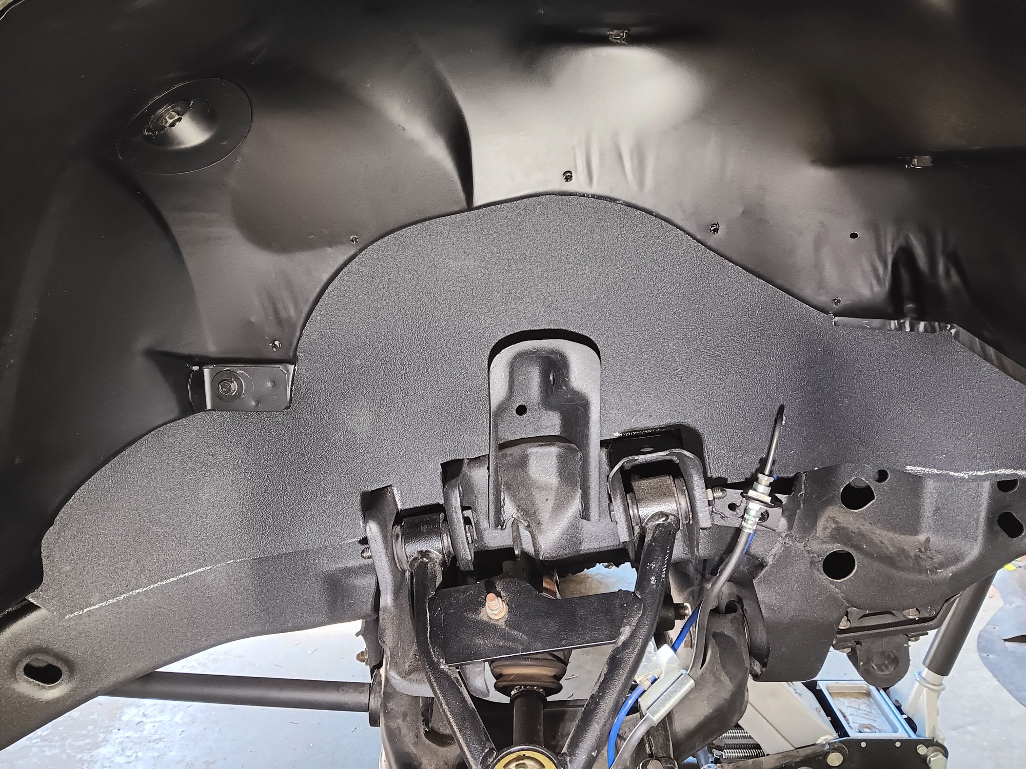

A couple of other projects...old vs new fender liners

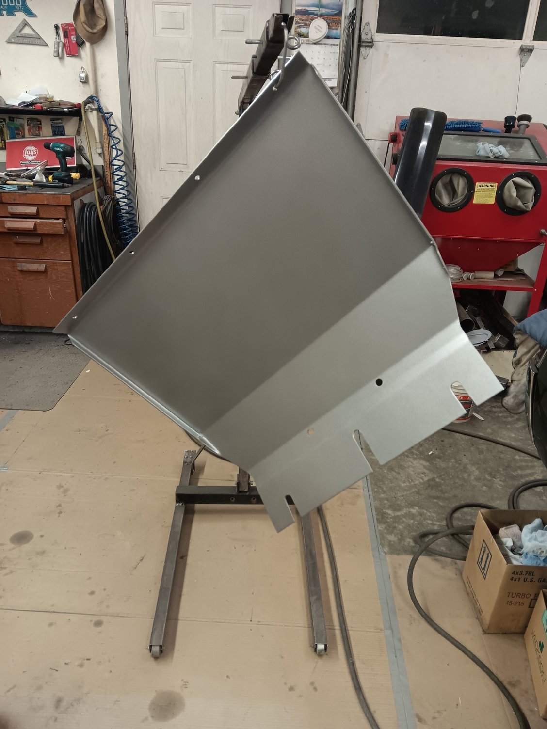

Gas tank and transfer case skid plates
Also started making a new front skid plate. The upper support attaches to the tow hook mounting bolts. The rear slides into the existing mounting points for the diff skid plate already made.

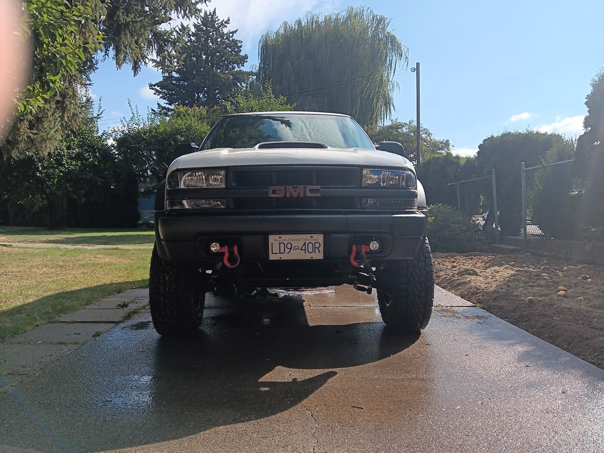

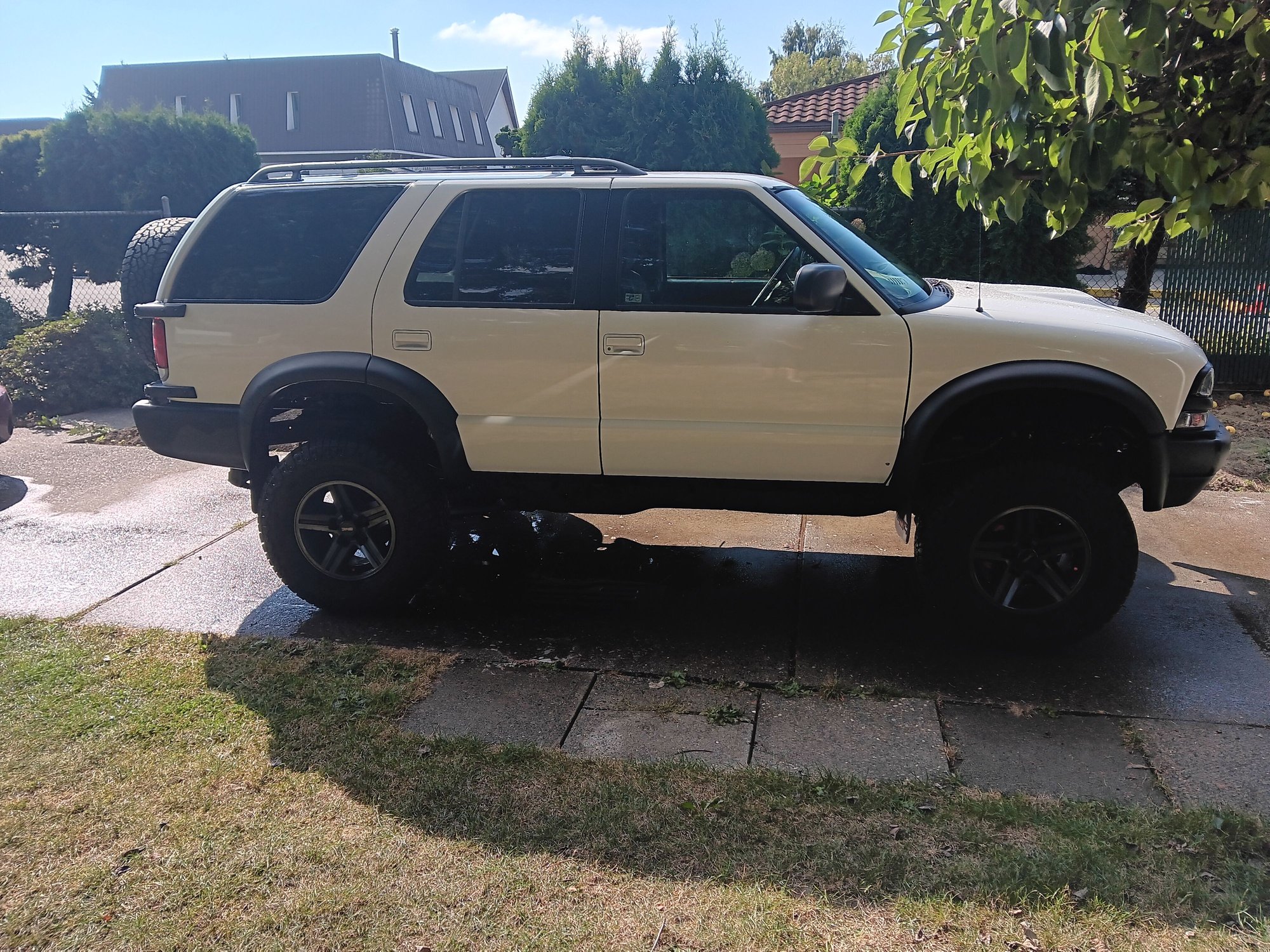

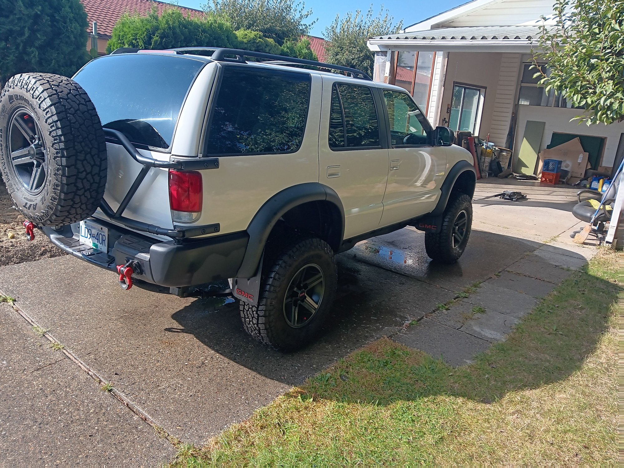

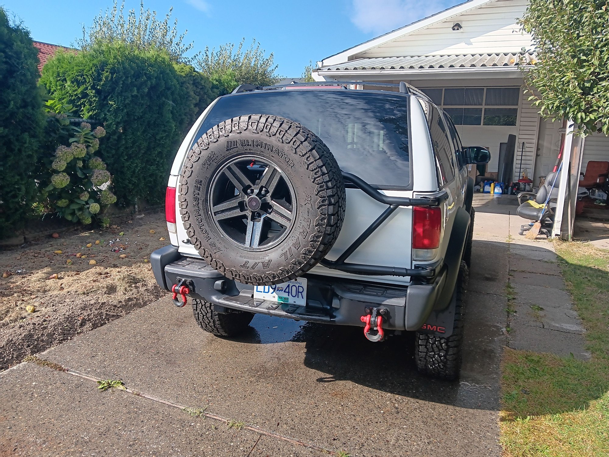

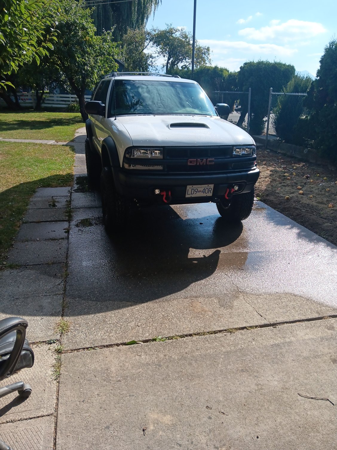

Wheels on and washed off a year of dust.

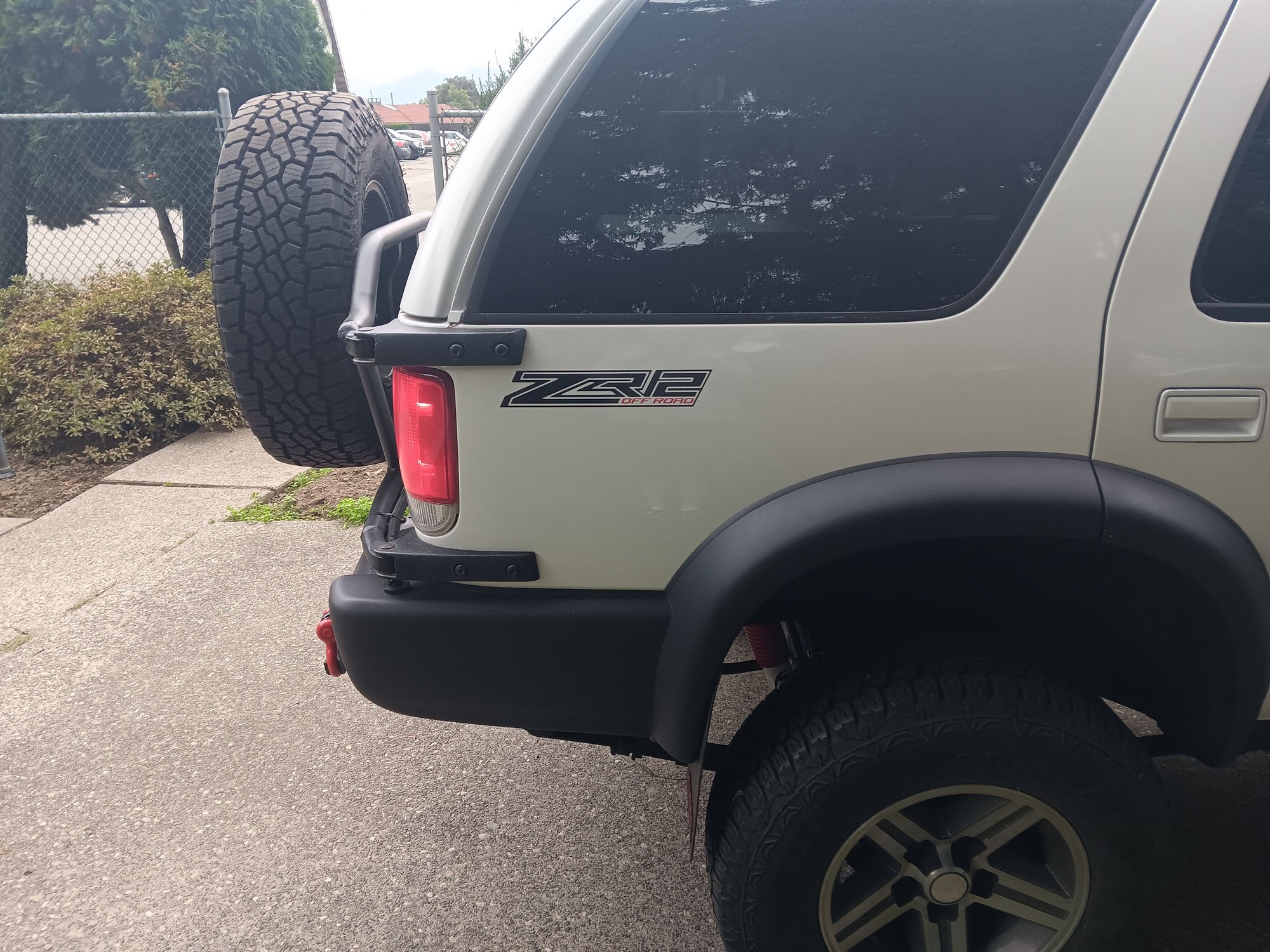

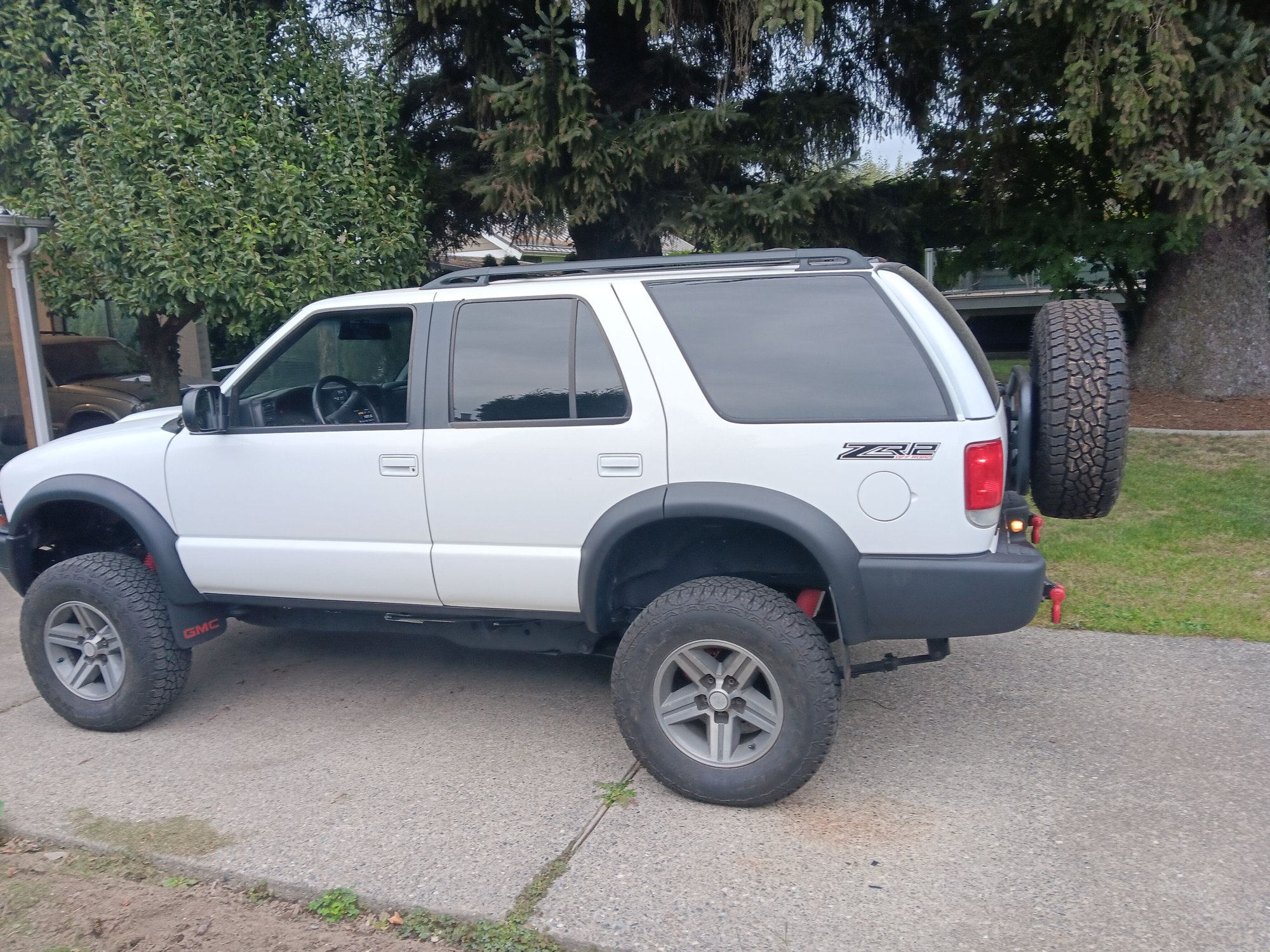

Decided to add some decals, not 100% sold on them.

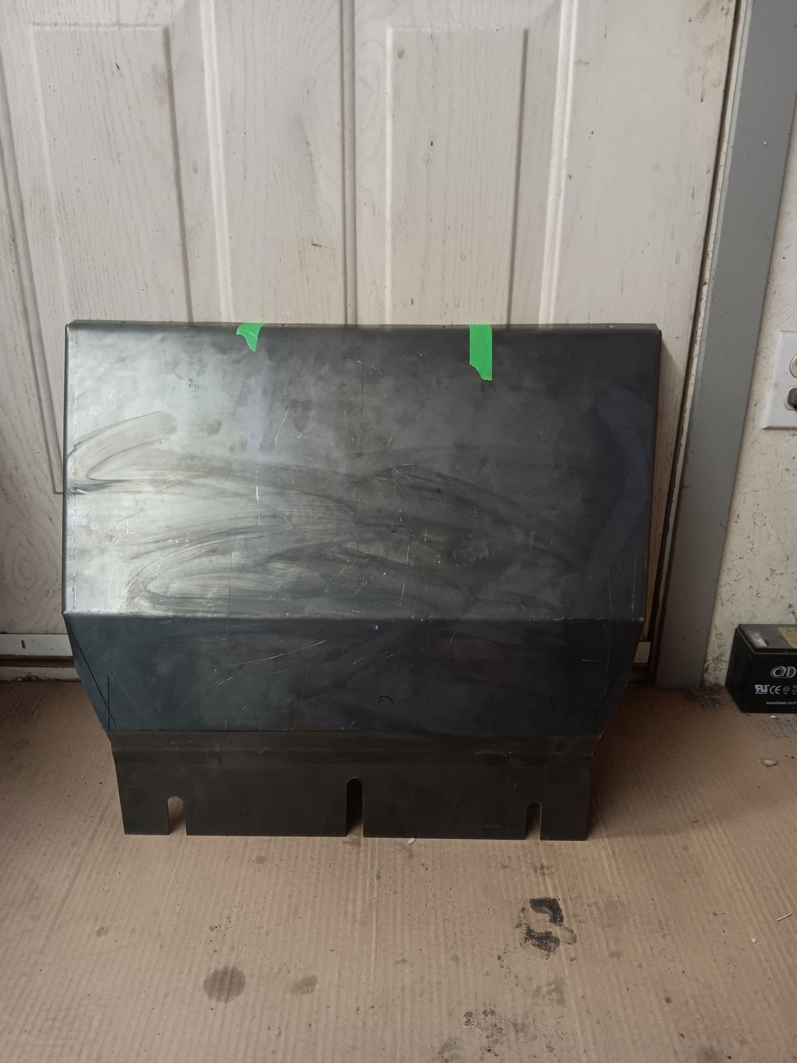

Skid plate powdercoated and installed. Will probably redo the front skid at some point as a second version would probably be much better.
Here are the rear springs, not sure how saggy they are. Re-arching is too expensive so my options appear to be to add another leaf from other springs. Will adding the main leaf from another Blazer pack give me an inch? Or should I try Chevy 63's? Or is it just trial and error at this point?
