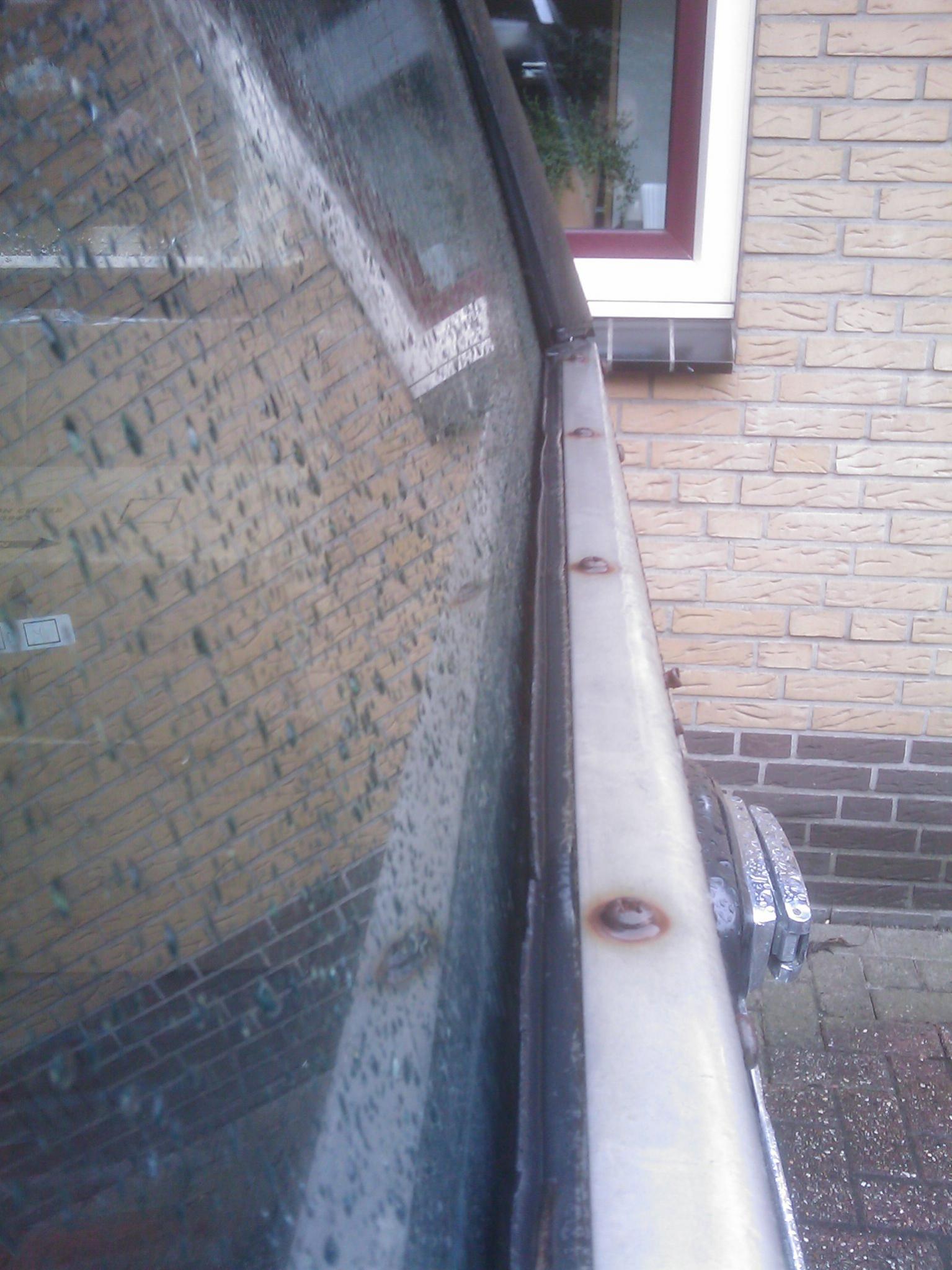

Just came back from the wash box. My tailgate weatherstrip is shot. I just finished geting the inside of the gate somehow dry again. I already found sone new ones but don't have time to pick em up. I'm gonna start polishing today. See how far i get and tomorrow the interior.

I just can fit the front end under my carport cause there is a door that's being painted in the way. So i got the front end done and i polished all the chrome.
I put 2 pic's in. One is front end polished and the other one my shot weatherstrip.

i hear ya on the tail gate weather strip, my 'Burb came from the sunny south, and it to is shot-and mine is 10 years younger than yours!
