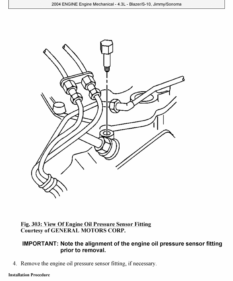

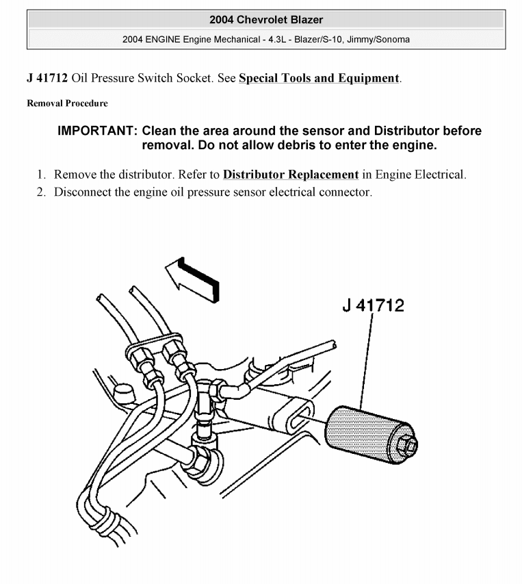

Well today the oil pressure gauge is at 0 when idle flashing the check gauge then at 20 with throttle. Checked the oil and its at its normal spot. But it appears under the engine I see oil (or something) dripping from about 6 different spots which is getting on the exhaust causing it to smoke and make my car smell like oil. Not sure where it could be leaking from... engine is too hot to check right now. Temps didn't go above 210 so not sure what happened yet... Just need to find the leak and hope I didn't break anything.

check the preassure sender ASAP, its next to the distributor on the back of the block

Its been a few days. It was indeed the oil pressure switch! Swapped that out and it stopped leaking. After messing everything else up... Cracked the distributor by tightening the screw too much so I had to glue that back, then found out it was out of time since I couldnt get it to line up with my mark no matter where the oil shaft was turned. So I pulled out the distributor and glued it again so it broke off again. Put engine on TDC (lined the marks and made sure piston was as high as it would get) then lined up the rotor with 6 and it started right up (After a couple backfires from mixed up spark plug wires). Anyhow. Yes, thats exactly what it was. Im so glad it wasnt something like the intake gasket.

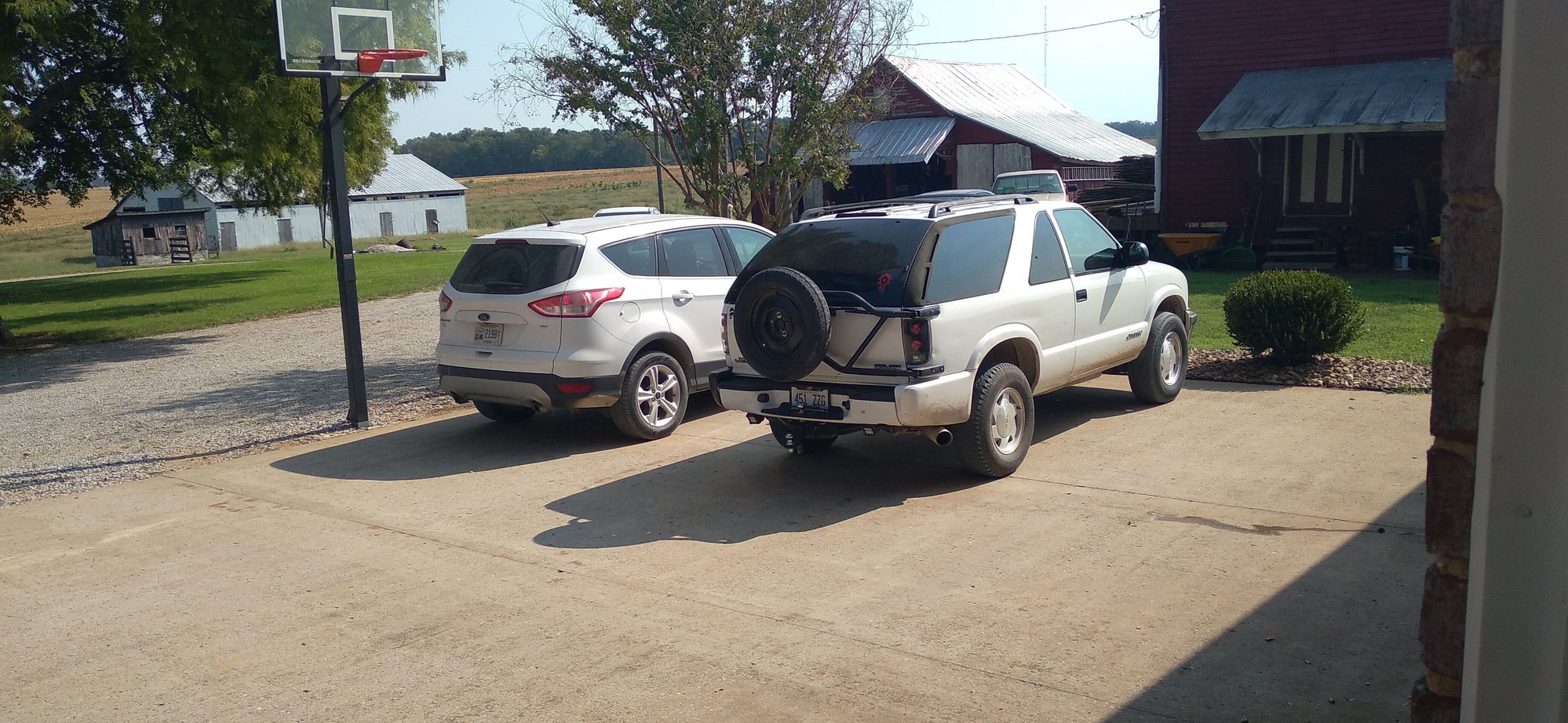

Besides the maintenance crap... I got my spare tire carrier installed and im loving how it looks. Just need a real rim. The spare looks bad.
Old Sep 10, 2020 | 08:54 PM
  #50
Did it come factory with one and taken off? Or did you have to drill and install, and was the mounting bolts on the inside already there?
