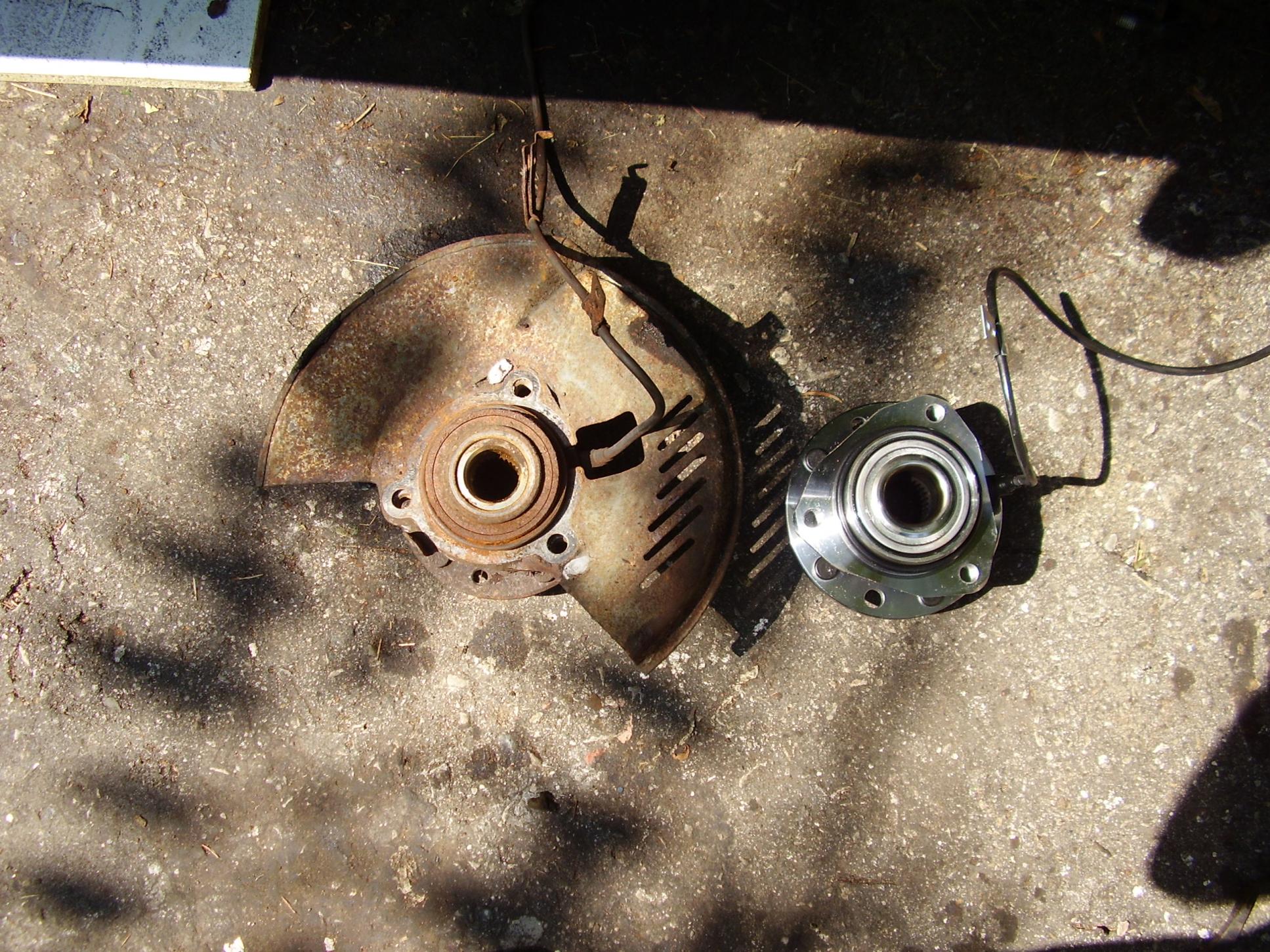

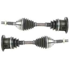

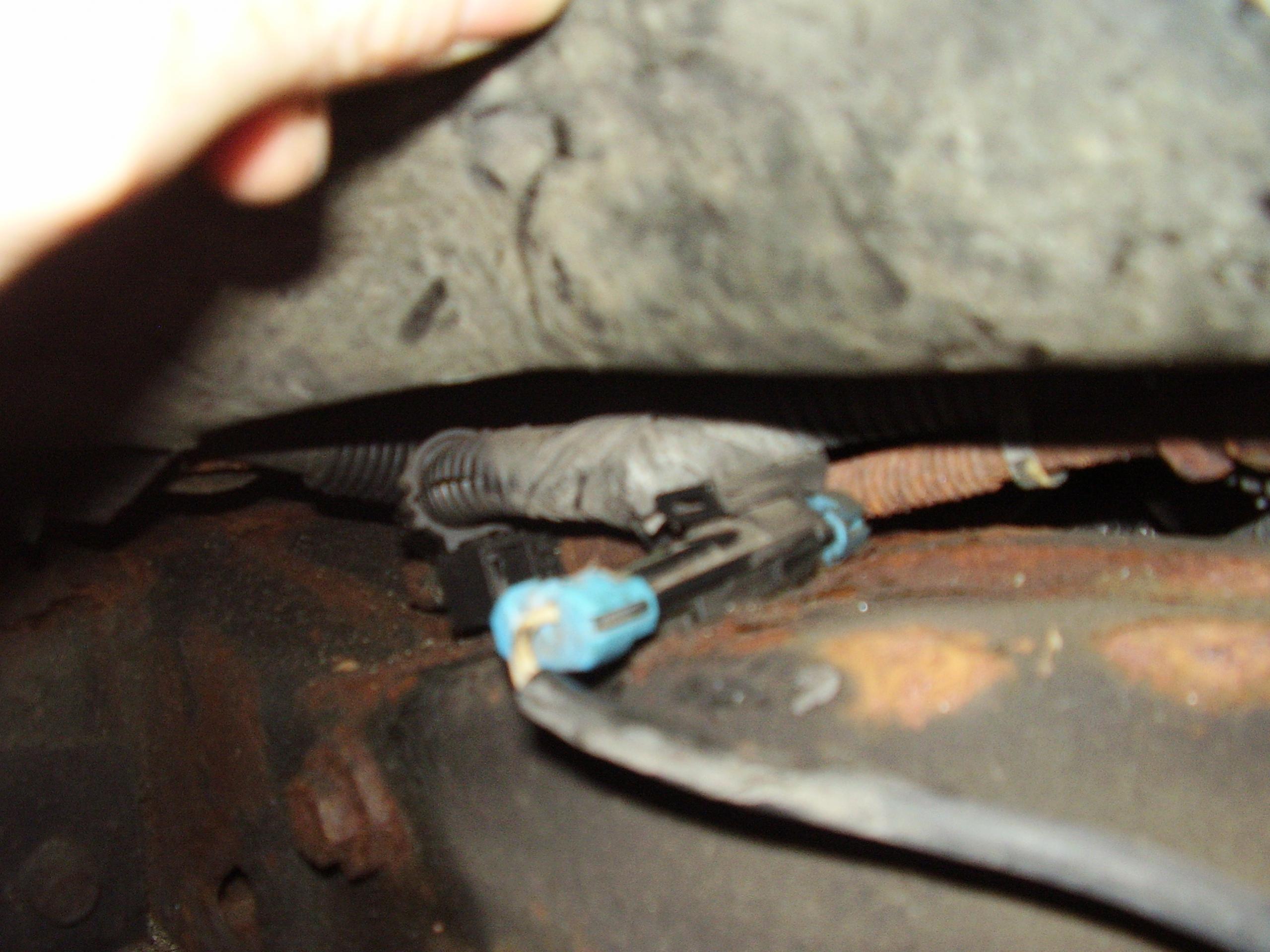

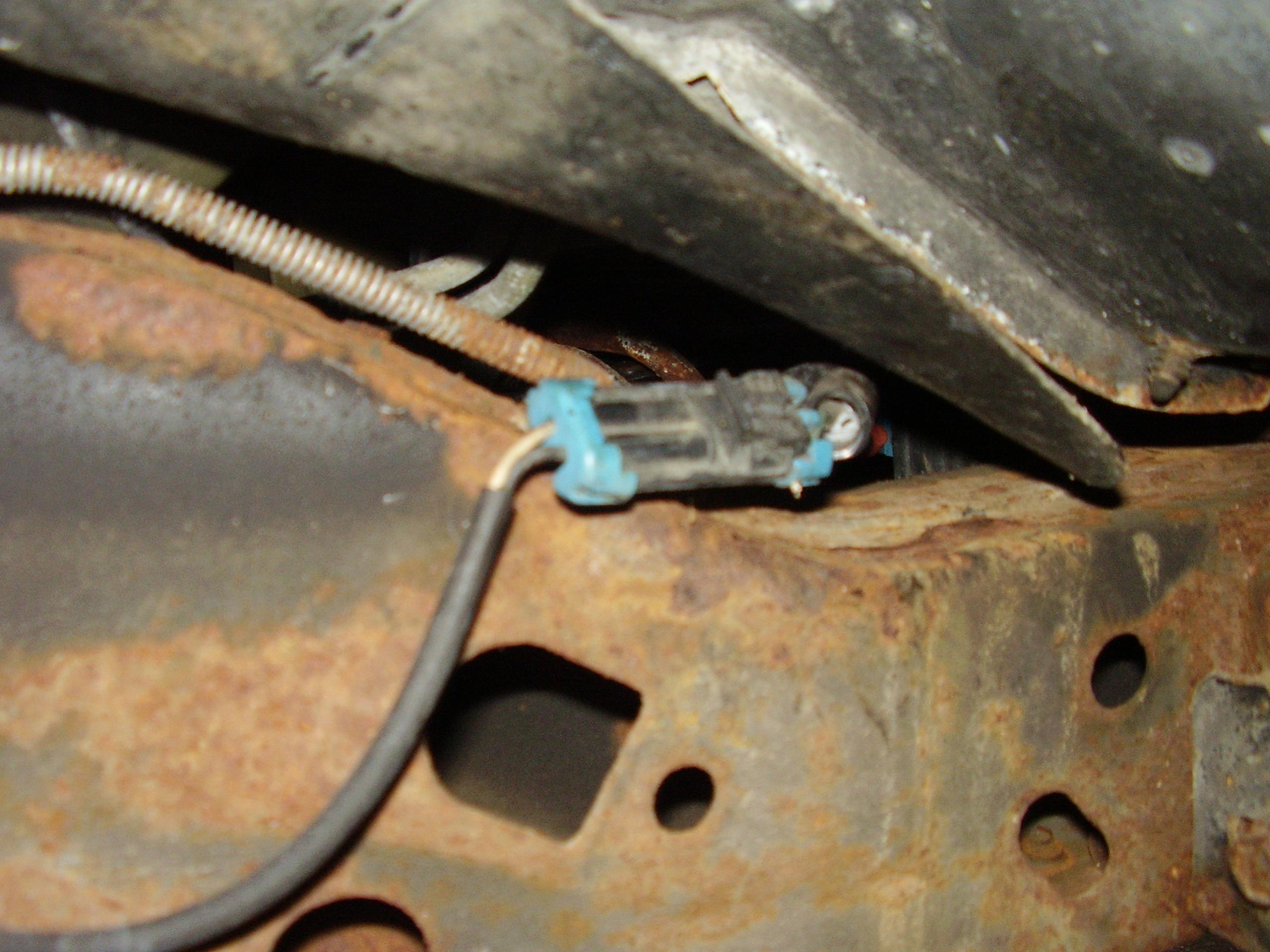

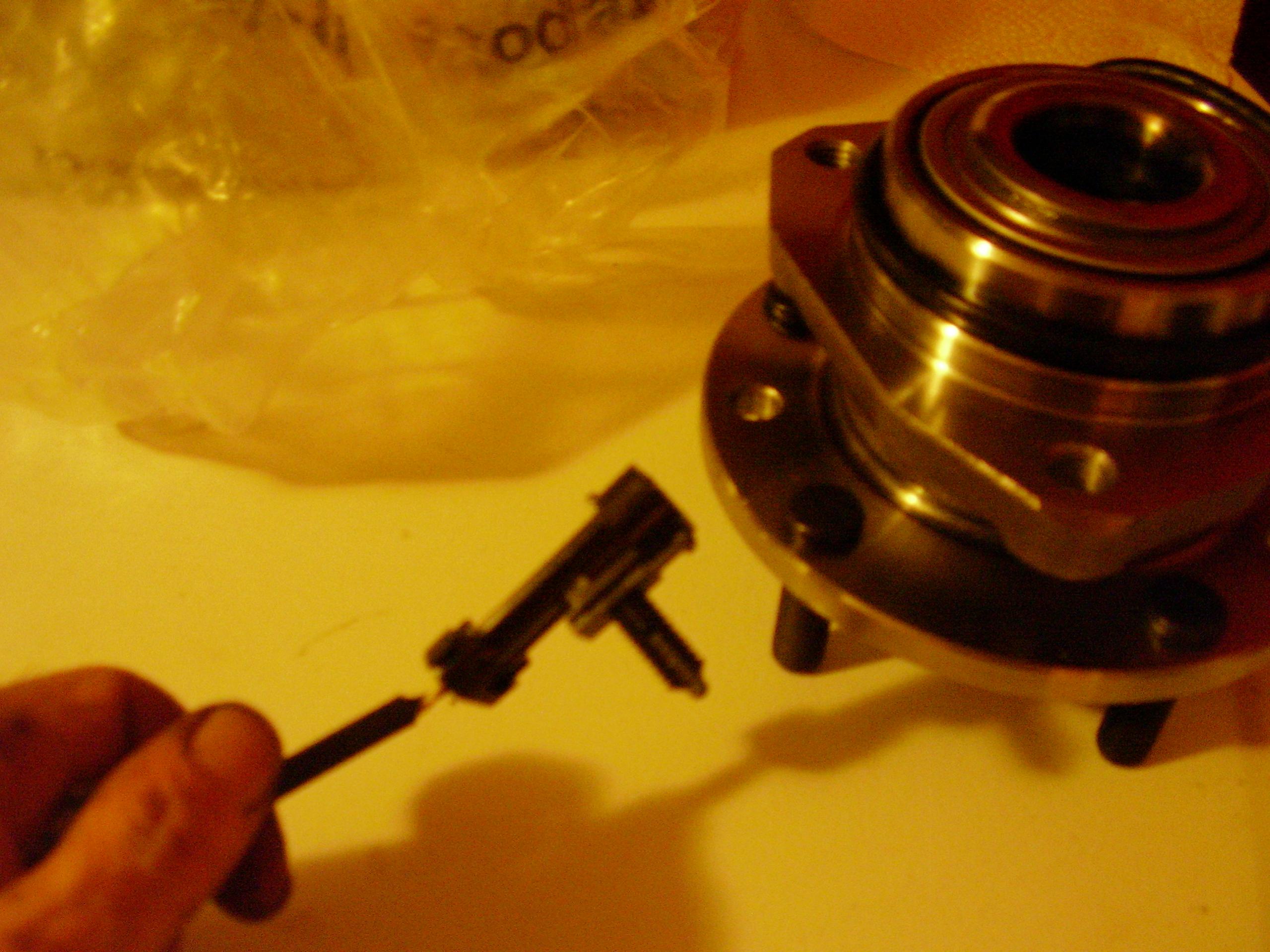

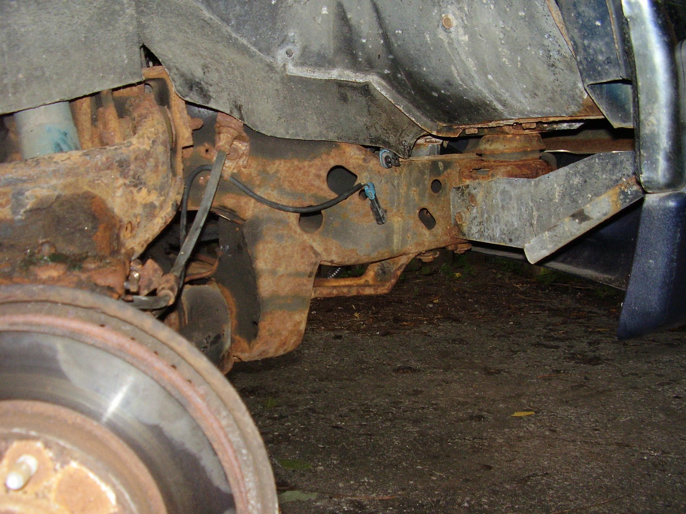

Originally Posted by b1heqh54
After a few phone calls, I found that we can buy remanufactured units by the thousands direct from Dearborn Axle in Warren MI. They cost me - are you ready for this!? $29.99 each. (to my door: no duty, no taxes, no brokerage fees)

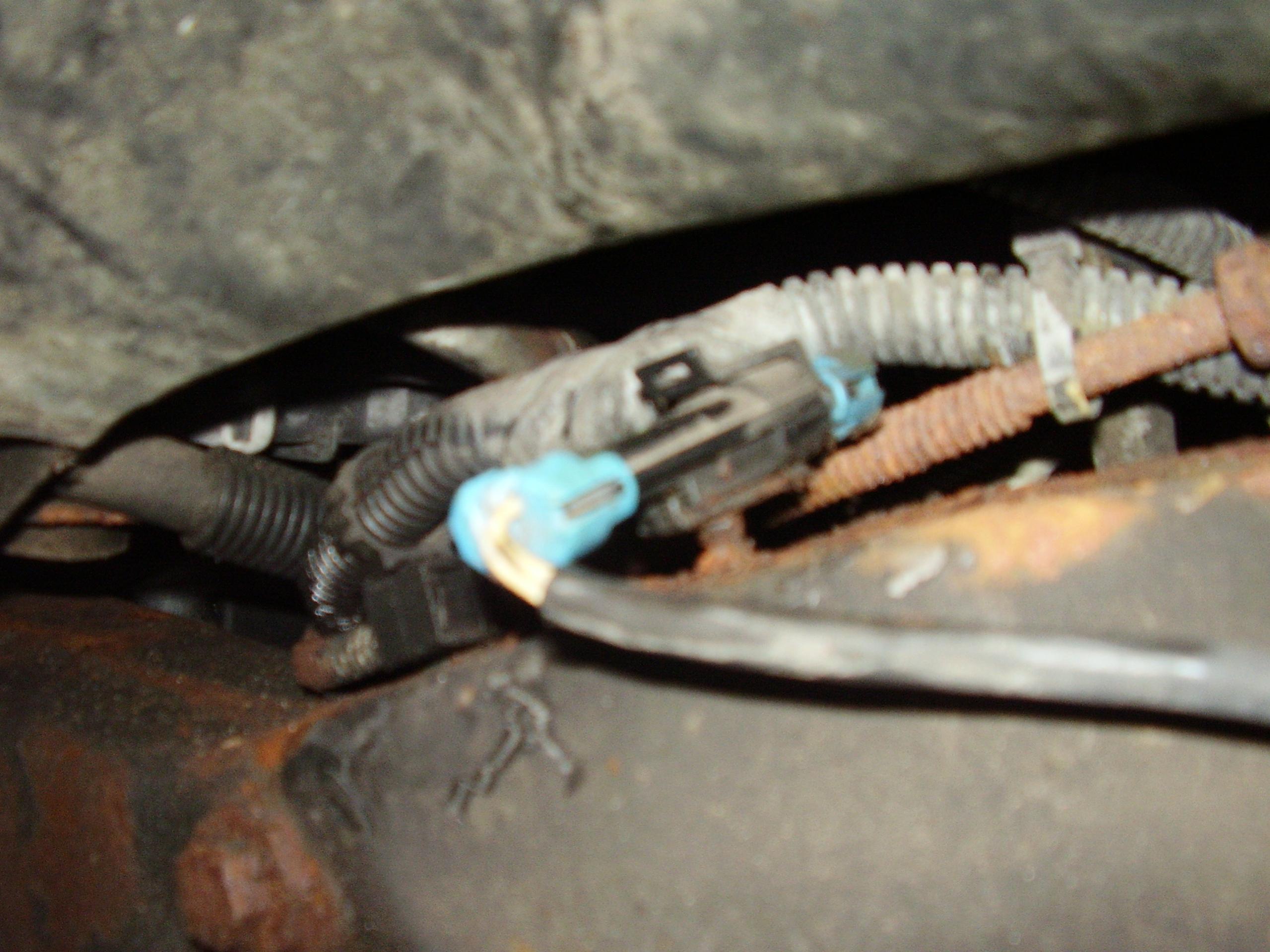

here's a tip - when unplugging the ABS sensor from the connector on the frame, pry it out of the hole in the frame first - the end that you are pulling on is the one that pushes into the frame
i sure wish i knew you could get them that cheap, a few weeks ago when i did my right hub. didn't pay retail, but it still cost me a big shiney penny!
i guess i got lucky with my plug when i did mine. i just lifted the tab with mt thumb, and pushed the truck side of the plug off, then i was able to slide the hub side of the plug off the frame clip. didn't break any of it, 'cause that's what always happens when i touch them.
mind you, i soon realized when i put the new one on, that it comes with a new frame clip!
