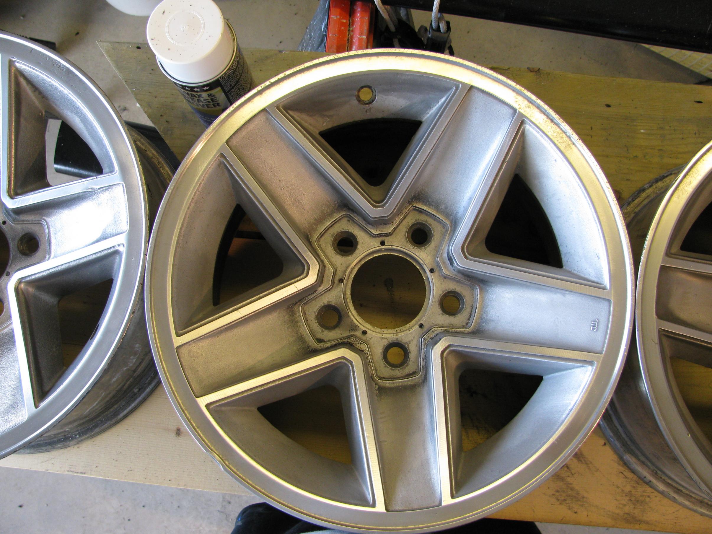

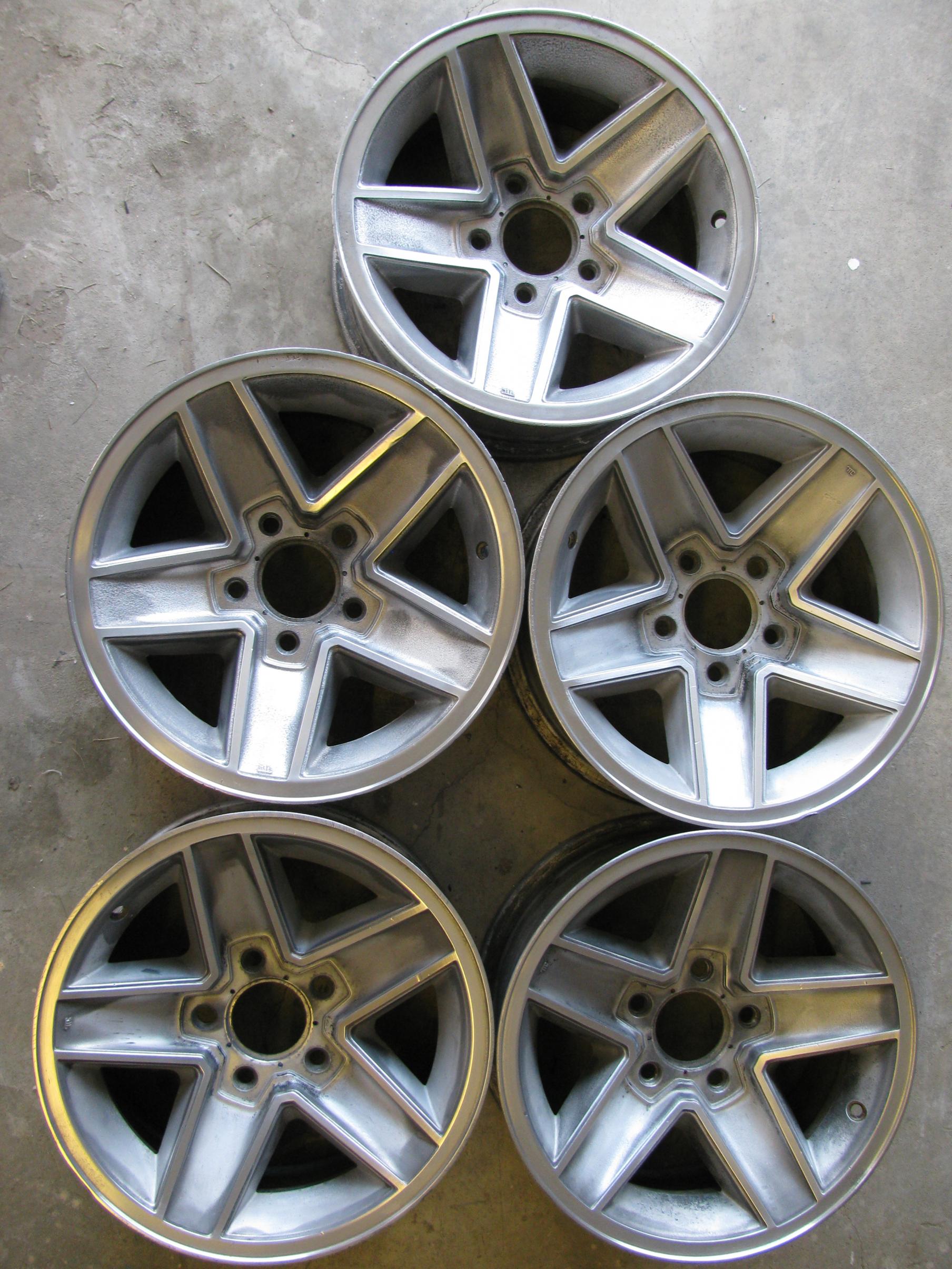

Well I finally have them prepped for paint pictures will be following as soon as I get them loaded to my comp. Tip for the interested the masking takes forever! But on another note here is a question for you all...When clear coating. should i just clear the painted area? or should I do the polished aluminum surface as well? Im leaning towards just the paint.
Old Aug 3, 2010 | 12:58 PM
ohsofly's Avatar
Posts: 1,534
From: Camrose AB... Canada
If its polished (looks like chrome) then you dont have to clear it.
But if its unpolished it will turn white in no time if you dont clear it.
Ive done lots of wheel restos in my days in the detail shops, and I would personally finish the wheels, get some of that spray on mask, spray the whole wheel, wash off the part you are going to paint, then paint it a few times.... then wash the whole wheel, THEN clearcoat the ****e out of them... The whole things. Make sure you use auto clearcoat as its UV resistant.
Its also easy to paint the whole wheel, clearcoat the whole wheel, then grab your grinder pads and buzz off the paint on the front then polish the surface to a shine.
The spraymask is what bodyshops use so they can be lazy and dont ahve to tape off a whole car just to paint a fender. It sprays on wet, dries fast, then washes off with water and takes the overspray with it.

Here are some pictures to hold you guys over till later on today...
Attached Thumbnails Z28 Rim Restoration-img_3275.jpg   Z28 Rim Restoration-img_3280.jpg
