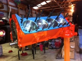

Believe me, I know quite a bit about building motors. I assembled and turned every nut and bolt on this motor. Been building motors for 30 years, everything from stock rebuilds to 6-800 hp motors without any power adders like NOS or Turbo's. I'm pushing about 575hp with this 389" (4.060 bore x 3.75" stroke) on 5.7" rods and full floating forged pistons.
[IMG][/IMG]
