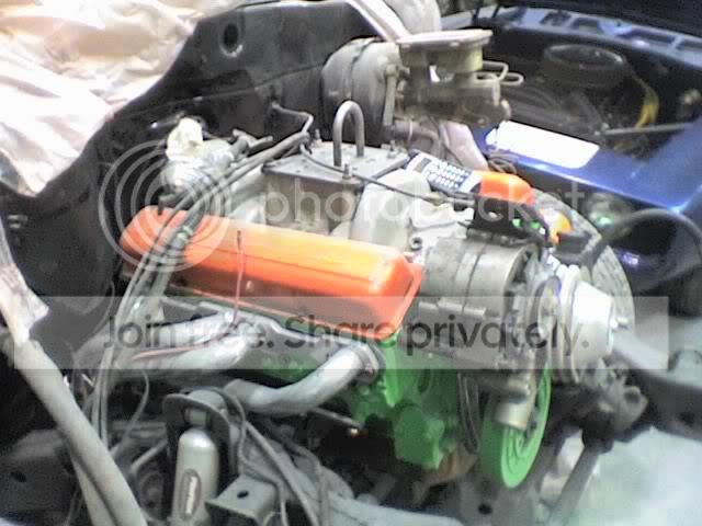

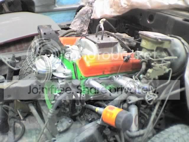

hey so i found a bracket that would work for my power steering pump but i was having lots of problems with the alt. i finally found out wat the problem was, i was using a short water pump and the shorty doesnt have bolt holes where they needed to be so i switched it to a long pump and sure enough the bracket that i had for my alt basically fits! i say basically because there is one arm of the bracket that needs to be bolted into the intake, but my intake is different than the one on the vehiclethat the bracket came off of but it will be a decently easy fix
so enough talking heres some pics

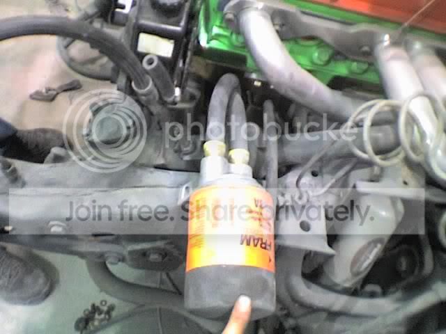

remote oil filter system
