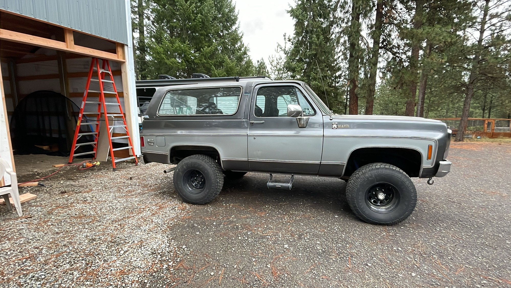

Hello, I have a 1980 K5 with a 1993 GM factory replacement engine. it doesn't have the power I think it should. I did a compression test on each cylinder, and they all have 120-122 PSI. not the best, but it does run well, just lacks power. I put some oil in one of the cylinders and the PSI came up to 140-145 PSI. much closer to a strong engine. I know the rings are getting worn. I plan to pull the engine, get some better heads, put a "RV" cam and now will re-ring and change out the bearings. I am going to check for ****s and giggles the gear ratio? It may be a combo of a weaker engine, and high gears. I will document the progression here. the engine that in it is a 4 bolts main, solid 350, so I have a great starting point. picture for reference... and who doesn't like pictures of a square body blazer!!!

The "Oil In The Cylinders Test" says the engine's tired. It appears to me (I'm making an extension in logic here) that it's not an individual or pair of cylinders as you reported they are all pretty close and came up rather equally from dry to oiled.
With that last line, I double-down on a tired engine.
What size are those tires? They look like 37s --- no? That can contribute to a bad seat-of-the-pants feeling of a weak engine, especially coupled with stock gears.

I have 33's on it. I am going to check the gears before doing anything drastic. good info on all that you have done. I just want a good running strong blazer. good looking rig you have there. I totally agree on the Vortex engine swap. they are perfect for what I want, I just don't know if I want to do that yet.

Stay with the stock gears for now and I'd dump the 33s --- I had them and they'd sure-as-hell get me stuck a lot!
Now I'm running 245/75R16 LT and I won't ever go back to big fats at all.
