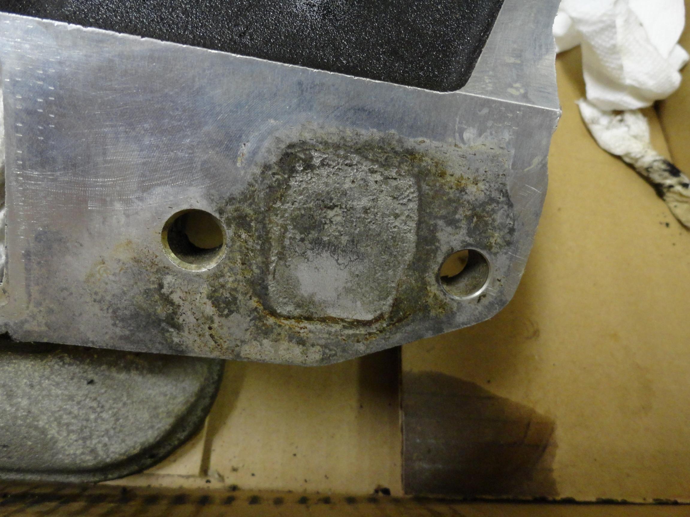

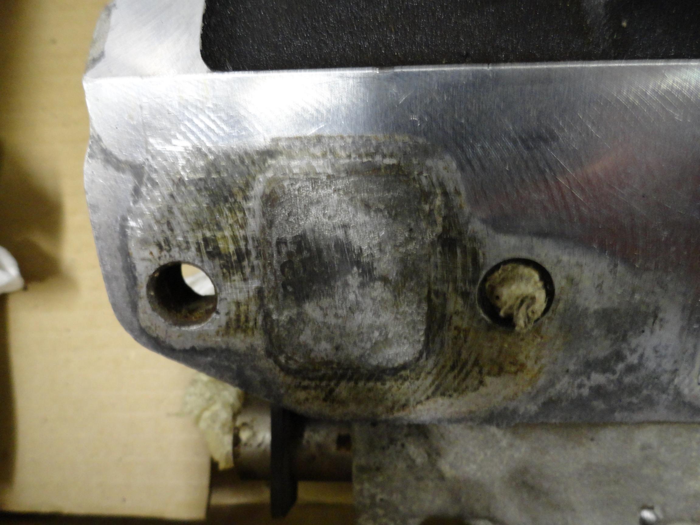

I have a feeling I may need to use some rtv around some of the coolant passages because of the amount of corrosion and pitting on the manifold. Not sure if that is a good or bad idea but that was my first thought on how to get things to seal back up.
I will post some pics of the manifold later tonight.

Lots of corrosion....

I've seen worse - felpros should seal it - if worried light coat of RTV, I perfer dry - you wasn't gettin much water flow tho, good luck with cleaning all that out - looks like a gel type stop leak was used or was that a paper towel - lol

Ok, thanks. A guy at work said he thinks he has some of the 3m bristle discs so I will probably borrow the fine one and try to clean things up a little better. Still think I will be putting some rtv on there just to make sure. I don't want to be doing this again any time soon.
Those are just paper towels, I never put any stop leak in there. Don't trust the stuff and don't want to deal with the potential aftermath.
