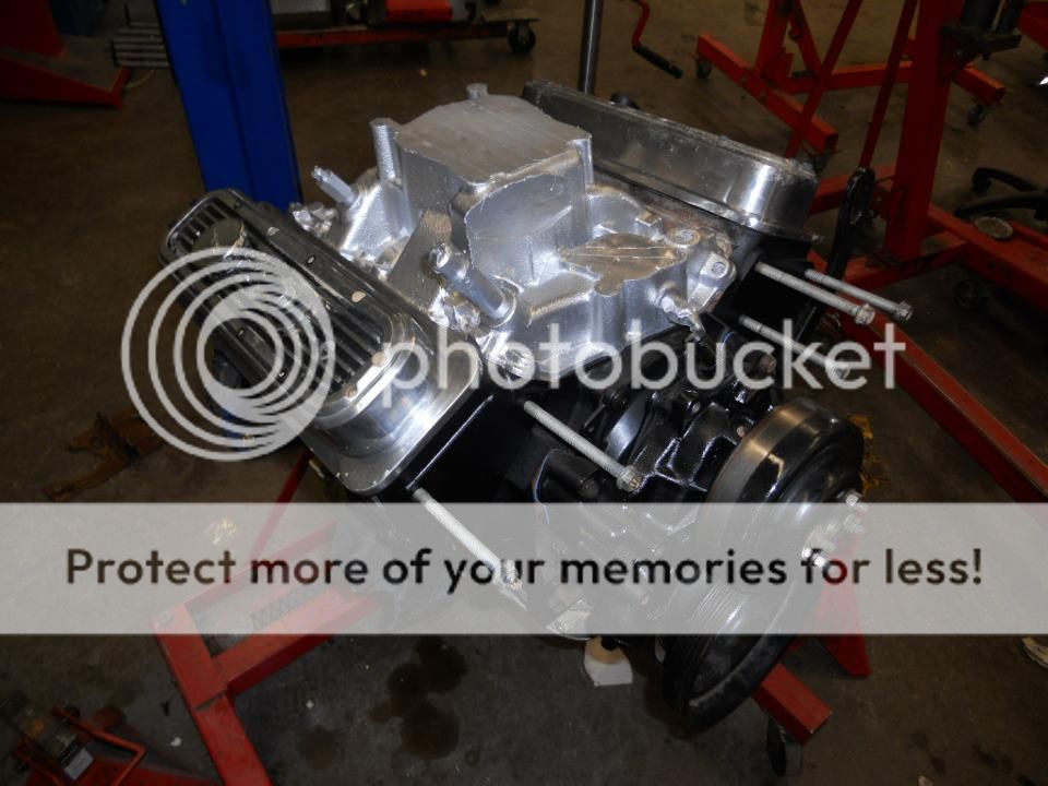

i started off with a 1995 blue 4dr blazer with a carb set up not tbi yes carb a quadrajet. i got stuck in a mud hole and spun two main bearings
so i took a short block from my auto teacher and everything went good but we had to make a custom oil pick up beacuse i guess i got the worng oil pan and it was too shallow
everything went good and when we went to start it it blow a rear main seal so i fixxed that and still blow it so after a total of 3 seals and trying to find the cause i gave up

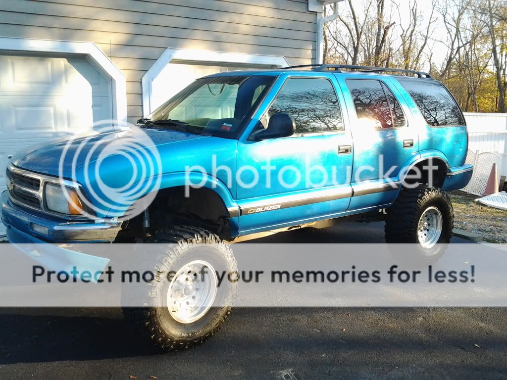

i bought a new balzer 1997 black 2dr 5 speed blazer and started building this one up

I would do the black one and sell me the blue one cause I have a engine to put in it. from a 96 that was just wrecked. I hope your on Long Island or near me...In matter of fact you look rich enough to just give me the blue one. Now let me give you an idea why you kept blowing the rear main. Check the oil pump relief valve. and plastiguage the crank bearings to see what clearance you have. also check the crank where the seal rides for any sharp protruding pieces or even small depressions. I'm giving you the benefit of doubt you are putting the rear main seal in the right way.
If you do decide to fix it put a oil pressure gage on it to check oil pressure when you get it running. To blow 3 rear seals something is not being put together right, something is ripping the seal or something is causing excessive pressure.
The only times I have run into this is with pressure relief valves not working , or when I would build dry sump systems for engines. In my time it has only been 3 engines I had that happen on. one was the mechanic who did it kept messing the wick seal. The others were a machine shop error.
By the way that is a sweet looking black Blazer. Really fix it up and keep the engine in it

ive doone everything youve said but the oil pump relief valve
just it not even 3 seconds on crack before the seal blows the lip on the seal inverts
