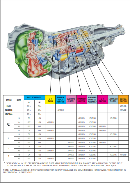

You - as an engineer - might like to see the flow chart of the elements in use at certain times of operation of your transmission.
Lemme look for that chart and I'll hold the reply "OPEN" until I find it and post it to you - I promise.
This should be self-explanatory.

Pay attention to the "CONDITIONS A HUMAN MIGHT SET" concerning the legal and ill-legal use of the quadrant <shifter> to play with the transmission.
When you MANUALLY shift into the different ranges, it "calls" different clutches and/or band progressions - especially on the aptly baked-in gear changes that do or don't happen in 2nd/Intermediate!
This can baffle some people as that calibration is NOYT in all makes and models of GM rolling stuff.
Beware!

More EDITING for you: This point focuses on the specific hydraulic hurdles that cause a Neutral-in-4th condition even when 2nd gear feels fine:
4L60-E "Ghost 4th" Diagnostic Logic:
  • The 3-4 Shift Command: Note on the Logic Chart that for 4th gear, Solenoid B must turn OFF. If the solenoid sticks ON or the valve hangs, you stay in 3rd.
  • The Servo "Piggyback": The 4th gear application uses a separate piston within the servo assembly. 2nd gear can work perfectly because it uses the larger outer piston area, but if the 4th-apply piston seals are shot, 4th gear will simply fail to apply the band, resulting in "Neutral."
  • 3-4 Clutch Hold: The 3-4 clutch must stay applied during the shift to 4th. If it's slipping (evidenced by your "black sludge"), the transition to 4th will feel like a complete disconnect because the band never grabs to take over the load.
  • AFL Valve Wear: An engineer should check the Actuator Feed Limit (AFL) valve. If that bore is worn, it drops the pressure fed to the solenoids; they might have enough "grunt" to move at low speeds but fail to hold the logic when line pressure demands are high in 4th.
Have a nice day --- this isn't as exasperating as it seems; the logic-flow is priceless and I suggest you copy/paste these massive scripts I've shot into here (to other sites too - I am retired, not DD&B) and they will either warm you if you make hard copies of make you angry (and therefor burning more calories) and you can use the personal extra BTUs for the rest of this ugly winter.
