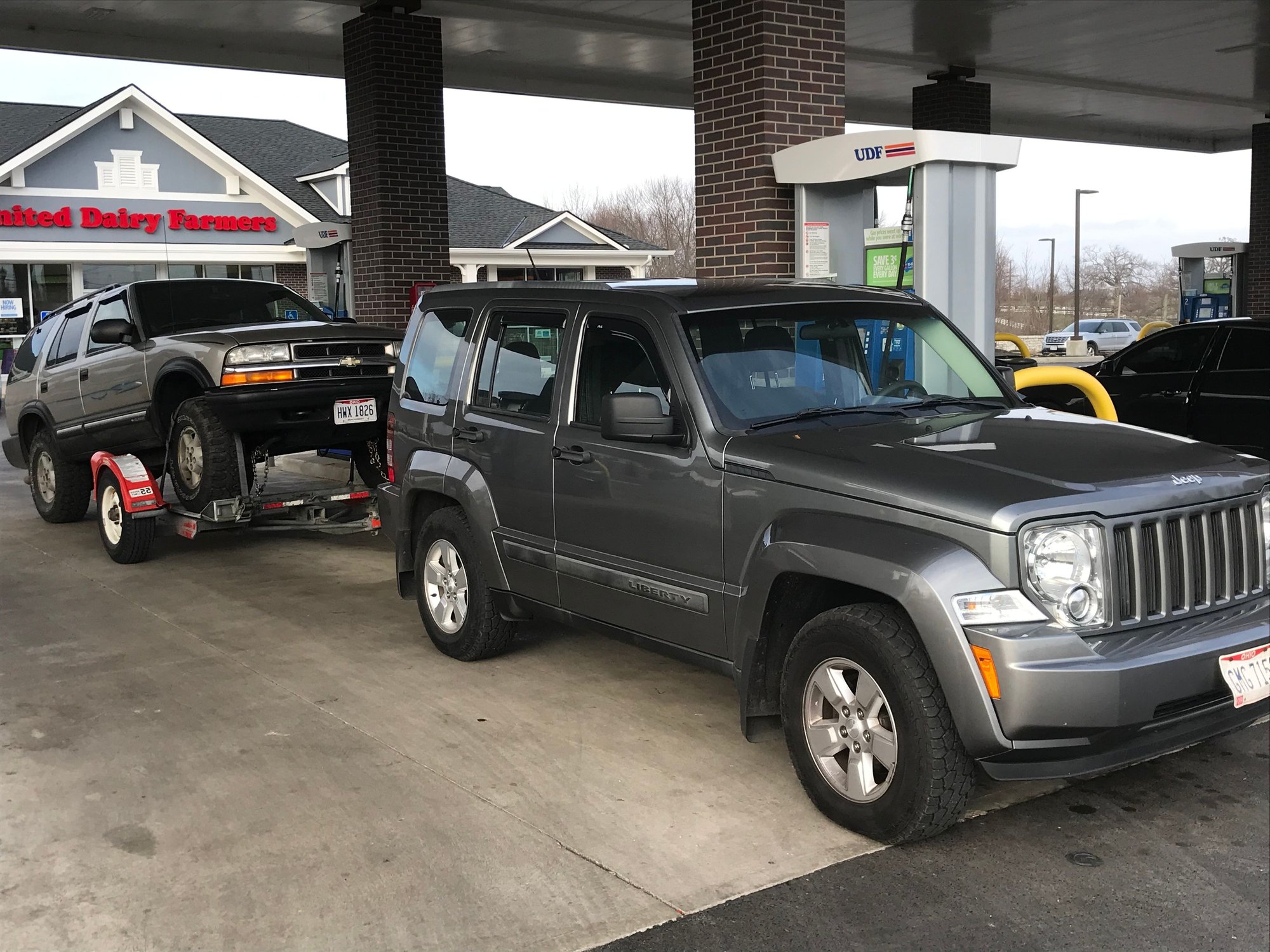

So late last fall my kid ran his Blazer out of coolant and blew the engine. After we dollied it home it did start and blow lots of white smoke and would not come off idle.
