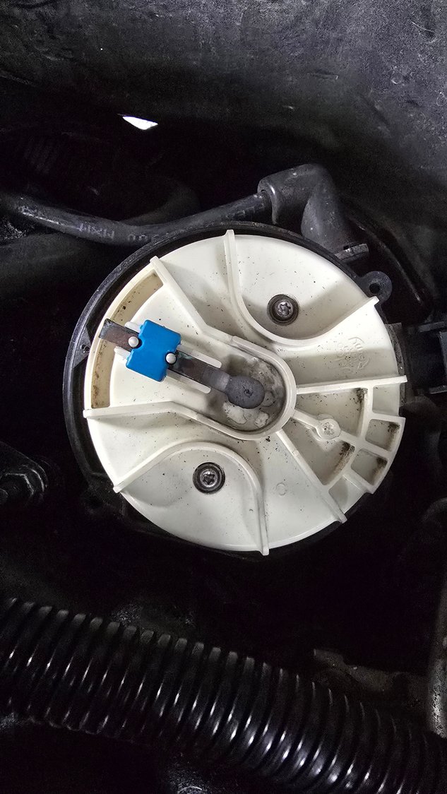

Removed the cap and rotor to ensure everything was done correctly and it was as both components only fit 1 way. Refitted the old cam sensor still nothing. Checked to make sure everything was plugged in that I had disturbed and again all ok.

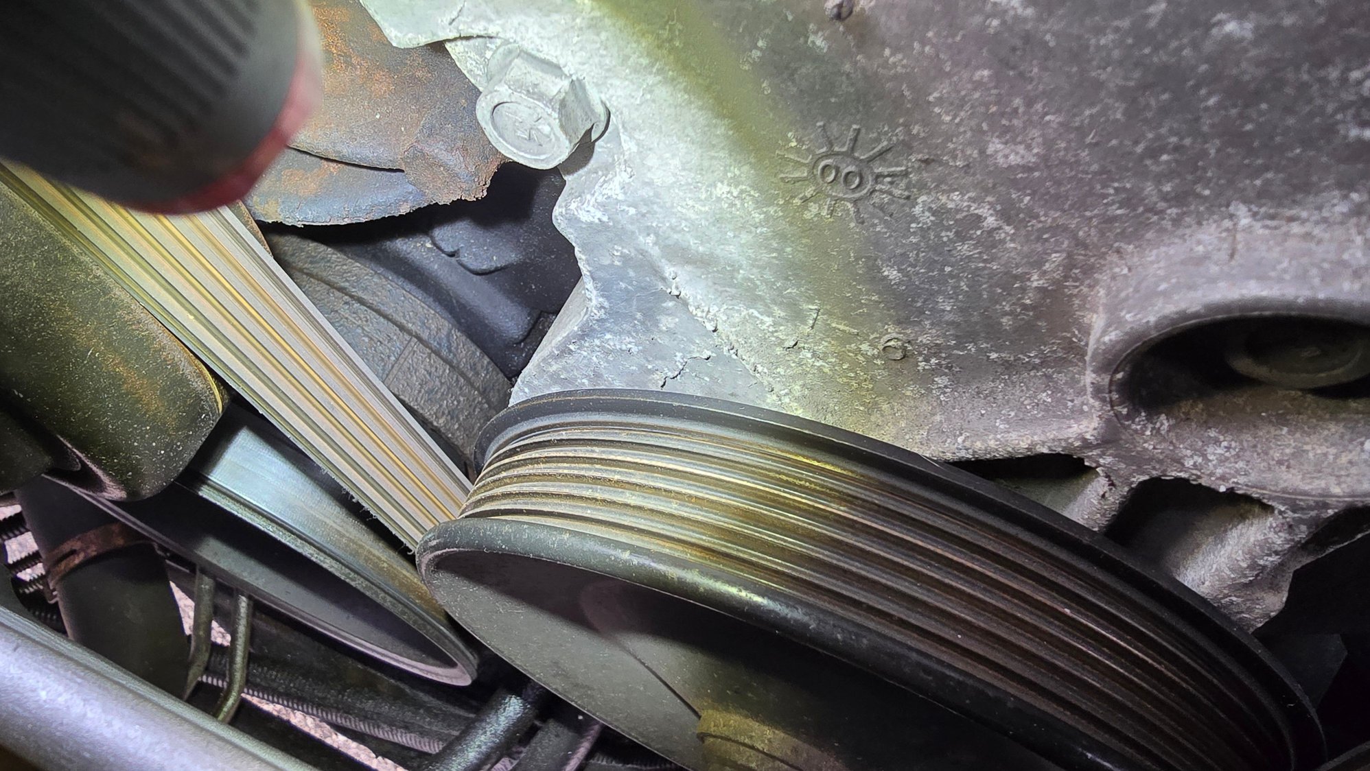

Checked the timing rotating the engine by hand to the 2nd mark on the crank pulley and the rotor arm lines up with the no. 6 mark on the distributor.

I have removed the distributor cap and cranked the engine and the rotor arm turns clockwise smoothly without stopping at any point which should rule out a worn distributor gear though I haven't pulled the distributor to check yet.

4, Possibly but unlikely as I didn't remove or unbolt the distributor at all though I did have to turn the engine over by hand to remove the cam sensor so if the gear was worn maybe it slipped. That said the distributor rotor lines up with the no.6 mark on the distributor when the 2nd mark on the crank pulley is lined up with the line on the block. I have also never touched or adjusted the distributor on this truck and there is not side to side play, it is held down firm and in place with the factory clamp.

  2. On these older trucks the rubber damping ring can slip on the flywheel so that alignment can be ubnreliable

2, I did read a post about that crank issue but I've yet to pull it off to check, I wanted to go down as many other avenues as possible with the hope of rectifying the problem before removing components which could potentially lead to other issues but it is something worth checking.

5.1 ill check the timing again by lining everything up and checking for tdc through spark plug no.1s bore and let you know the results.

So i checked the timing again and it does indeed seem to be a tooth out.
Strange as when I checked it last time I could've sworn everything lined up correctly but maybe I need to go and get my eyes tested lol!

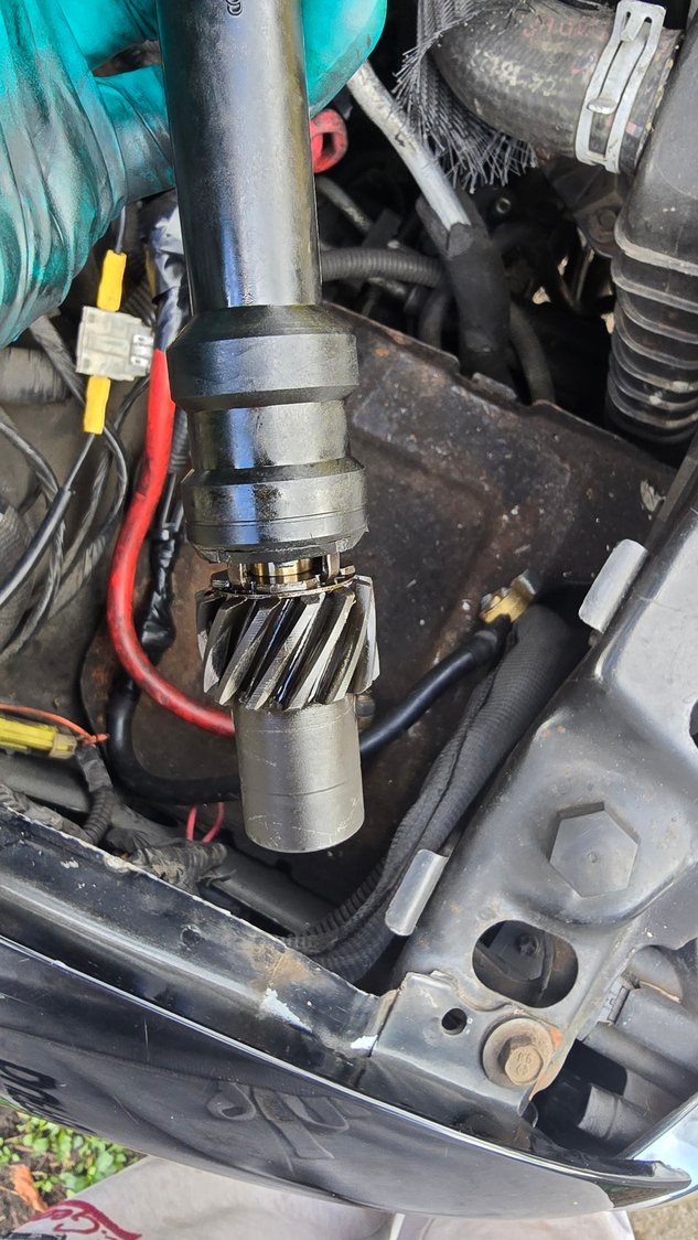

Looks like I'll have to pull the distributor and inspect the gear for wear before reinstalling it in the correct orientation.

Didn't have time to work on her til today but I pulled the distributor and set it to tdc and she fired up straight away.
Thanks for your help I really appreciate it!
Doesn't seem to be any wear on the gear so I've got no idea how it jumped a tooth. Must've been something I did i guess.
Also a little tip for anyone trying to line up the oil pump if you turn the distributor to where it needs to be before you remove it, then remove the distributor and turn the engine to tdc it will drop straight in without having to mess about trying to get a flatblade down there to line it up.
