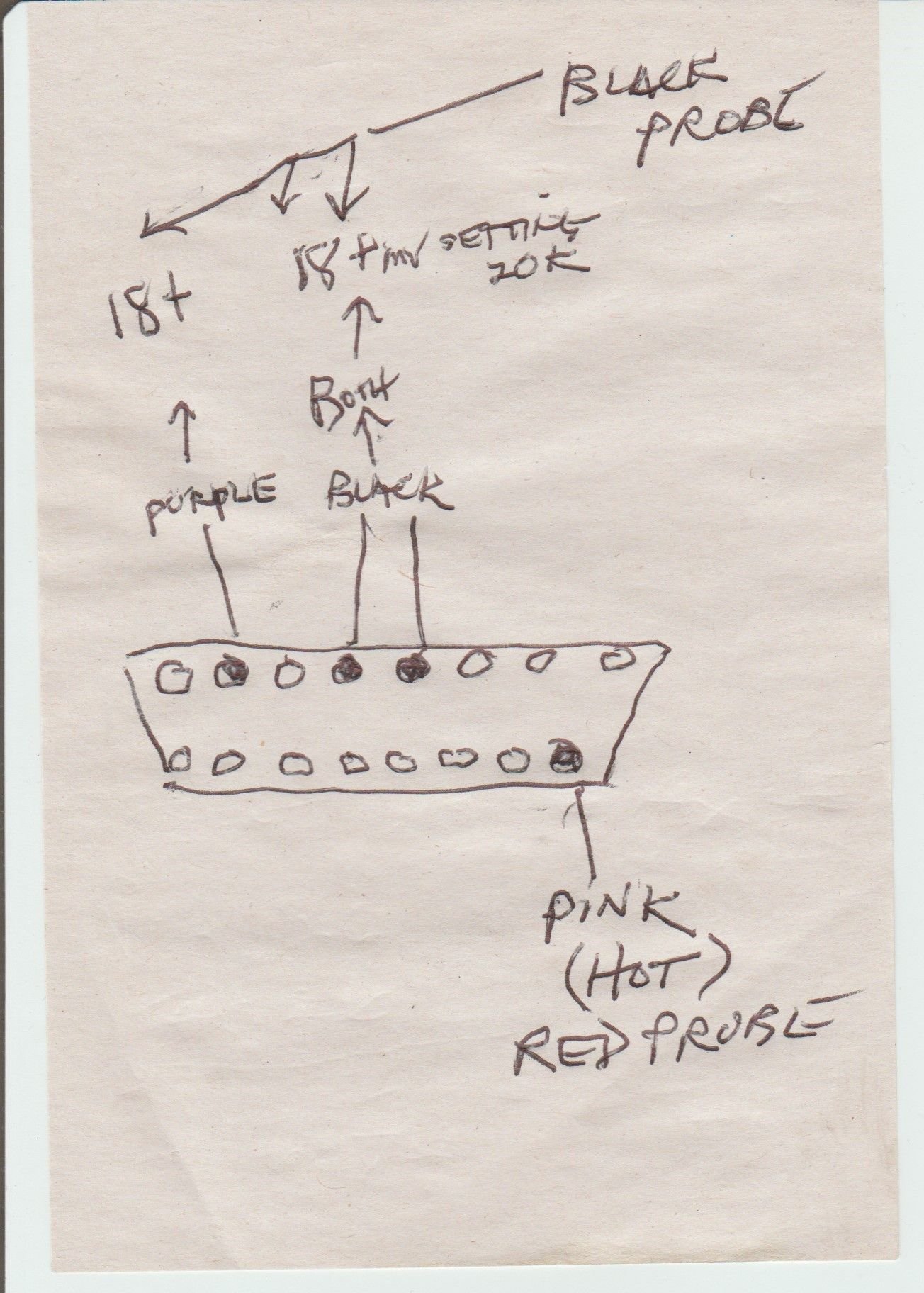

The latest discovery, important! (See diagram attached) Battery disconnected, waited to discharge, 20 minutes or so, under dash multimeter set to 20k ohms with red lead to red wire connect, black lead to each of the other pinouts. Ohms kept rising steadily past 18.99+, then to "1', OPEN CIRCUIT??? ANYTHING HERE, WITH THIS DATA?

... The valves should be steel, not plastic, just what is on the front of the manifolds on your truck?
Also, that seems like the Retained accesory power circuit turning itself off, the diagram you tried to post did not render//

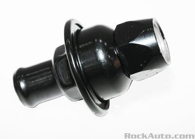

CA emissions is just the K18 Smog/Electronic Reaction Air Pump which is located to the front passenger side of the engine bay underneath the core support. it runs two hoses from a vacuum controlled diverter valve to two large steel checkvalves on the front of each manifold, those valves keep the exhaust gases in and prevent them from backflowing into the rubber hoses and into the pump. EGR is standard equipment on all trucks both Federal and California emissions.
Anyways, what connector did you backprobe? that looks like the Datalink connector under the dashboard..

Thanks will check, manifold fronts for these valves and yes that is the data link, seemed a bit off there after I let the battery discharge. Does the ecu keep reserve power, a battery backup, capacitor or such? Sorry for all these questions, here! So glad to have someone to "bounce" all these things to. I say you cleaned those "spacers" at the check valve. Regards!

the majority of electronics in our trucks and any with some sort of computers in them have a metric ton of capacitors which depending on circuit will discharge their stored energy over varying rates. I have to ask why you were probing the DL Connector as this was initially a P0300 Chase, unless it was to check for voltage drop - as that is not how you test voltage drop
start the truck, take a multimeter and then connect one lead to battery positive, other to negative, note the voltage, then move negative lead to a frame ground, then a body ground, and note the net change between battery voltage when using battery ground, frame ground, and body ground, do NOT move the positive lead at all.

Attached my scanners, in a few minutes, drained battery to a no start. That's what made me suspect at the data link. measured voltage at battery, then to frame, before. No apparent change. Bought a check valve, install tomorrow. Will post results.
