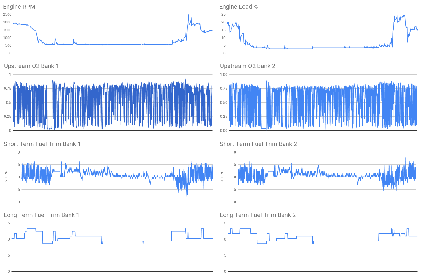

Here we have some data I've collected with the Torque app.
As you can see, the engine stays lean no matter the RPM. This is my first clue that this is going to be a fuel delivery issue. Still, I decided to check for a vacuum leak just in case and it's usually the easiest thing to find. So I got my propane torch and a length of rubber hose and hosed propane all over the well known vacuum leak spots. Around the intake plenum, around the lower in-take gasket, checked the vacuum hoses and pinched off the brake booster. No change or blips on fuel trim data. I decided to use a spray bottle full of water just to double check a few areas and still no change.

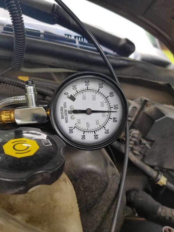

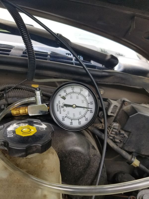

I replaced the fuel filter last year as part of some routine PM. I hooked a fuel pressure gauge to the schrader valve next to the distributor. With the engine off, I cycled the pump on/off a couple of times to get my fuel pressure.
With the pump running engine off I get about 59 PSI.
With the engine running I get about 56 PSI.
And with the engine off after running, I hold about 53 psi for at least 10 minutes.
So this is about where I'm at. I've read on here the fuel pressure should be around 60-66 psi. Since I'm not leaking down, I feel this is going to be a fuel pump issue and not an injector/regulator issue.

Any idea on how I can further test to narrow down if it's injectors or fuel pump would be greatly appreciated.

The O2 sensor voltages are in the first post.
I've been reading fuel trims should be between -4% and +4%. As you can see in the first post my long terms will near 12%.

actually I like what you have shown in your first post and don't consider it a waste of time at all. Yes, your FI system is adding 10% to factory calibration on LT fuel trim but it is effectively adjusting the fuel mix to where it should be. Short term FT is near zero and O2 sensor voltage is cycling across 0.45V. I believe the addition of LT and ST fuel trims is supposed to be10-12 or less. Unless you have a performance problem or SES light on, I really don't think you have a problem.

Thanks for the reply! This is really just me trying to find what is going to break next. Really didn't want to change a fuel pump on the side of the road. If you say I don't have a problem I'll gladly stop trying to chase one. Thanks again!
