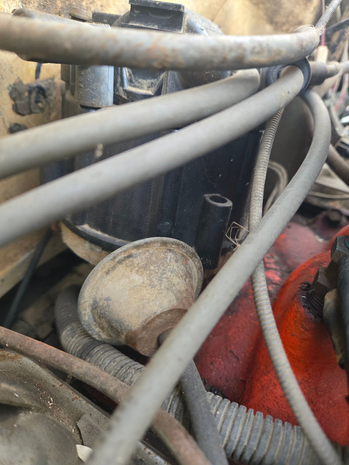

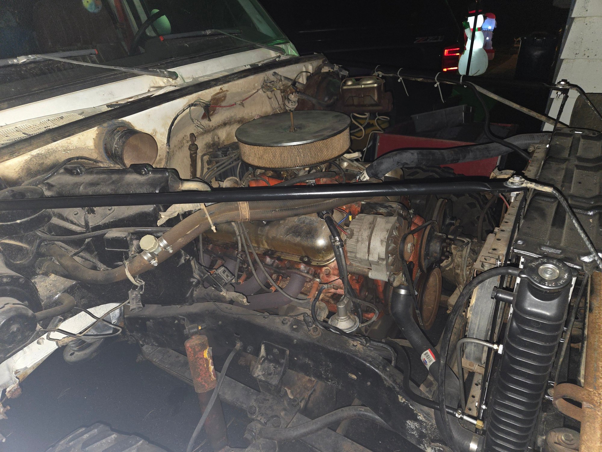

working on a new to me '78 K5. it has a 396, 325hp out of a 68 or 69 chevelle.
i am wanting to replace the HEI distributor with a like replacement. i do not know what cam is in it. it used to have a highrise intake and nitrous. it was used as a racing/mud truck in the 80s and 90s and has sat since then. it currently has a delco remmy HEI. has a TH350 trans.
any recommendations for a replacement? i am not mudding or racing, just a daily driver with a partial restoration.

Since no 396 ever came with a factory HEI distributor (only points distributor) the one you are replacing is not a factory correct part. Might as well go with a generic mid-priced Performance HEI distributor (they are all Chinese, including MSD). You can map current advance curve and play with it with springs and weights to suit your needs - or just drop it in and run it as-is like most will do.
If this has a serious race engine with a roller cam, you will need a bronze distributor gear. But I think that is highly unlikely.

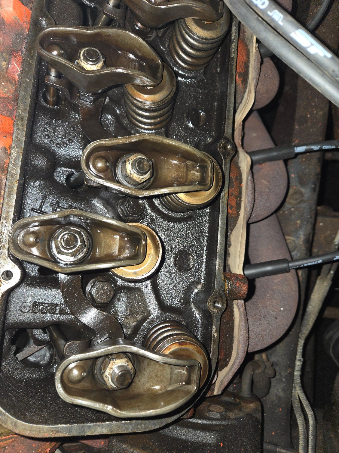

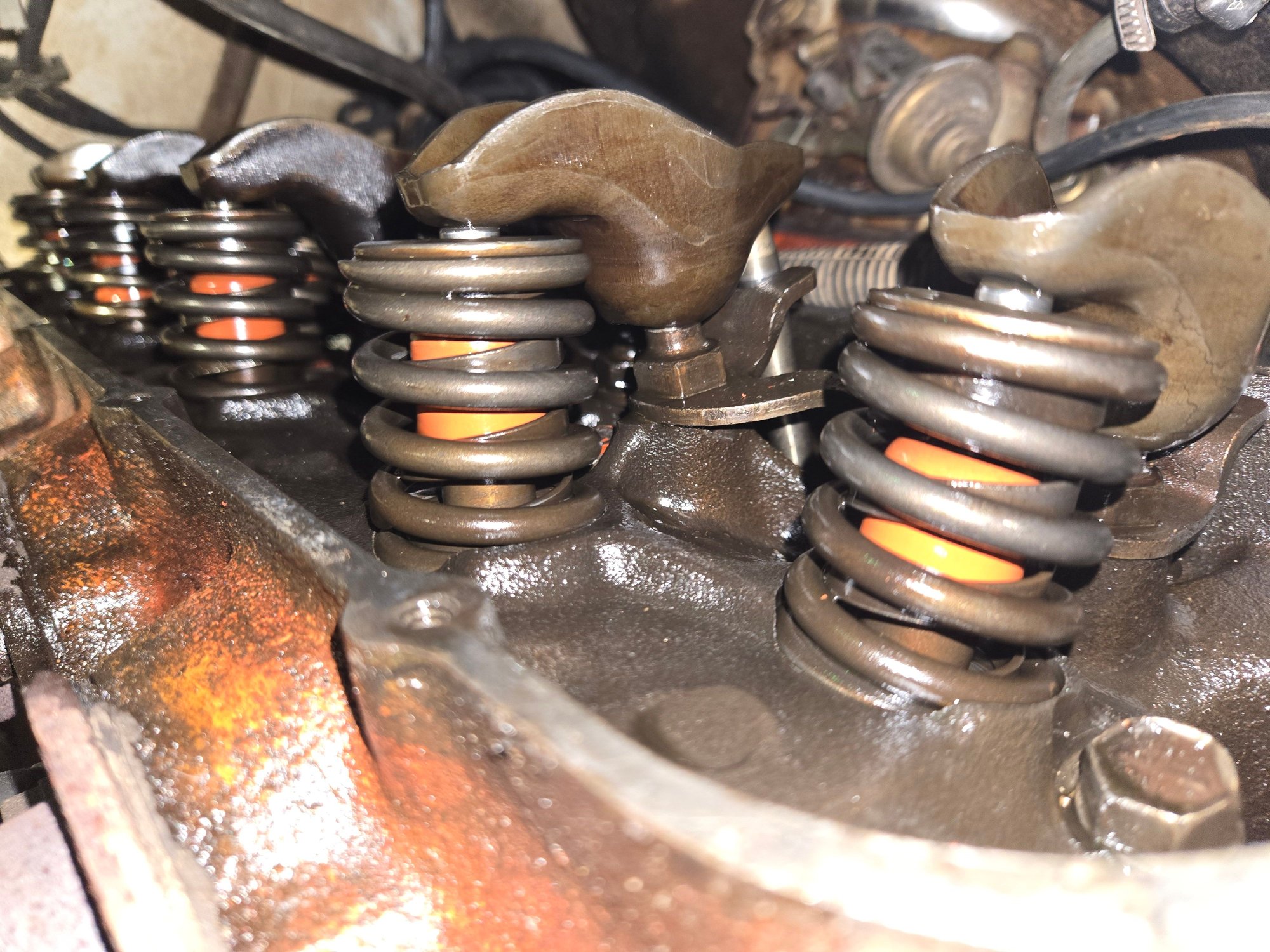

as soon as i get valve cover gaskets i will check the head #s, but they look factory.
its a bad guess as to what it used to be. the high rise intake and carb it had on it are gone. the nitrous hose is still there, lol. it still has marks from the old air filter housing hitting the underside of the hood (fiberglass).
all the previous owner knows is Rhodes Lifters, Competition Cams, and Predator Performance Carburetors. he doesn't know what his dad did with the old race parts. sadly, i was also told the big cam was changed out a long time ago to something "more tame".
it now has a gm 3883948 oval port intake and quadrajet 7043207. the engine block # T0823EK. im excited to get this thing running again.

found nothing special. 3904390 heads. looks like the factory set up.

Yep ,I believe the 3904390 heads are for the engine you are claiming, but year might not be quite right.

https://www.hotrodders.com/threads/b...-heads.168099/
1967 or earlier apparently
