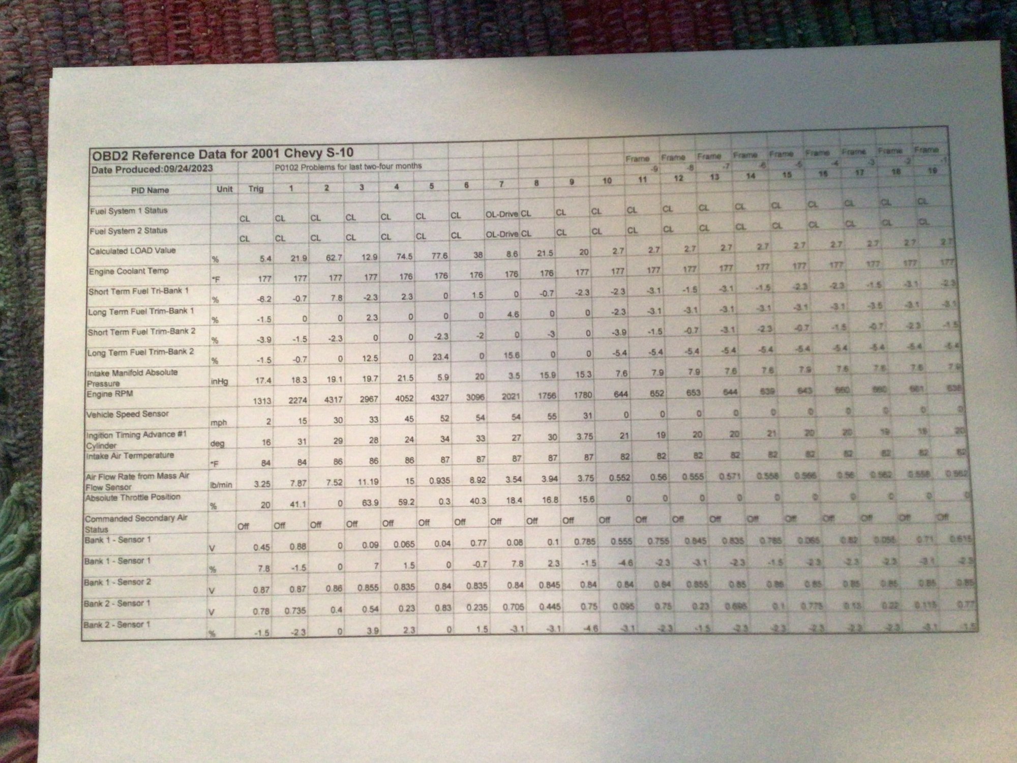

I recorded this data a few days ago, I think it got lost in my inexperience with with iPads and forum websites. I hope this helps. I also did some other data recording that showed some really absurd data like map jumping from 20 inches manifold pressure down to “3 inches” between 2 adjacent samples.while accelerating.

This is the data where absurd readings occurred.
Do you think this data would indicate a sensor may be loading down either regulated power supply? Where ever it is, it’s so transient that it only seems to occur for milliseconds. I’ve designed circuits with absolute pressure transducers and they all use +5 volt power.
I don’t have even a block diagram of the pcm, got any sources that would give me more information?

What are the column headings, are those freeze frame events?
