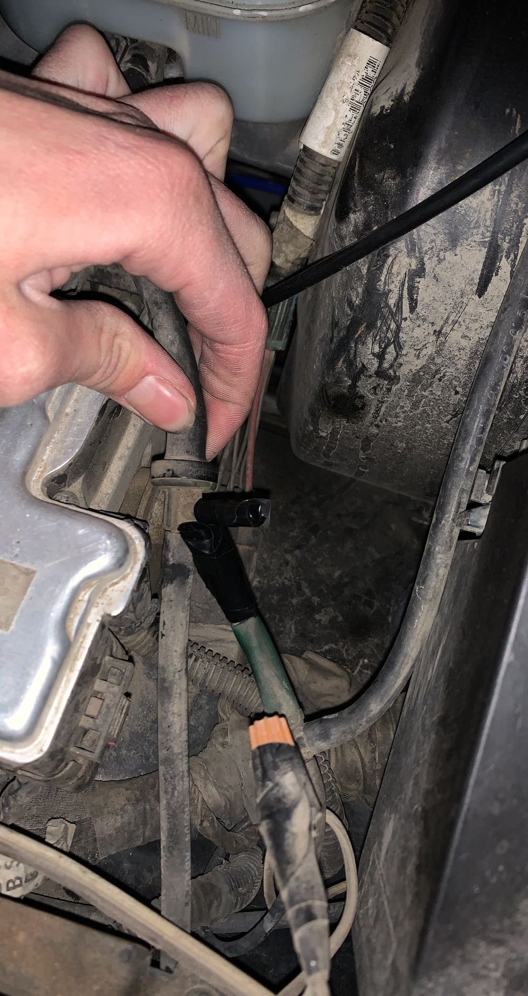

Thanks guys!! I'm really confused because all that white smoke, can't be normal. Also, I have a vacuum leak from one of those hoses that go to the transfer case I believe? Anyway, one of the small hoses behind the ABS module is cracked. I had to shut it off because I was a little too excited I guess and pulled off the rad cap after it warmed up a bit, the cap shot off, and water was everywhere LOL. Here is a video of the first fireup!!

If you have 4-button controls with "Auto", there are no vacuum lines going back to the transfer case. Behind the ABS module vacuum splits and goes to the A/C controls in the dash, the front axle solenoid above the distibutor, and a vacuum reserve canister mounted inside the back inner fender. Hope that helps. If you have 3-buttton controls this info is not applicable.

Thanks Les, I have a 3 button. Picture of the line that cracked below, it probably needed replacement anyway as it was very brittle and broke when I touched it. I just taped it off because I wanted to take it for a drive, and I did, it runs good, oil pressure is good, everything is looking good. I know I'm on a dirt road without the skid plate on but don't worry it's just down the road from my house! No hard obstacles or anything. Thanks again Les, and everyone else who pitched in help along the way to get me back on the road again! I couldn't have done it without you guys.
Don't sell yourself short! You certainly did your part, and didn't try to shortcut advice like so many do! Most on Internet just want a quick easy answer about which part to replace, without any work or diagnosis. Or they just don't listen to advice that they don't want to hear and do whatever they want. We'll be here if you need us.
Just realize all the systems and repairs that you have learned in this journey! And the process of diagnosis! It's astounding to think about!
p.s. if the SES light comes on at some point with misfire codes, don't be surprised (no crank relearn done). Also optimizing cam sensor retard is best but not imperative.
