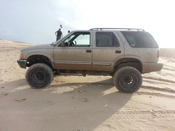

I have a 2000 chevy blazer 4wd and i'm having problems with the 4wd when I select the 4wd it works non of the lights blink but when i step on the gas the front wheels feel hard to turn and after a while the 4wd service light come on, I don't know if it's a problem with the TC or the differential or I don't know I've been having this problem since I bought it. I hope someone can help me :/
