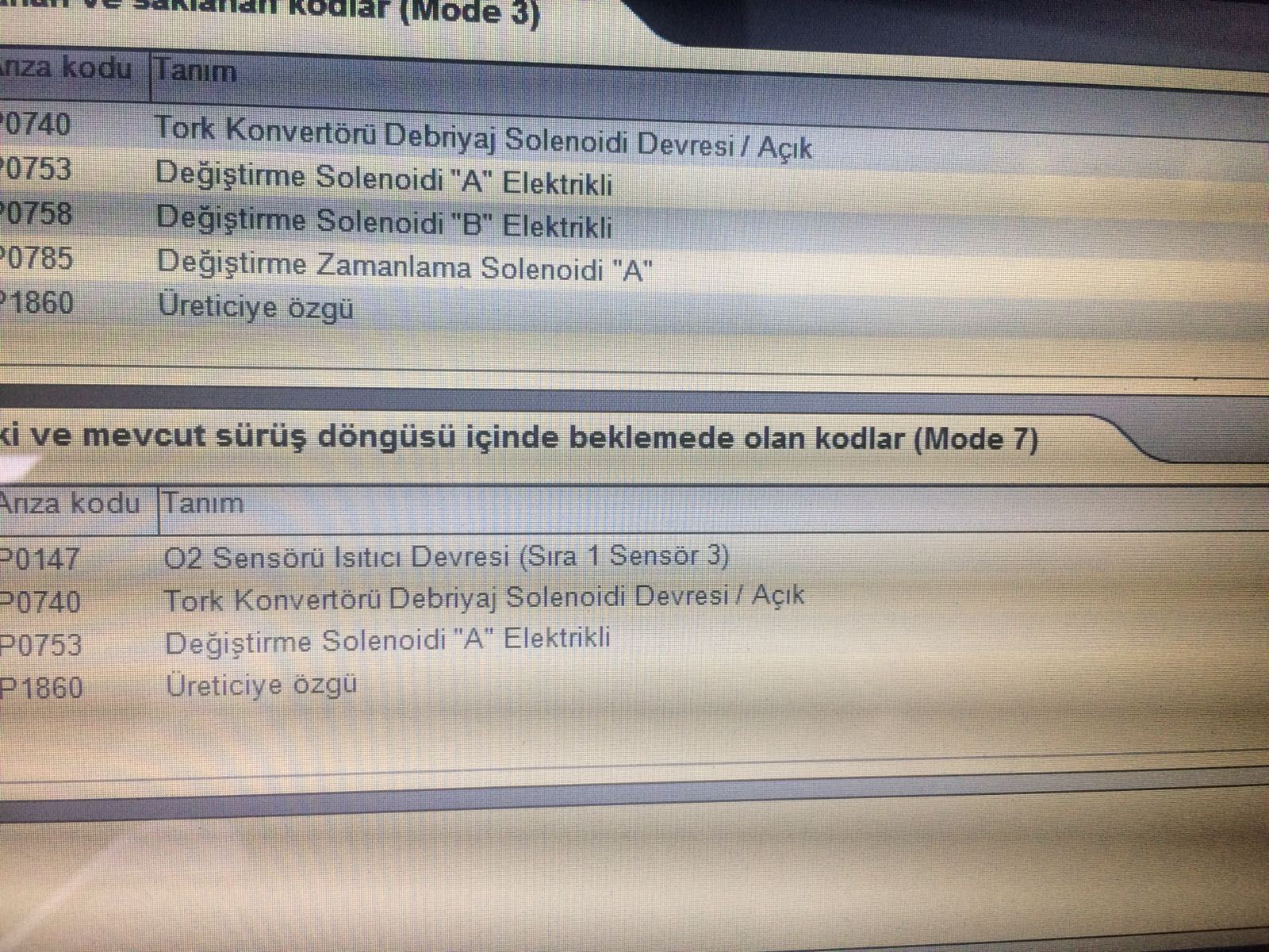

Hello,my soloneiod A and B is gives error,
my car is 97 blazer,and in D only there is third gear,
also my car's first gear is not working,it works like second gear,when i change gear from 2 to 1 or vice versa nothing changes,it goes on second gear
so I want to change soloneiod A and B,

From the other codes that are listed and being in failsafe I would say you don't have power at the transmission. Check fuse or may be bad or failing ignition switch. You might try putting battery voltage to terminal E /Pink wire on transmission electrical connectors to see if that solves your issue.

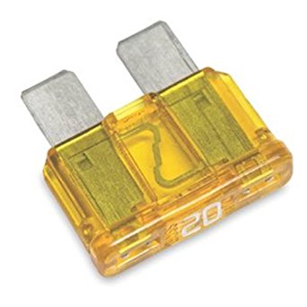

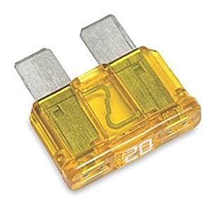

what do you mean by saying fuse?,sorry i dont understand it , if you show a picture or something else,i will be pleasured!

Old Aug 23, 2017 | 04:10 PM
Transman304's Avatar
Joined: Aug 2016
Posts: 505
From: West Virginia
Transman304 is on a distinguished road
It's pretty hard on the transmission for repeated 2nd gear starts. Here is a picture of the fuse I spoke of.
