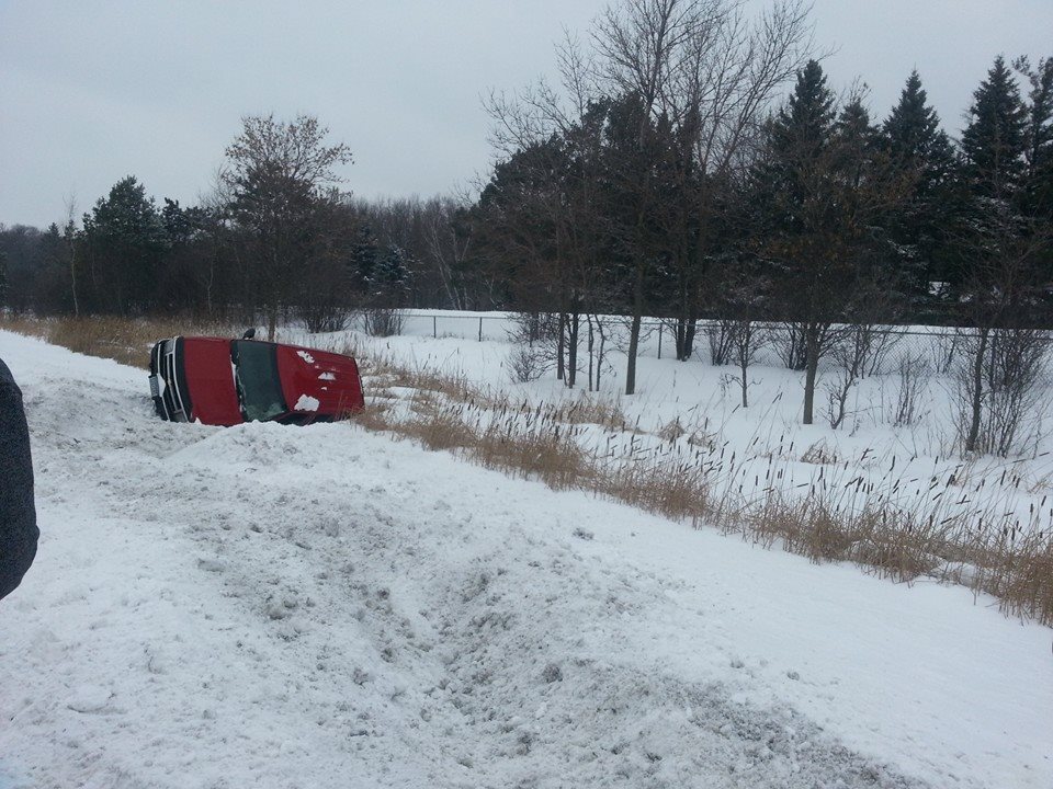

help needed. My son rolled his 95 Blazer on Monday. Good news he is ok. The driver window broke. We were able to drive it home. We replaced the window and the motor for the window. Then tried tried to start it. Would not turn over. Thought maybe the battery was the issue, so charged it overnight. (battery is 2 months old) Tried to start it, cranks but wont start.
Put a new starter in 2 months ago.
Gas gage has not been working.
Does it have some kind of safety shut off?
What is most likely wrong?
Do you think something came loose?
So thankful my son is ok, but like to be able to drive our only 4 wheel drive vechile with 12 inches of snow today.
I attached picture from roll over
