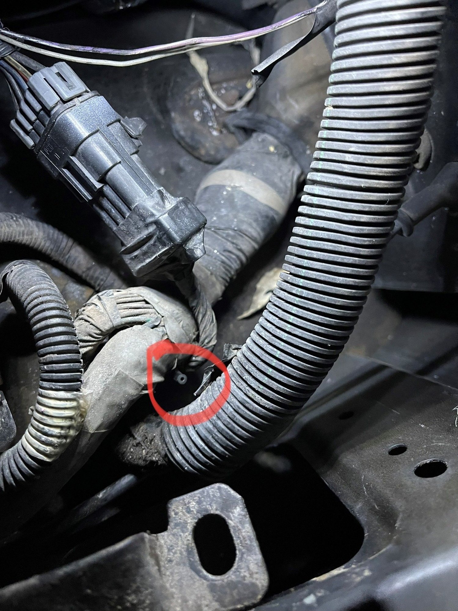

Does anyone know if this is the Vacuum line that goes through the firewall to the HVAC?
