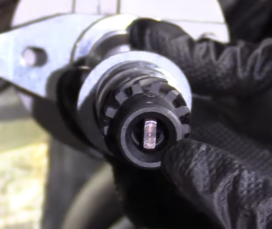

I'd like to also note that there is a metal tab in the center bottom of the distributor shaft. I've attached picture of it (not mine). I was lead to believe that it prevents the distributor from seating properly unless the teeth are in the proper order (or 180deg apart). I didn't force the new distributor in and was careful with the orientation when putting it in. Which is why I assumed it was a premium chineesium part. Am I wrong about its purpose and actually get it 45deg off?
Attached Thumbnails '98 Jimmy loosing rpms and sputtering-shaft-blade-tooth-thing-distributor.jpg

Yes, that is the factory procedure that I recommend. I wouldn't replace distributor unless gear is bad, now that you have a new cap and rotor.

Almost forgot, the square tab in the center of the distributor gear meshes with the oil pump drive shaft. As you apparently discovered, if it is not engaged with the oil pump shaft it sits on top of it and prevents the distributor from dropping down all of the way. Sometimes you need to turn the driveshaft to a proper position so it engages when the distributor goes back in. You can see it if you shine a light down the distributor hole. I have a huge foot-long screwdriver that I use to turn it. It's kind of a trial and error thing. Turn it just a little and try the distributor. Move it a little more and repeat. Repeat until distributor drops in all the way.
If you don't have a SES light with P1345 code setting, you can mark rotor position on the firewall with a sharpie before you take the distributor out - and put the distributor back in with the rotor pointing directly at that mark. That's the easiest thing to do. If you have complications of some sort for whatever reason, then you go to the put engine on TDC #1 and drop distributor in with the rotor pointing to the "6" cast into the cap mating surface method. Most likely you won't need to do it.
The reason I am first pointing you to set your cam sensor retard (to possibly cure your problem) is because it is such a common performance problem on this particular system - and it seems you are already onto it. If it isn't the problem, we can do other testing of live data before replacing parts. That's where the scan tool comes in. Lots of stuff you can do with a scan tool, fuel pressure gauge, and compression tester without shooting the parts cannon!
So please get that cam sensor retard set. If your gear is OK, you can take off the factory hold down, use your old distributor with a SBC hold down, and save some $$$. Would only cost you some work to try it. You may want to stop by the hardware store and buy a longer hold down bolt and a flat washer. Blazer hold down bolts are metric and smaller diameter. Take the old one with you for sizing.
