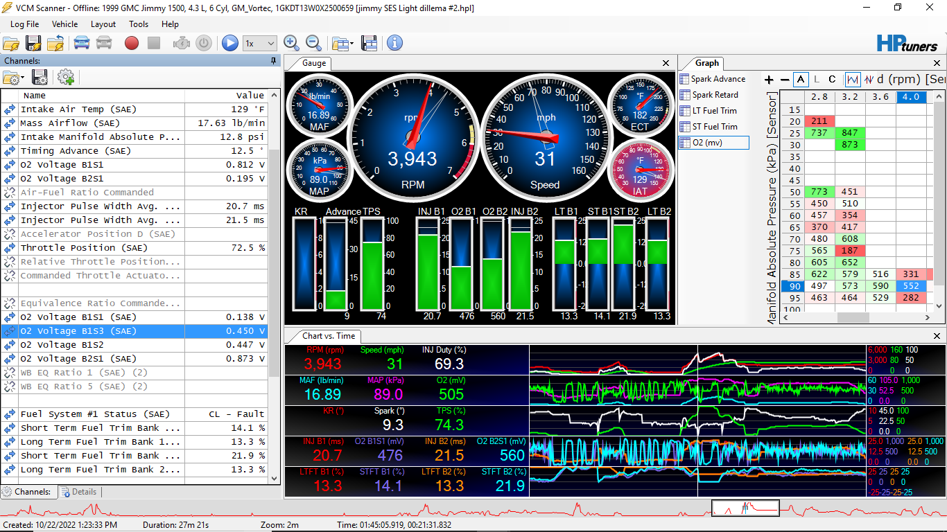

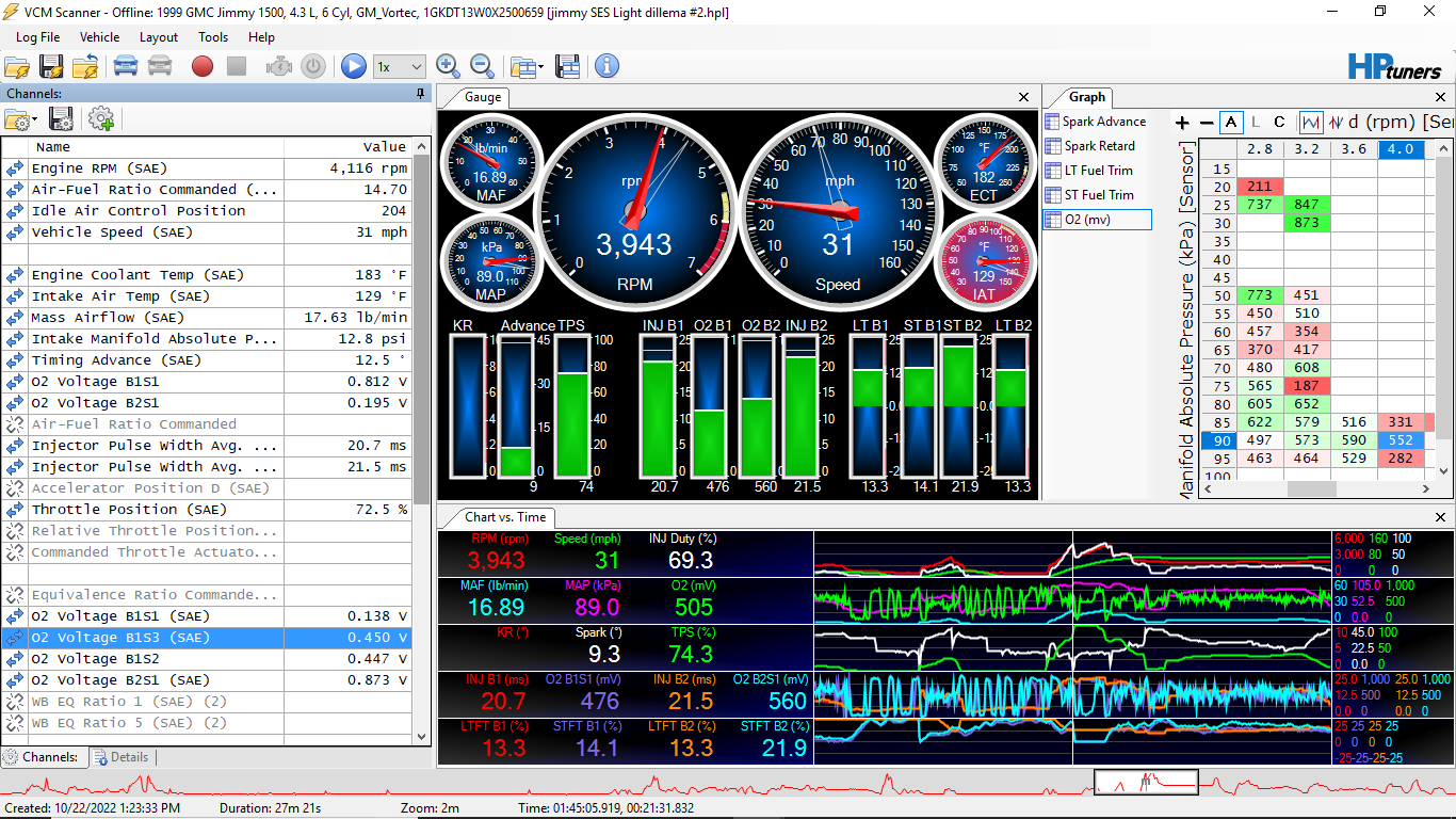

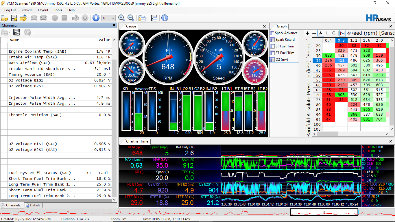

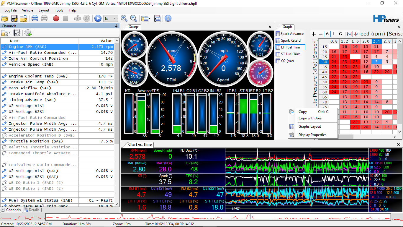

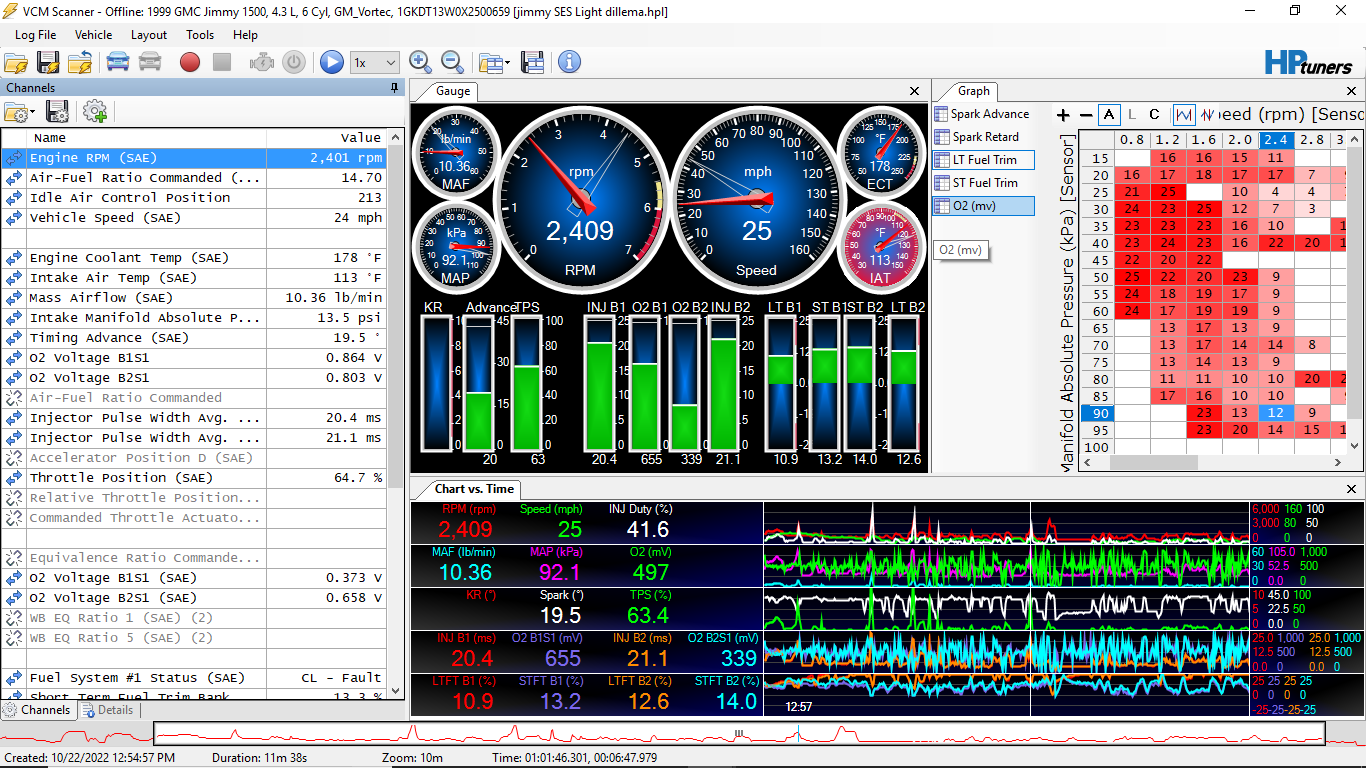

Alright fellas!

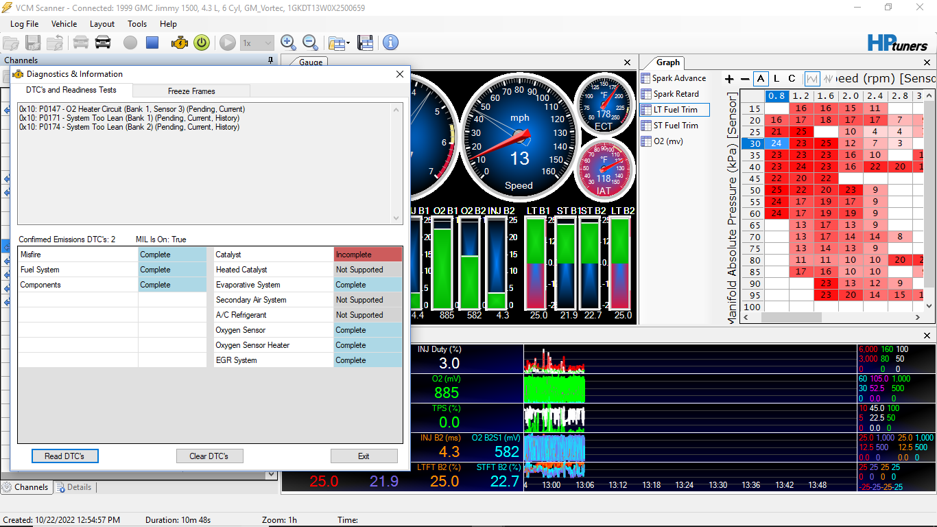

Hooked up the computer again to may car and i was decently surprised when there was a p0147 error waiting for me like i predicted. Anyways i got some screenshots of the recording for everyone.
the codes i have currently
notice the LTFT1 and LTFT2 fuel trims
i can add more screenshots of my recording if needed but this should do for now

Old Oct 23, 2022 | 10:32 AM
GeorgeLG's Avatar
Posts: 4,635
From: Florida
OK, a couple of things.
HP tuners implies a computer reprogram. Is this engine computer stock or has it been modified?
Capturing this data while driving vastly complicates our diagnosis, especially furl trims which we need, except for a couple of specific tests. Lets get the main one out of the way now. We need the MAF reading at the full throttle 1-2 shift point.
For everything else we need to be in park. Three sets of data.:
Engine cold, key on no start. We need all the sensor readings and the atmosperic pressure and temp at that time.
Idle, engine warm, the data above plus can you graph the O2 sensors?
Engine warm, 2500 rpm same data as idle
George
