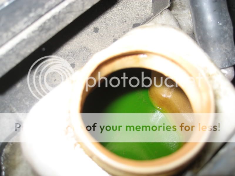

After starting the truck and running it, I've checked under it and noticed that the coolant is running off the bottom of the block, it doesn't look like it's coming from the pump though...
And here are some pictures of the radiator and tank:
http://i12.photobucket.com/albums/a2...Picture002.jpg
http://i12.photobucket.com/albums/a2...Picture003.jpg

What part of the block? Front? Back? Left? Right?

I am more interested in pics of the coolant leak.
Where is the leak under the truck/ Drivers side, passengers side, front back?
Do you see any ANY moisture on the block where the intake manifold makes contact, particulaly the corners, especially behind the power steering pump?
After it starts leaking turn the engine off and find the bleeder hole on the water pump, is it wet?
Do you have white smoke out the tail pipe?
How fast does the coolant disapear?
Lots of questions eh? However I have a coolant leak means diddly to me! You need to be more specific.

The leak is on the front of the block, dead center, all the way at the bottom. I can see two streams under the lowest pulley. In the middle of this area, it looks like there is an electrical connector of some kind. I will get a video tomorrow afternoon and post it... When I burped the system, I opened the radiator cap and filled it to the top. After 15 minutes of running the engine, the coolant level was down past the metal "innards" of the radiator. It looks like a pretty significant leak... I'll have to do a "___ minutes for one cup" kind of test tomorrow.
