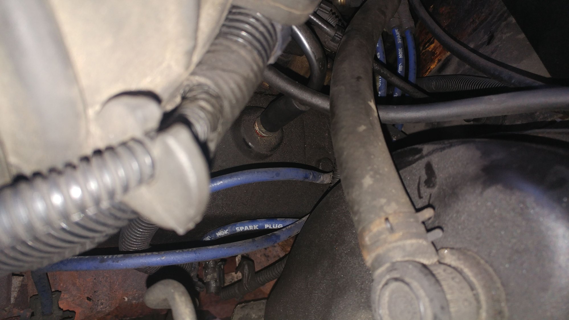

OK, finally got a few photos of the PCV Valve connecting tube end. The area is well covered with silicone spray, but still the thing will not come out!

You know, your only option might be to remove the valve cover.

I rebuilt a blazer for my EX a couple years ago, I don't remember what year of blazer and 4.3 it was but the PCV valve was built in to the valve cover and not removable. If memory serves me right it looked like what you have

Agree, that valve doesn't really look like the pic I posted.
You can't get the hose off? If the valve is stuck in the open position maybe you could buy another one and rig something to install it in-line.

Removing the valve cover seems a little extreme to me, christine_208, to check/replace the PCV valve. :-(
How would I know if it's stuck open or closed, puttster? I suspect it's the PCV valve that is causing my "check engine light" to come on from time to time on a P0101 code, because I have already cleaned the MAF sensor twice, put a whole can of SeaFoam spray into the throttle body, and my air filter is clean. The "check engine light" was on steady prior to that and I also had a P0104 code. Other things that could cause that, from what I have read, is a dirty EGR valve (which I don't believe this vehicle has), or a partially clogged catalytic converter (but I believe that gives a different trouble code). When I put the SeaFoam into the engine it made it much smoother, so my guess is that the PCV valve is not working quite right, but cannot check it without getting the darn thing out!
odat, that sounds like what I may have. That would mean doing what christine_208 posted just to check the PCV valve. :-( So much for GMC being "professional" grade. :-(
Maybe I need to do a vacuum test to see if that gives me any clues.
