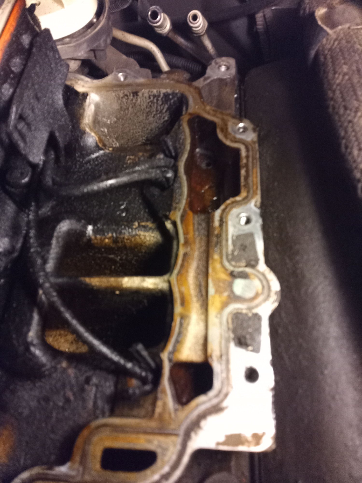

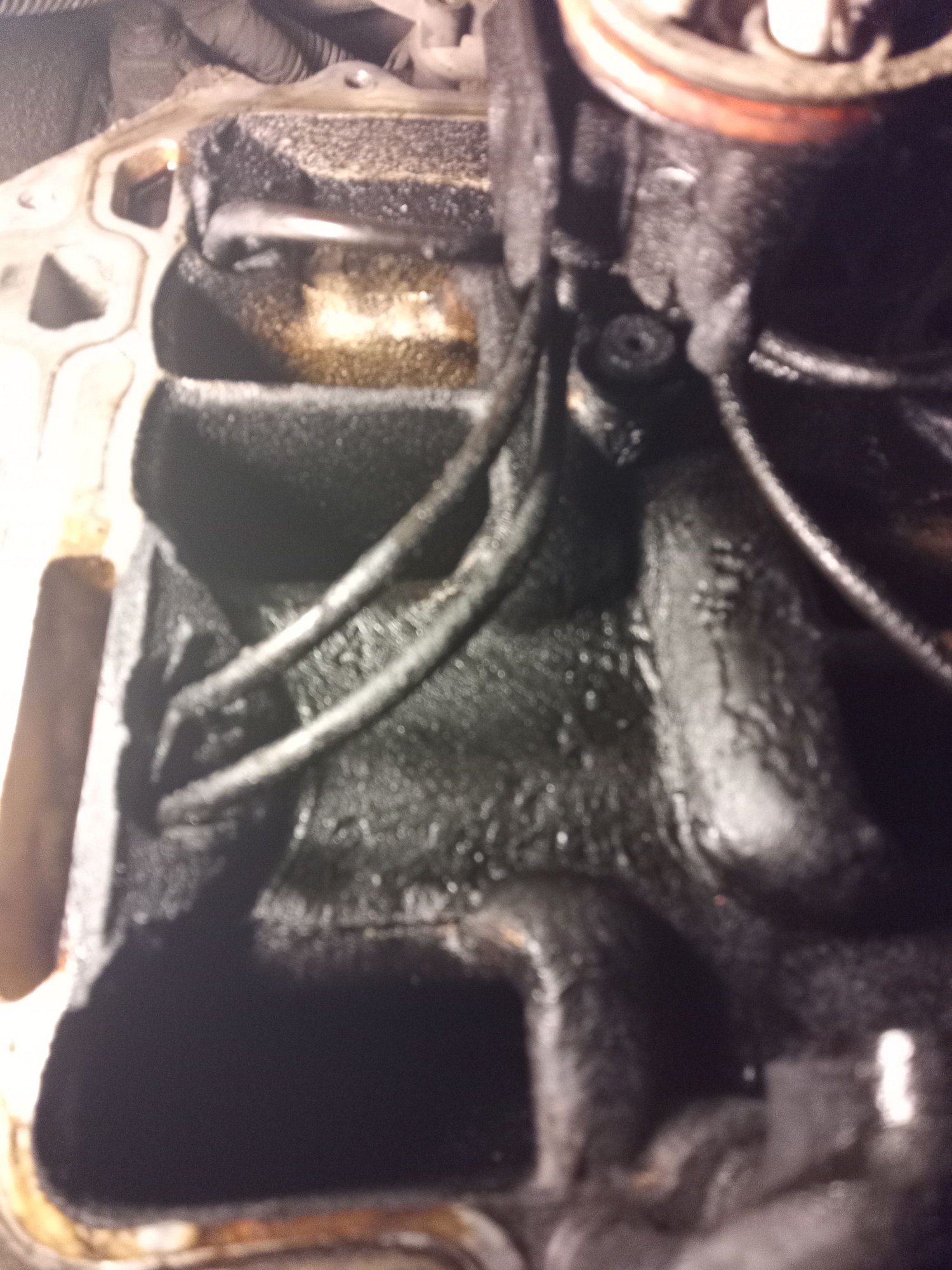

It looks to me like there is a fuel leak. The fuel pressure regulator is located behind the fuel spider. The rear cylinders are worn from the compression test. Most of the washing seems to be on the driver's side from the pictures. Could this leak be anything other than the fuel pressure regulator?
Passenger side intake manifold.
Driver's side intake manifold.

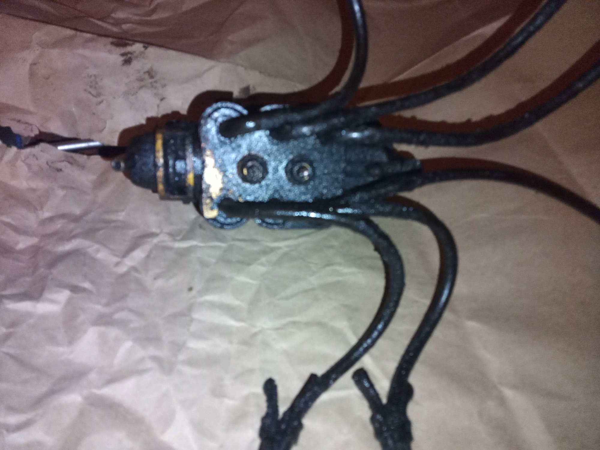

Here's the proof, the fuel pressure regulator is leaking. The gunk on the bottom of the spider is washed clean at the connection. I wonder if this could be solved by just replacing the o-rings, rather than buying a whole new unit.
Fuel Spider

I would not put that spider back in. It is probably the original one especially with the poppet style. I may lean more towards a valve sealing problem with the 2 lower cylinders. Are you chasing a misfire down? What made you do the compression test? I would do a leak down and if air escapes into the neighboring cylinder then you know.
