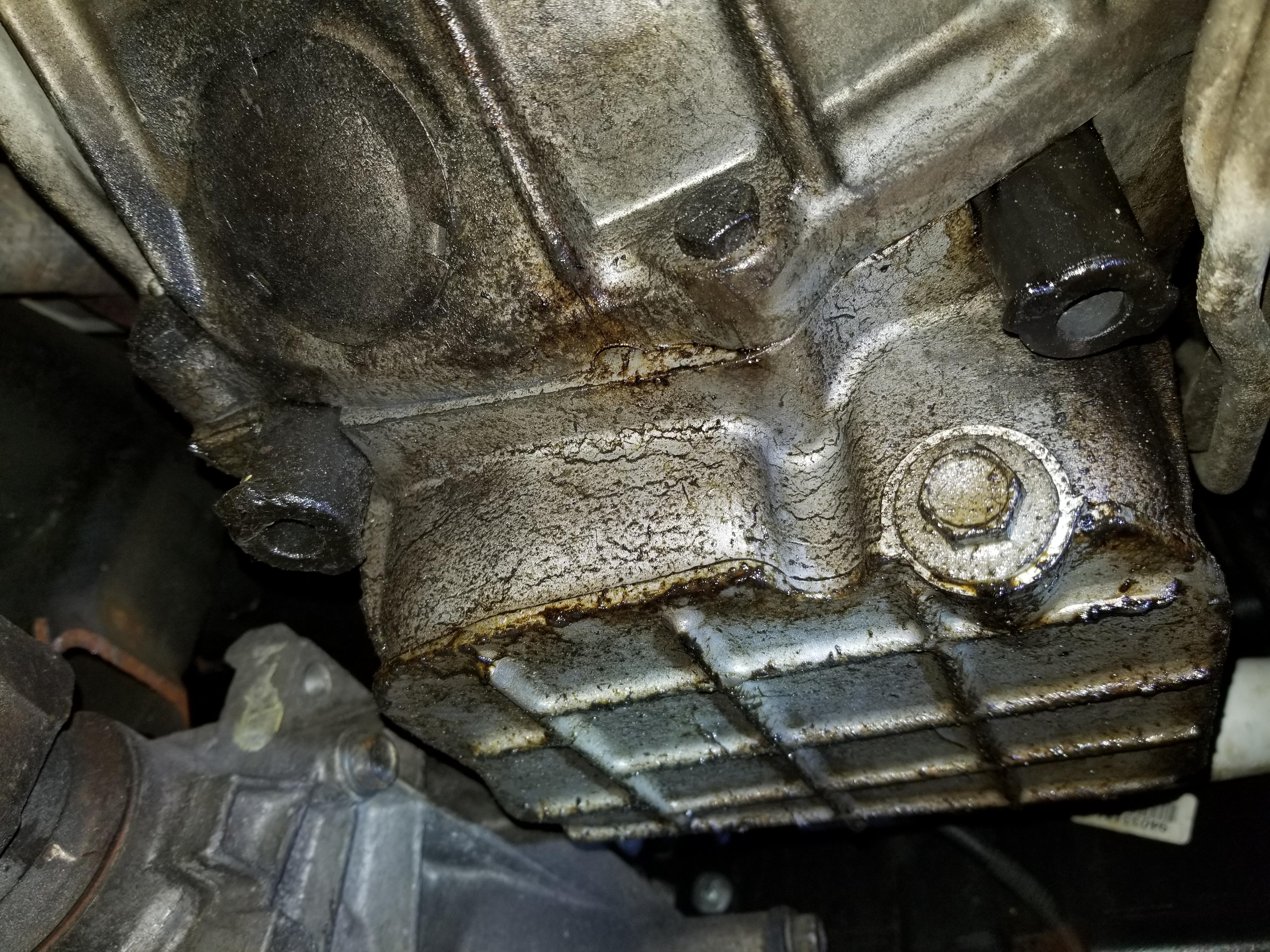

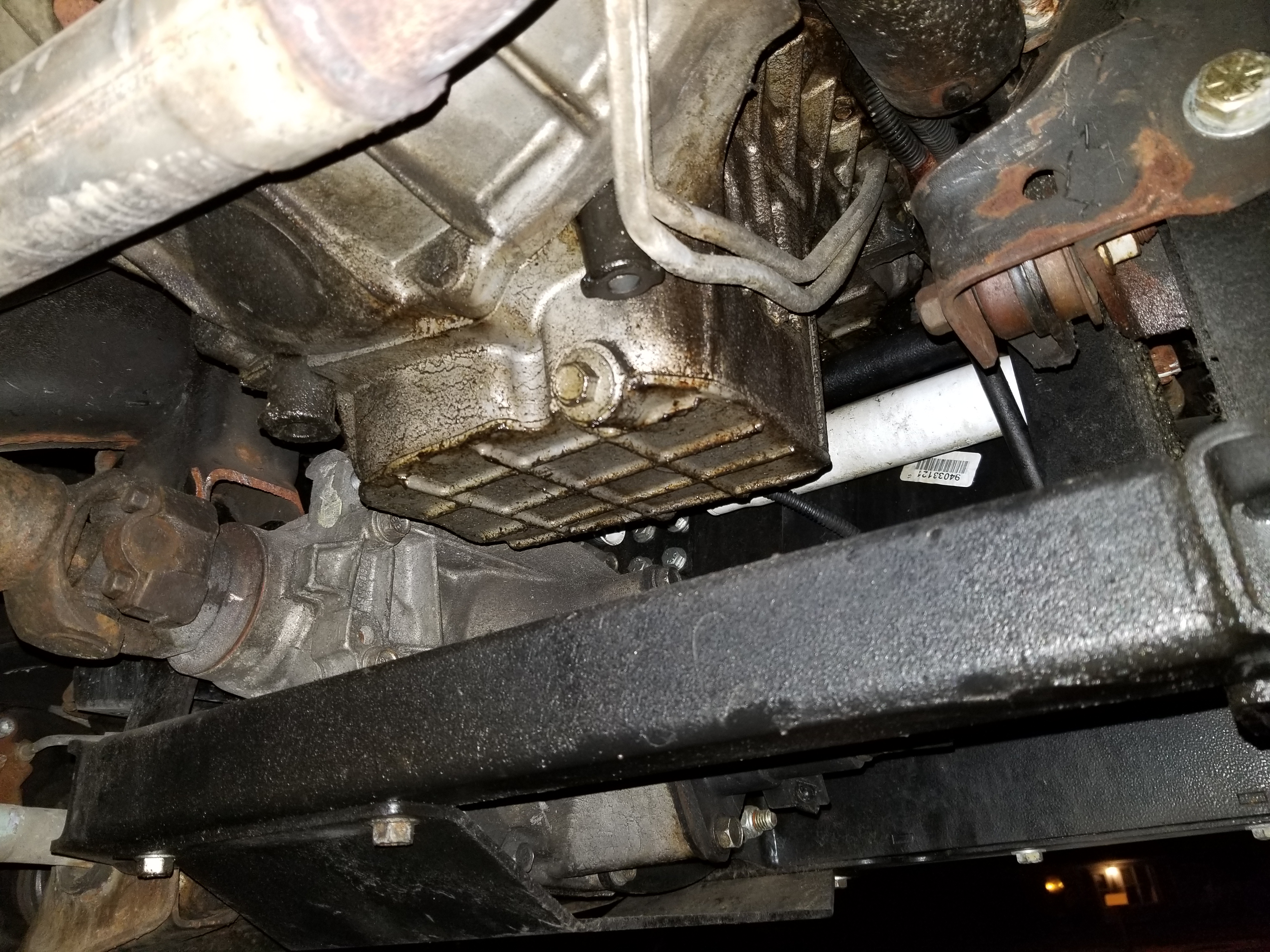

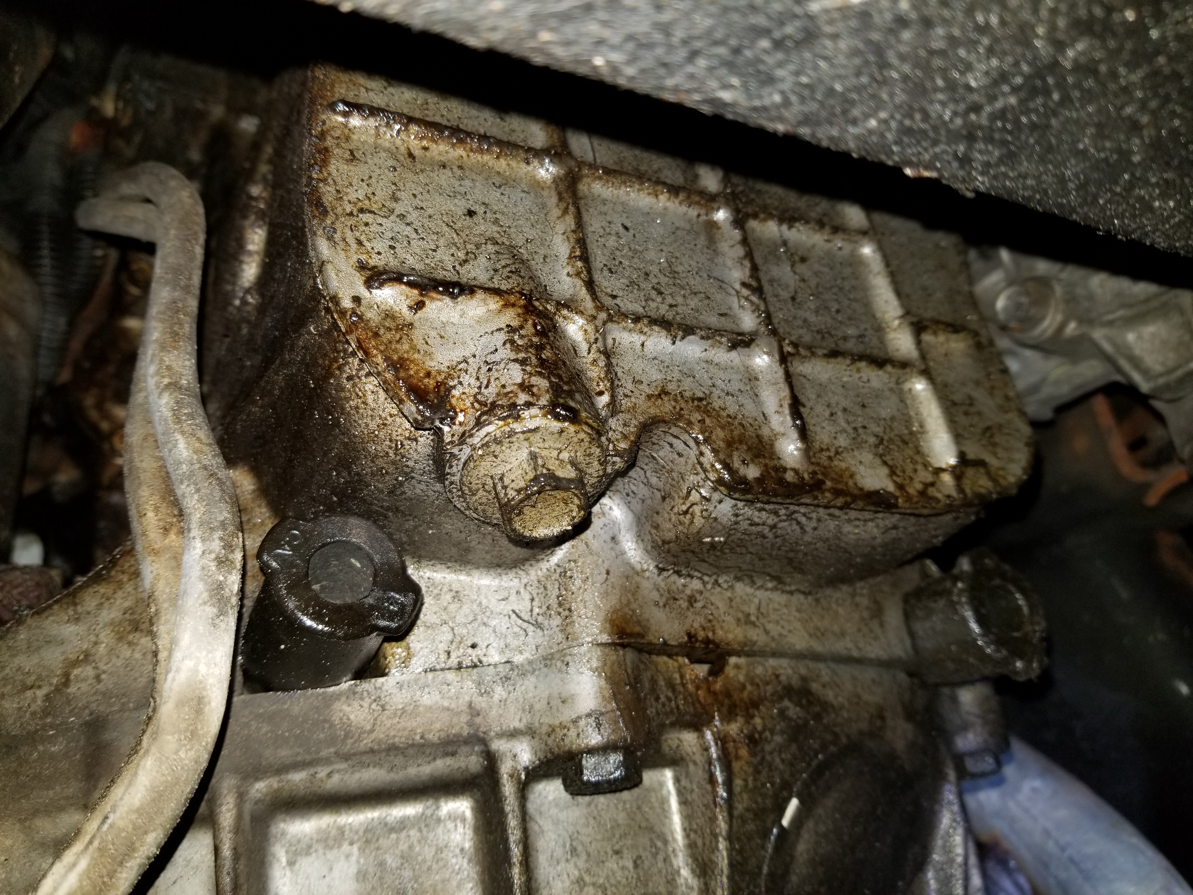

Thanks man preciate the help.....ill look into the intake tomorrow when I'm off work....last night I got under it when I got home from work and the bottom of the oil pan and the front portion of the tranny pan seems wet where the sides are dry. It appears to be just oil on both but I can't be certain cuz I could have sworn I got a hint of coolant mixed in with it. Here's couple pics I could get from under it last night. Ive been using only water since this started so I'm not wasting money on antifreez. Pics not the best but best I could do at 1am lol

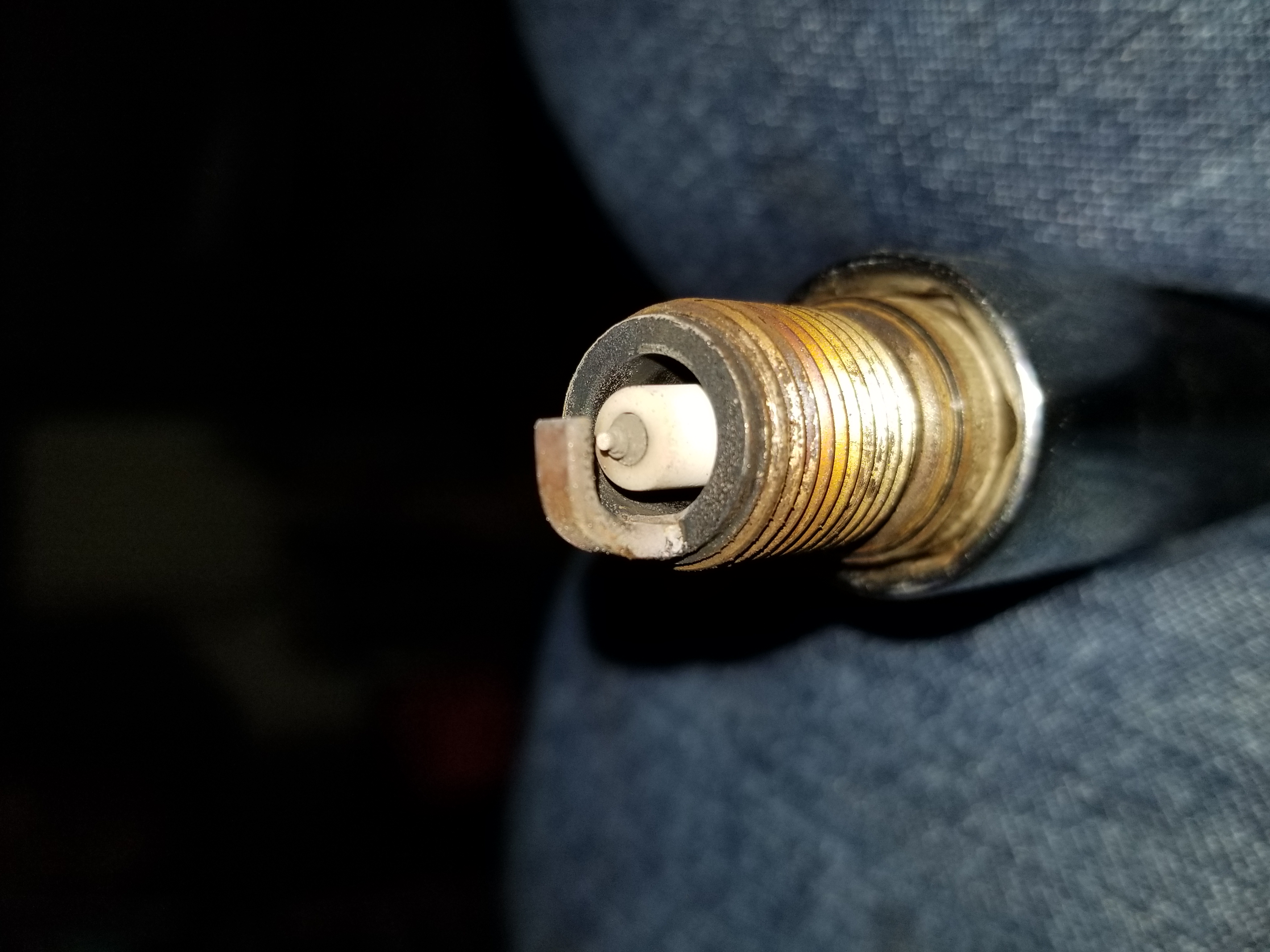

Well ch3cked the plugs and they look fairly good tho from my experience in looking at plugs which I do admit isn't a whole lot...im still thinking it's leaking at from the back though.....maybe around one of the water jets or something.....i remember hearing somewhere that the 2 in the back get clogged fairly easy so I'm thinking that's where it's leaking from....
