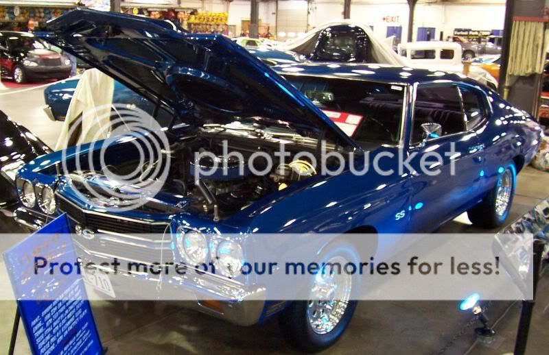

Here's my 70 Chevelle
http://i141.photobucket.com/albums/r.../Chevelle1.jpg
If you can, drop the rear of the tranny a bit, so you can get a long extension up there for the last two bolts. Or, try going in from above with a wrench..... Be prepared with the iodine and bandaids though.....
Your Chevelle is gorgeous.
