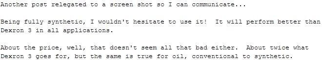

Old Jul 11, 2008 | 07:39 AM
Posts: 41,341
Default RE: Dexron VI
