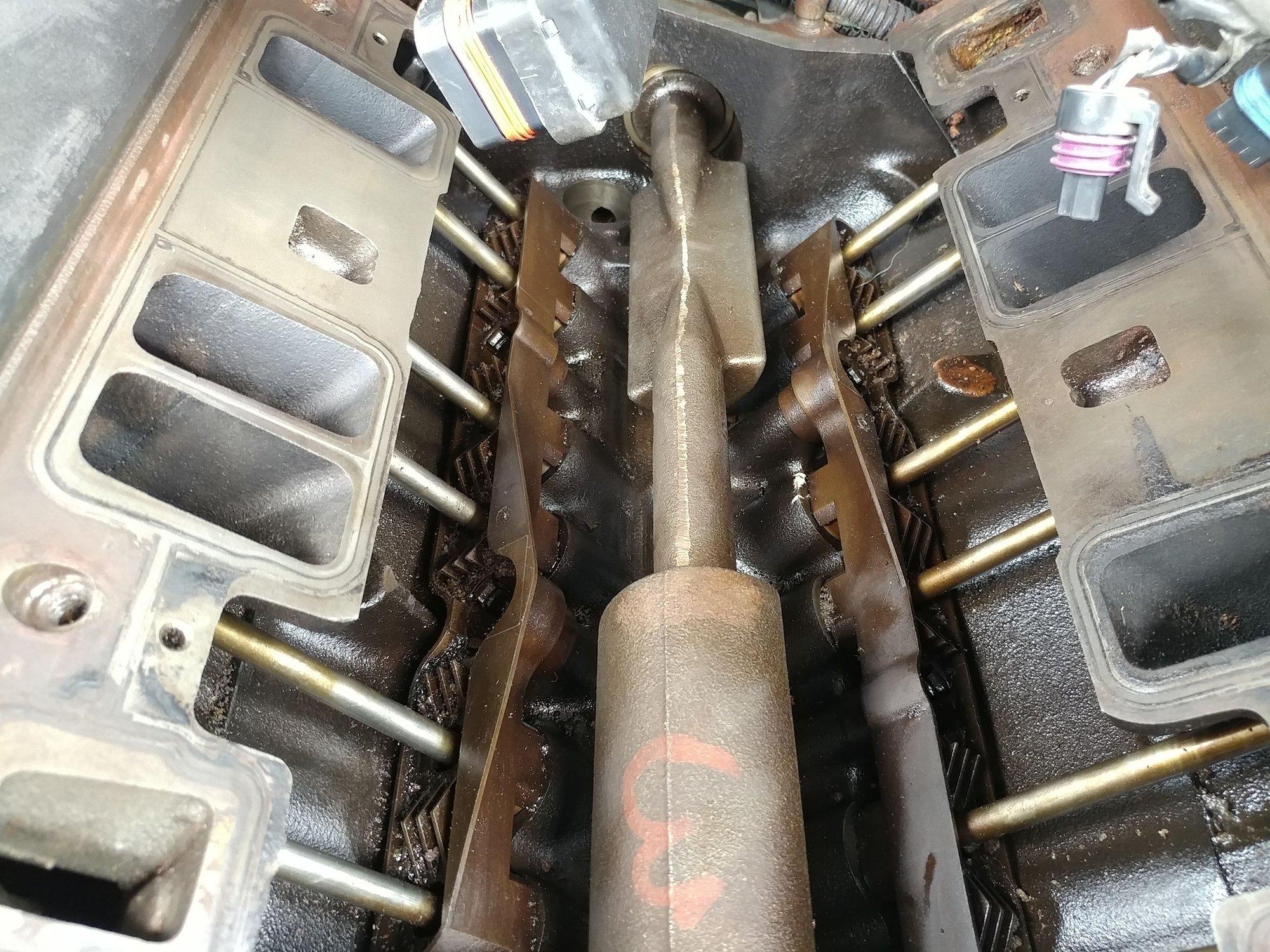

I Can see a bit down on the crank like it's just particles nothing big went down there
get a picture if possible, i think you mean the camshaft

Aha yes the cam so I'm used to 4 bangers the v6 is new to me. I'm picking up carb cleaner and going to use a cloth and get the little particles around tomorrow. Will said carb cleaner Make it way to the oil pan ? I'm doing a oil change before starting the truck
​​​​​​Here is a picture I don't think it's that bad I'm focusing on the sides near the push rods right now can I spray carb cleaner and it will make it's way to the oil pan ?

ok for starters
what the hell is that nastiness in there. i hope thats not just angle+lighting.
As a sidenote, it might be better to just take the pan off if its a 2WD, but yeah it will run its way down to the pan, let it dry out for a nice long while, carb clean evaporates after a little bit so take a beer break and come back to it. button it up, oil change, prime+run, then you could leave it like that, me im paranoid about hard parts damage, so i would do another and keep the oil thats drained for the second change on hand for small parts lube.

Please describe how you cleaned the gasket surface on the heads (surface with the ports that mates to the intake manifold)?
I took off the intake manifold placed down a pillowcase in the valley scraped everything down onto the pillowcase and then carefully picked it up and shook it out also use some carb cleaner
