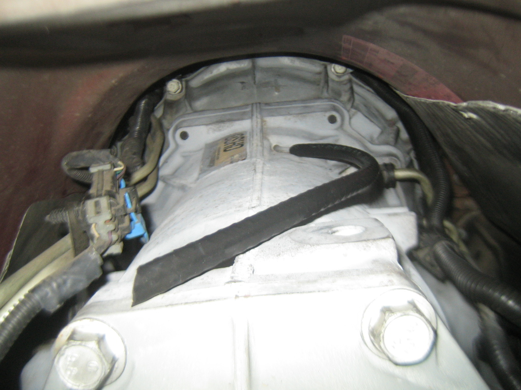

This is the view of the upper bolts with the rear of the transmission tipped down. It really didn't take much but made a big difference in getting a socket on them bolts. I had to remove the transmission to fix a no reverse problem. Since your only removing the engine, taking the motor mount out could give you an inch of more space.
Al
2000 Blazer 2wd
