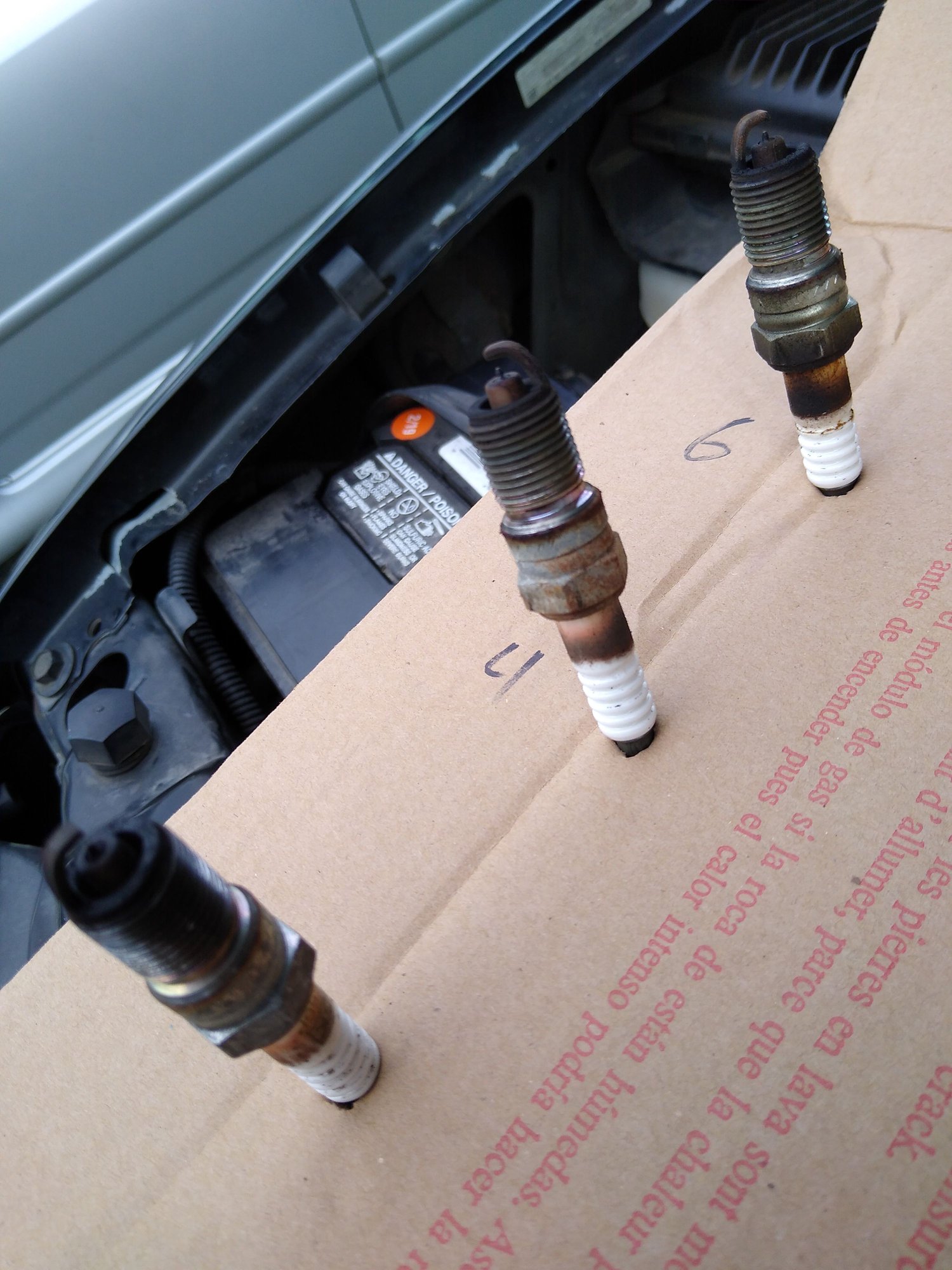

STEP NUMBER ONE IS ALWAYS " LOOK AT THE SPARK PLUGS"
Always. Few do it.
Plugs are the key to knowing what's happening inside the cylinders.
Pull all of them and photograph them and post the pictures.

I'll pull spark plugs at lunch and post the pictures

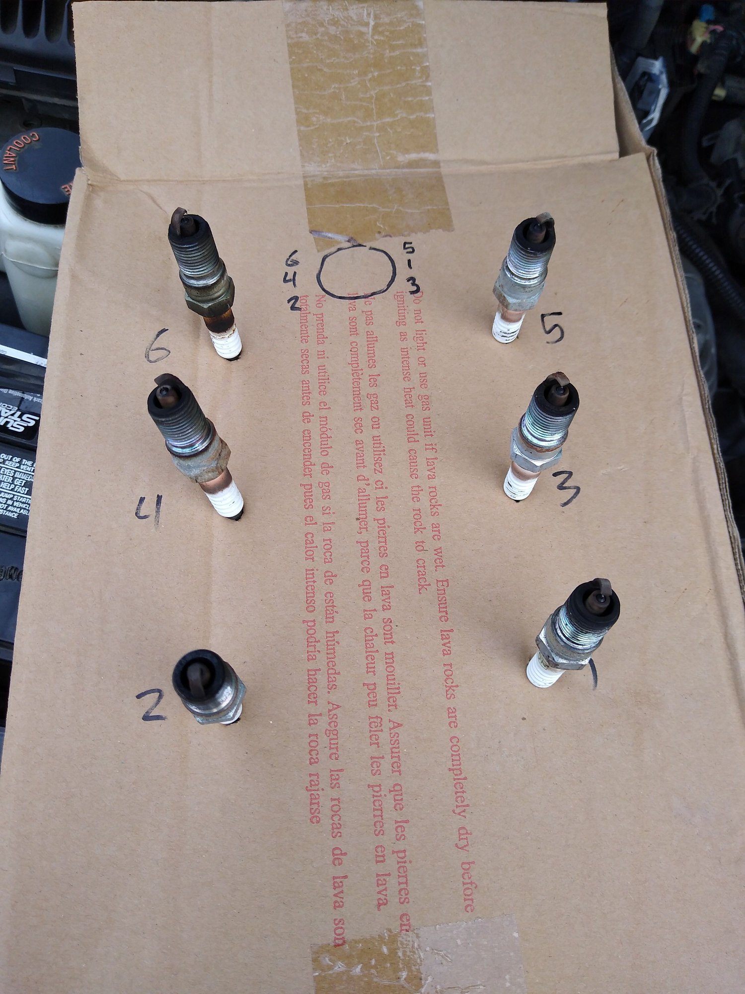

my first impression is there's no way that mechanic actually changed these, my next is that the gaps look a bit large, should I replace them?
Those plugs don't look terrible, but they definitely haven't been replaced recently... Can tell just by how dirty the ring around where the boot slipped over them is that they've been there for a while. That and the surface rust on the metal portion...
You say you replaced the coil, what about the ignition module that's next to it on the same bracket?
No use throwing a ton of money at new parts, see what a local junk yard would let you have one for. Bolt it on and see if anything changes. If it runs better, great, you found the problem. If you're satisfied with installing and running used parts, then roll with it. But if not, then invest in a new one from somewhere and use it.
I would say that the next thing I would try would be the module that's inside the distributor, under the rotor. But if you had the distributor itself completely replaced, that should rule that out. Unless it got changed the same way those plugs did...

So I also changed the plugs and got no improvement (I figured they had 35,000 miles minimum anyways). I have a scanner that will show me trim, MAF, etc if that helps but I don't know what to look for
