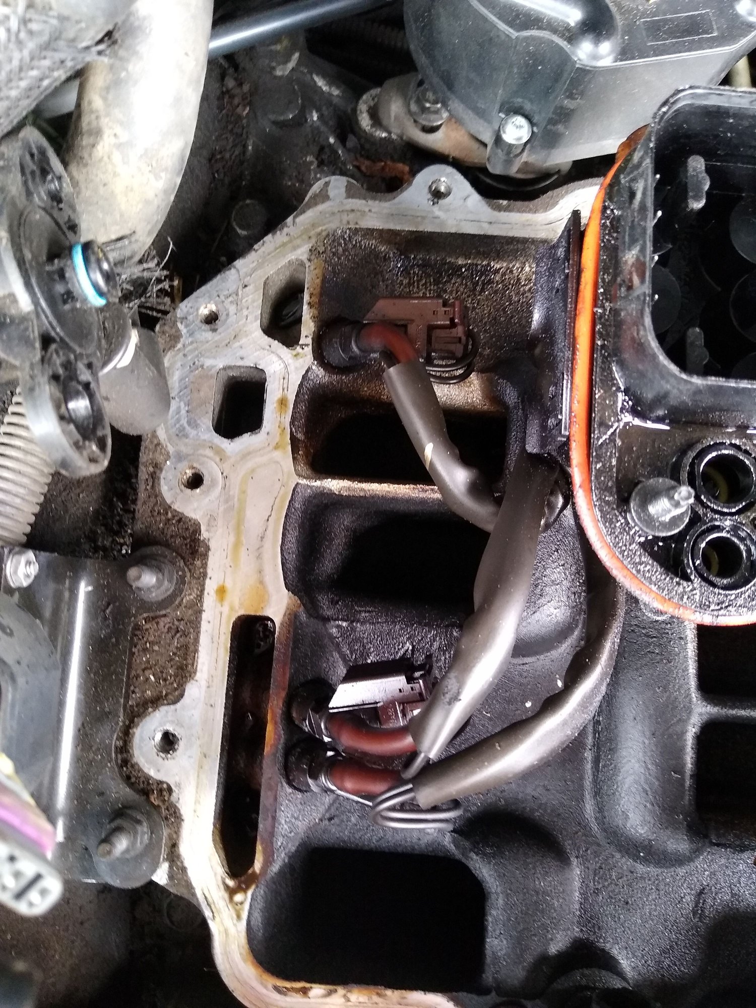

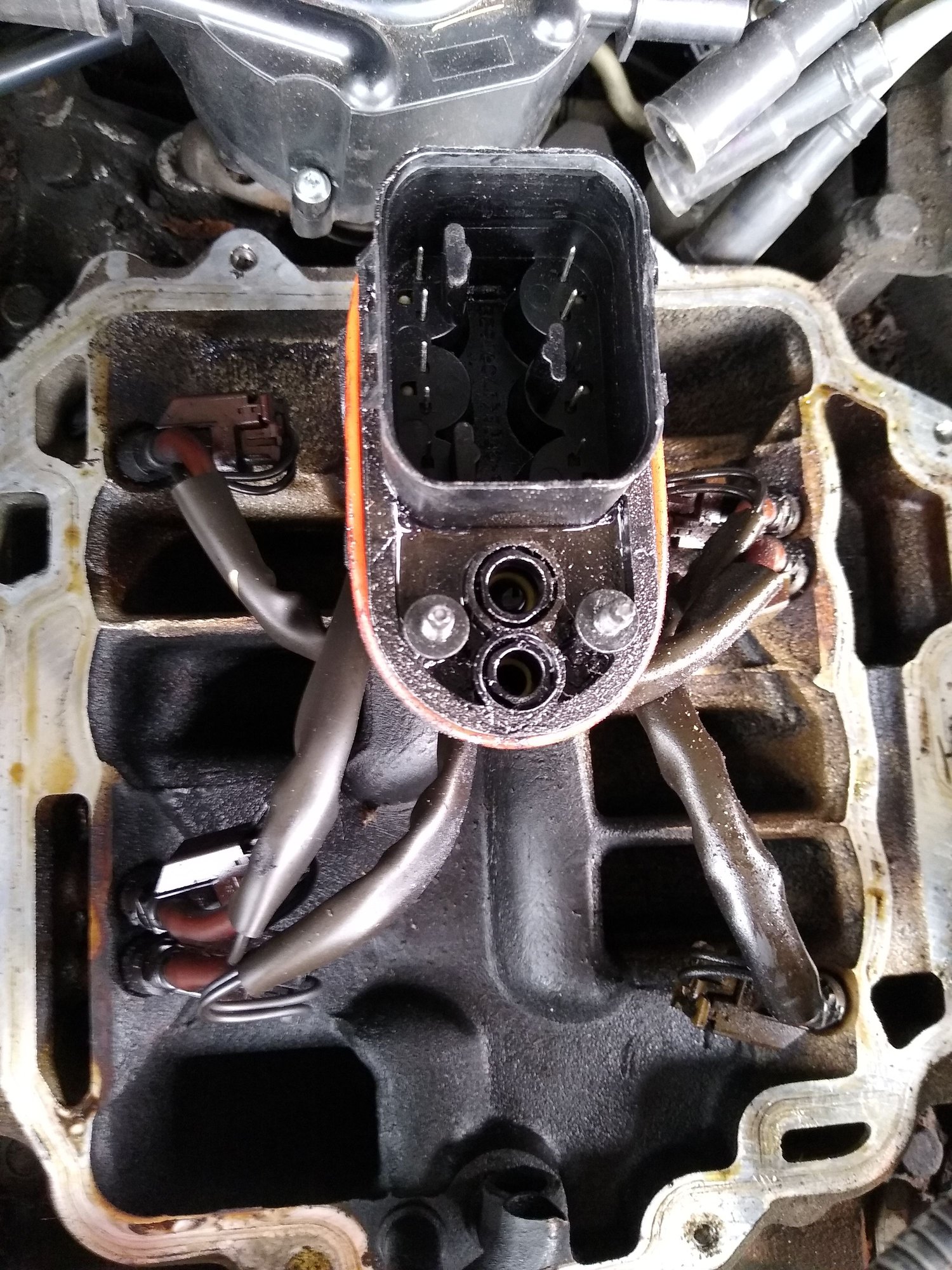

Update: I talked to a mechanic friend who hooked up a computer and told me everything he can monitor looked fine. He went through a crank and cam relearn and it didn't help. He forgot to bring his fuel pressure tester but I told him the fuel pressure was within spec. He advised that the spider may be the issue (even though mine is the updated version that's only 5 years old). Here is what I found, to me the right side of the pictures looks suspiciously clean

I tested to make sure my EGR valve moves freely but I plan to run it without because everything inside was so dirty that there has to be a way too much exhaust is coming back into the intake, the bottom of my throttle body had a huge buildup of grease.

Update: I was slow putting the upper intake back together because I didn't want to get water in there and it's been rainy in Western Washington. Pro tip: tighten the fuel lines all the way when putting the intake back together, seeing gas pour onto your exhaust pipes is a little scary. I got everything together and ran it with the EGR unplugged, the exhaust smelled like old car exhaust but the Blazer was not improved.
Back to square 1
I'm going to check fuel pressure again because at this point I think I'm losing my mind and it has to be suspect. The injectors seemed fine as I'd expect since they're the updated ones. Going a little insane trying to figure this out
