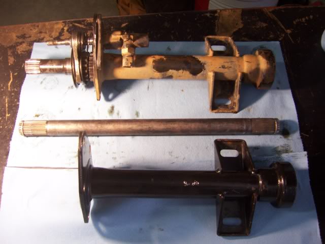

HAHA! Haynes? Chilton? If you want bonfire material! If you want the defacto best, search ebay for the GM manuals (helminc.com). You won't find the factory manuals on Summit though... Just the other junk manuals.
As far as the confusing part, the "Bravada Mod" is swapping out the failure prone passenger side extension tube, shaft, disconnect mechanism from a standard 4wd model Blazer/Jimmy with the solid (non-disconnect-able) passenger side extension shaft & corresponding tube.
To OP, you will need the passenger side extension tube & shaft from a Bravada or AWD Blazer (they exist) that has the same CV shaft attachment method as yours (i.e. splined or bolted) at the inboard side.
This came up in the similar threads table at the bottom:
Originally Posted by mdehoogh
Do you have the 233 (3 button) or 236 (4 button auto4wd) transfer case? If you have the 236, the front driveshaft is already constantly spinning and there will be no difference with the bravada axle. There are mixed reports about it affecting the mileage on a truck with the 233 case. Some say it can make it slightly worse but there are plenty of people who've said they had no negative effects.
As an experiment, you could pull the actuator cable and clamp it in place to keep the front axle engaged and see if there's any noticeable difference that way. It's effectively the same thing as the bravada shaft. In the long run, the clamp is weaker than doing the actual mod because you'd still have the two piece axle/collar assembly. I plan on doing it when I replace my CV shafts
Here's a good link Cons of the bravada shaft and tube? - Zr2USA.com
