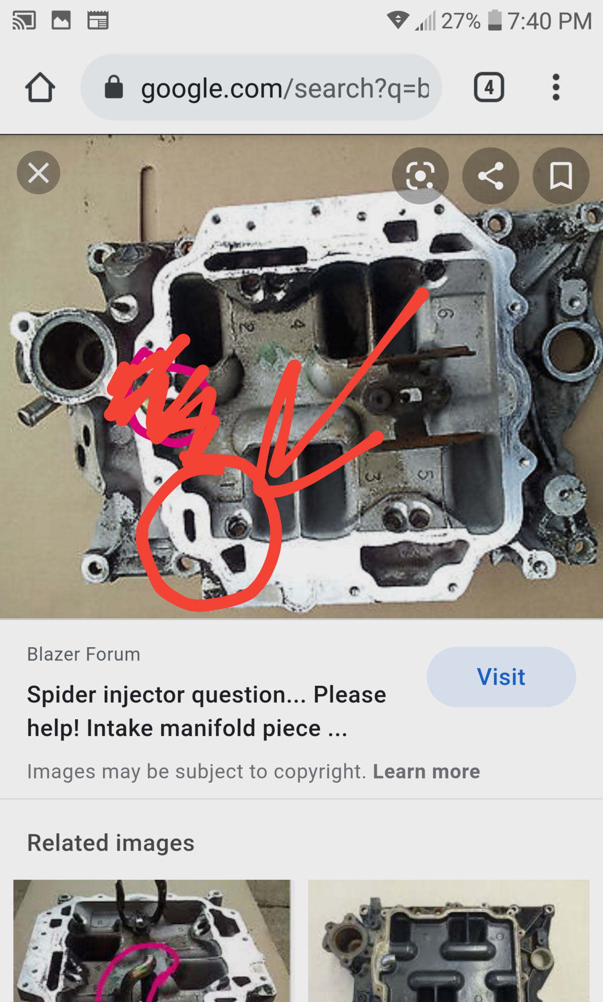

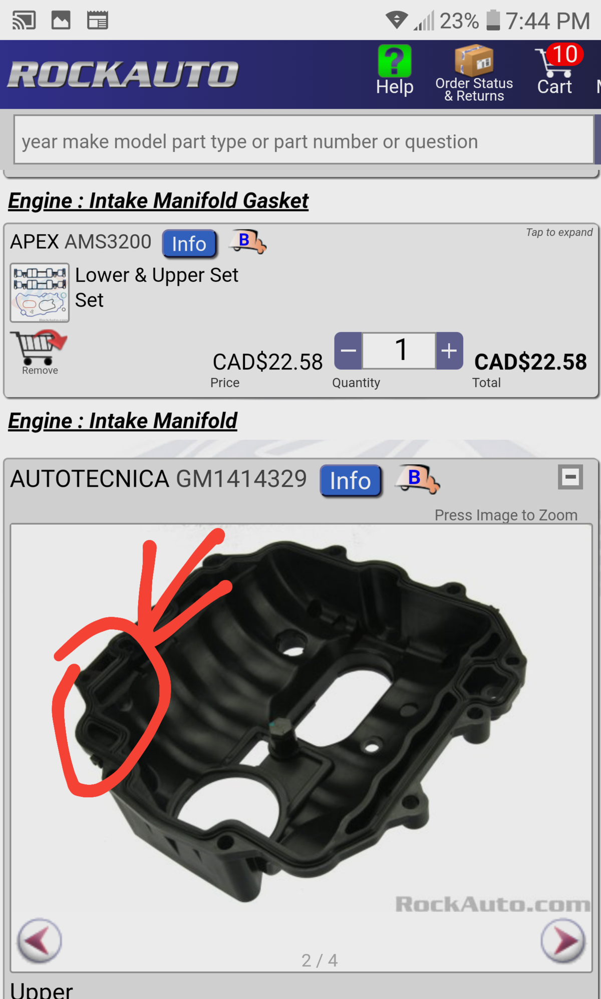

I attached a picture of where I have coolant pooling up from. Anyone know what the issue is? I though maybe cracked upper or a bad gasket

This is what would be underneath that pool of coolant

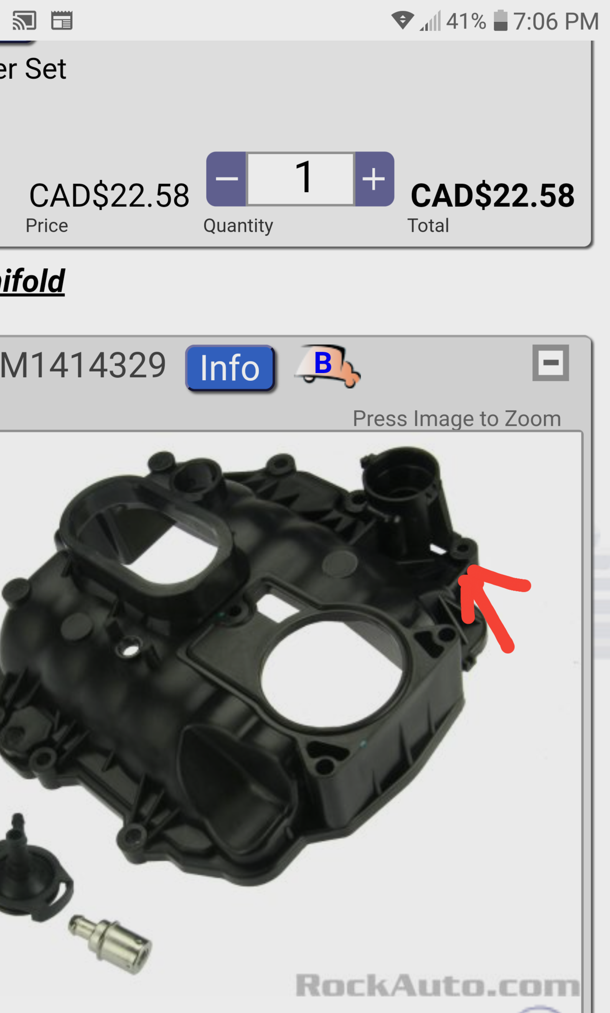

And this is underneath where the leak is which makes me thing I have a cracked plenum

you have a coolant leak from your upper radiator hose. it sits right ontop of that area. alternatively, it could be the topside of the LIM gasket though they rarely leak upwards like that.
