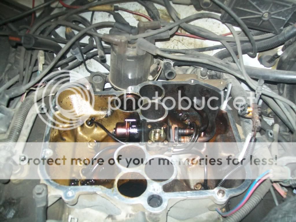

Looks like it needs a new spider to me.. again
http://i59.photobucket.com/albums/g3...r/100_1766.jpg
Old Mar 13, 2012 | 03:45 PM
Posts: 41,341
Looks like the 'nut kit' (internal fuel lines) were not replaced at the time of the previous repair which is a major no-no. The 'nut kit' should be replaced whenever it is disturbed, period. The lines are just nylon tubing heat shrunk around ****** plastic fittings and the movement required to separate them from the spider will cause them to leak.
While you are in there, replace the electrical connector to the maxi-injector in the spider to thwart another potential problem.

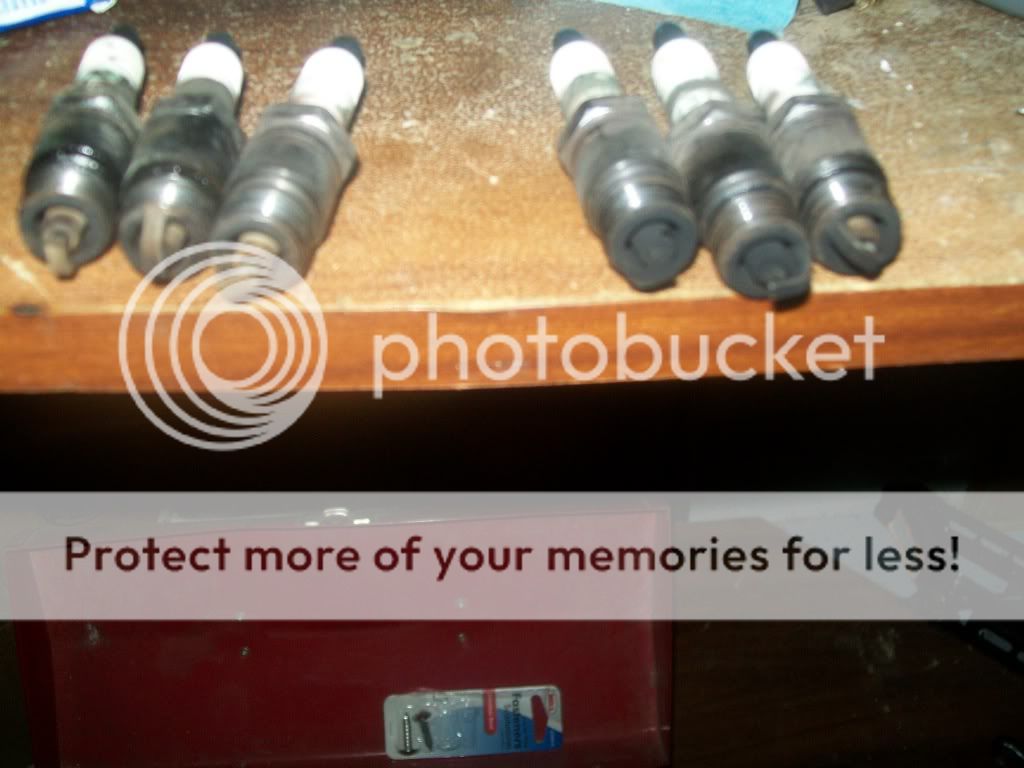

Will post pics of the plugs in a minute.
Any other suggestions would be very much appreciated!!

Plug pic, passenger side 3 on the left, drivers on right:
http://i59.photobucket.com/albums/g3...r/100_1775.jpg
Old Mar 14, 2012 | 08:35 AM
Posts: 41,341
In all of this, have you verified fuel pressure & leak down rate within spec (>55psi pressure with the pump on & above >50psi 10 minutes after pump shuts off)? If not, you need to do that.
The plugs are darker on the driver side due to the leak seeping around the nozzle lines in the LIM. The plugs likely could have been cleaned, gap checked, and reinstalled. What brand of plugs did you use? Hopefully AC Delco or NGK Double Plats as that is what these trucks prefer. Don't go cheap on the cap & rotor either as aftermarket ones can have worse problems than the original you are replacing.
